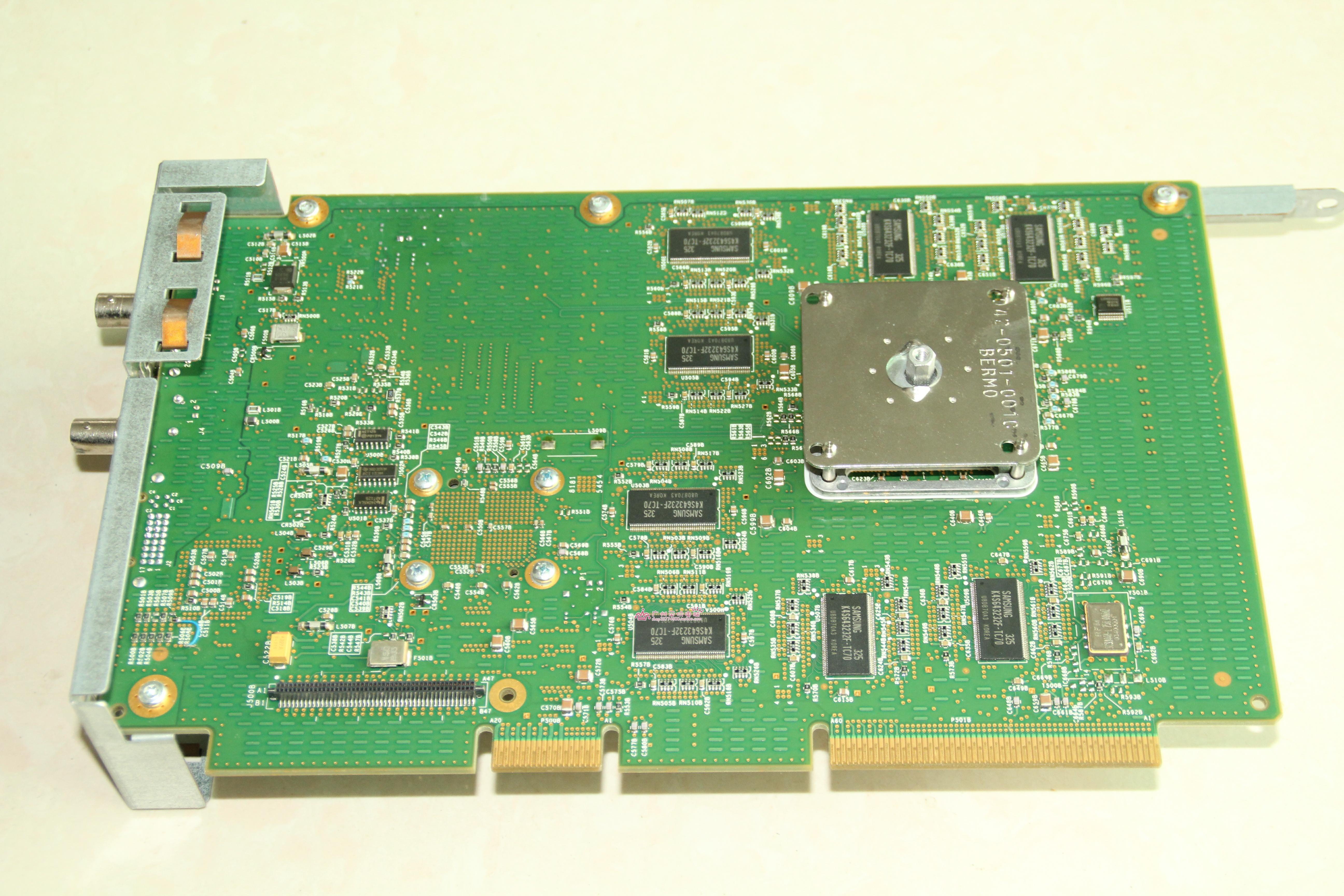

RE: Dead Rack V12 (?) - jan-jaap - 12-18-2023
ECC memory chips?
Here's the backside of a random V10. The memory is the array of Samsung K4S643232F-TC70 chips. Those are 2Mx32 capacity and there's another set on the other side of the PCB. Those are not socketed. While they can be replaced it requires skills and equipment. And without an indication of which one is faulty you'd have no choice but to replace all of them.
