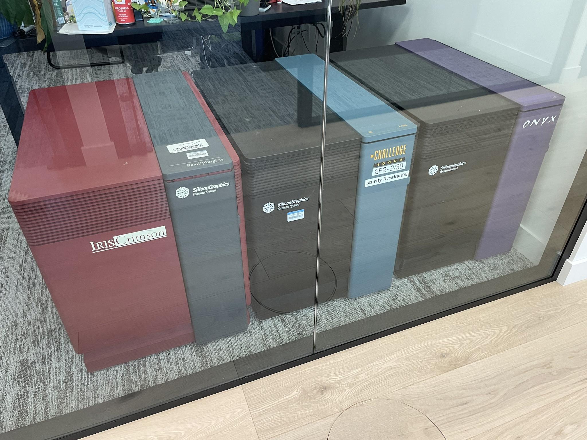

Looks like I might be downsizing offices and I'm not sure there will be room to keep these handy at the new spot.  So I figured I better get 'em running before I have to move them.
Two questions:
1) They ran fine last about 12 years ago.  I assume a visual inspection of caps is in order?  Anything else to worry about before power on?
2) Which one first? Smile
Crimson RE, Challenge L 6xR8K with Extreme Viz, or Onyx 4xR10k RE2

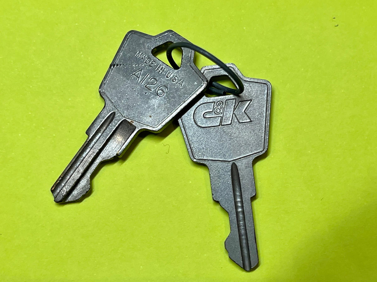

This is awkward though, I have misplaced the key for the Onyx and Challenge.  Does any know what model key it is or have a picture?  Maybe I can get the local locksmith to make one.  If anyone has spares, I'd be willing to buy one.

(10-01-2023, 05:11 PM)TriOx Wrote:  This is awkward though, I have misplaced the key for the Onyx and Challenge.  Does any know what model key it is or have a picture?  Maybe I can get the local locksmith to make one.  If anyone has spares, I'd be willing to buy one.
They are not proprietary and you should have no trouble finding another set. Just google for A126 keys, the originals are made by C&K and you can still buy them. Apparently they were also used in the no-longer used Dutch electronic voting machines Nervous
[Image: onyx_keys.jpg]

Hi jan-jaap, thanks a bunch! Wow crazy they used this key in voting machines! TBH I was tempted to go by the mall and see if there were any in the automatic door controls haha. Once I searched for your A126 code and saw they were used all over. But instead, I went to the locksmith in the mall and he cut me one from the code.
