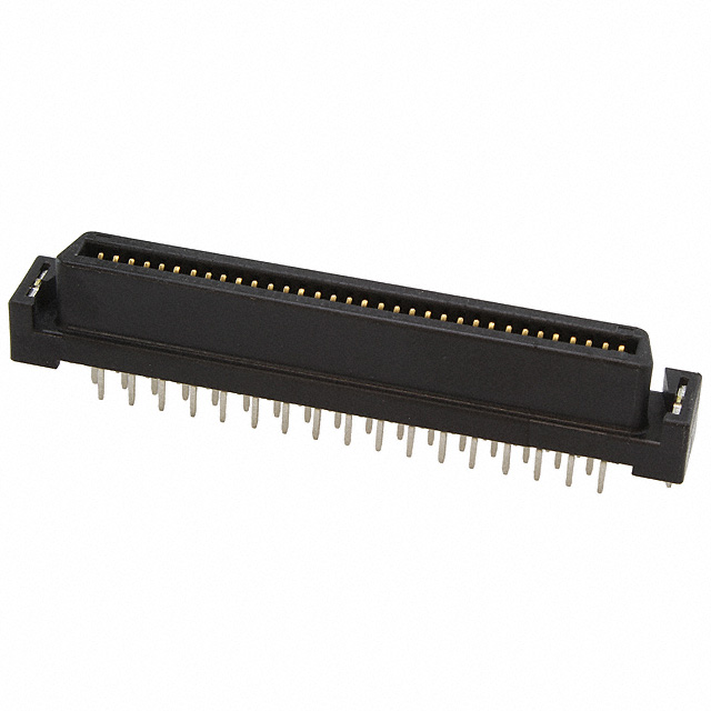

Big news!  I just received a part in the mail that I suspicioned would be fully compatible with the odd looking 68 pin SCSI connector that is present inside every SGI Fuel. My hunch was correct in that this connector has gone through a couple different vendors/manufacturers and while the same connector is not available that can be soldered onto the Fuel's existing PCB footprint (no SMD version left, it was retired too long ago) connectors to attach to the Fuel are available:

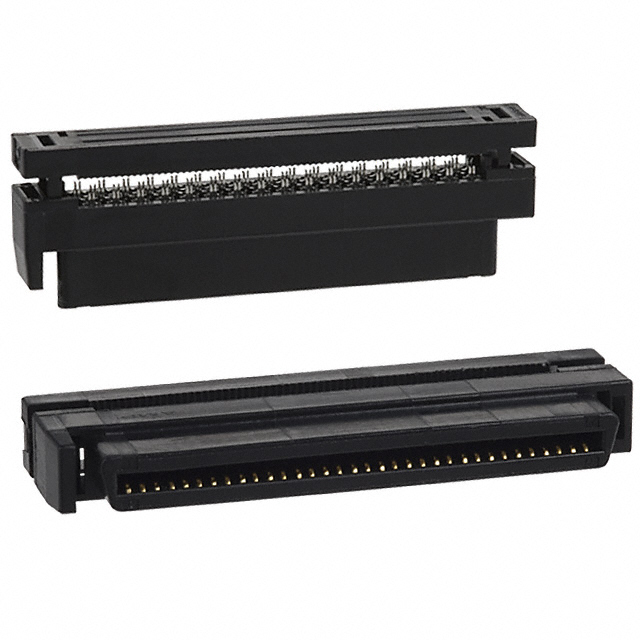

But I was able to locate an active IDC crimp version
And an active straight through-hole solder version.
I also found the right angle version but when I tested it, it points the wrong way. So the pins literally dig into the nearby PCI-X slot, so unfortunately while the right angle version would be much easier to put on a PCB, to some extent, it's not going to work because of the tolerances inside the Fuel.
There's at least 1,000 of each part available, as of the day I posted this, on Digikey.
I've just checked the solder version and it perfectly fits in the SCSI port. I did not buy the IDC version but it's of the exact same family. With this information someone can now create Fuel 68-pin SCSI adapter to standard LVD 68 pin SCSI connector. My problem is twofold. Number one I can't find the part for the standard 68 pin LVD SCSI connector, as odd as that sounds, sold anywhere in the US, I did find one in the UK (https://sg.element14.com/mh-connectors/3700-0200-15/socket-scsi2-pcb-straight-68way/dp/2373611).

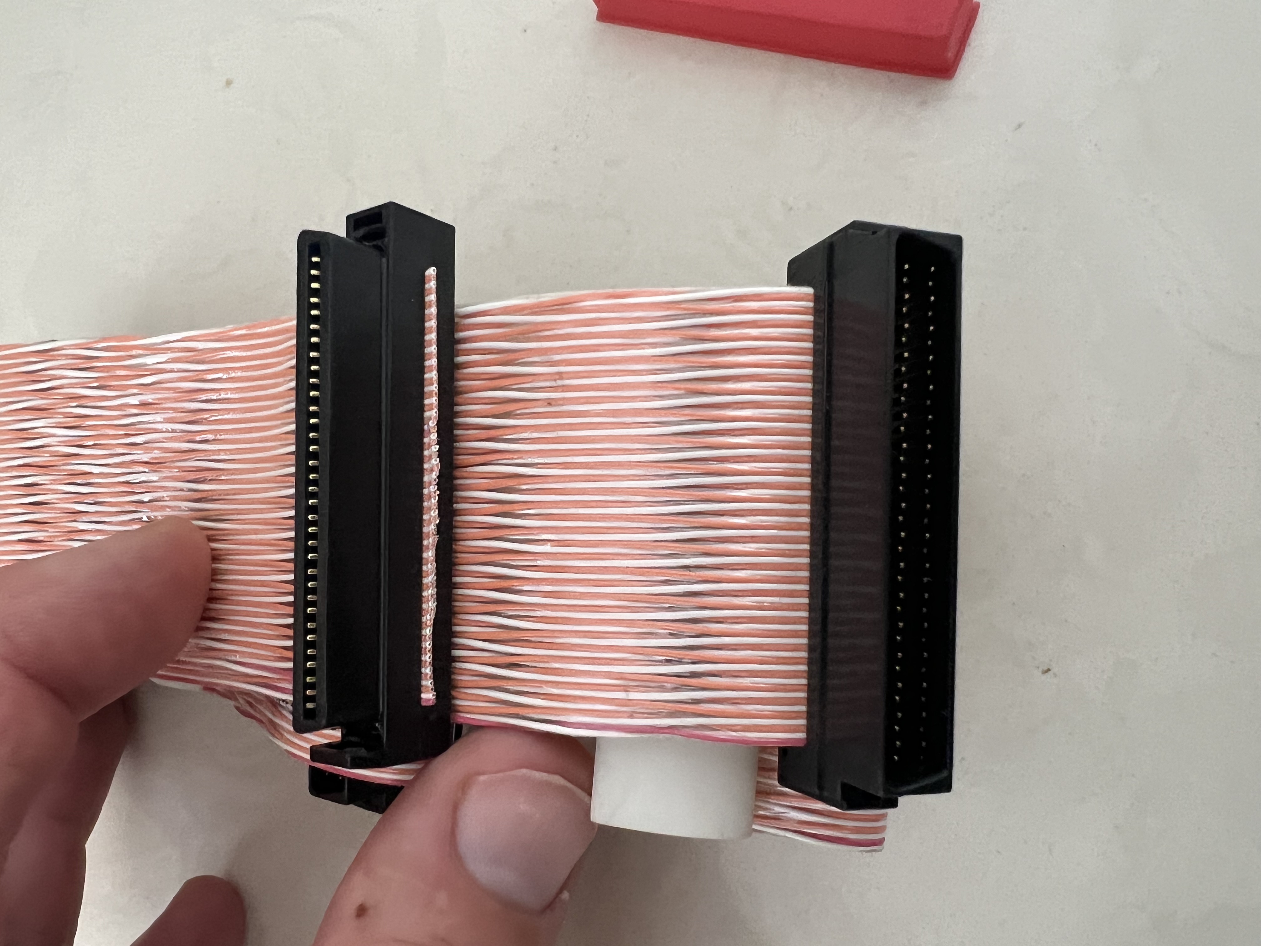

oh well, I am happy to present a one-of-a-kind brand new, SCSI cable for Fuel.
Freshly assembled by yours truly.
Now I need to find a reliable source of scsi cables :-)
