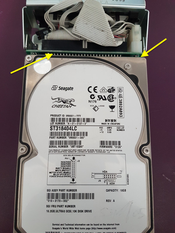

My initial thought is what we all fear...did you not put padding (cardboard) between the BACK of your SCA converter and the rear of the HDD? because if those solder joints coming out the back of your SCA converter touch the rear casing of your drive.......ouch.
Otherwise heat is caused by weak resistive connections. So I'd assume the connection between your female socket of your molex connector and the rear pin of the card's power connector wasn't flush, (in all the way), and was barely touching inside, causing Joule's law to take affect and create intense heat at the touch joint.

(08-24-2023, 06:46 AM)toncho11 Wrote:  What is this padding (cardboard) of the scsi converter?
There isn't natively any padding, I asked if you ADDED padding because often in SGIs (example is an Indigo2 sled in picture below).  Without any protection you have this:
Look at the arrows in this picture.  There isn't ANYTHING to prevent the backside (bare solder joints) of the adapter from touching the metal drive casing...for both part of the power connector and the SCSI signaling pins. Because this situation is dangerous, unless some insulated padding is placed between the  board and drive casing...you can easily bend the plugged in adapter enough to touch the drive with those silverly, sharp, solder joints on the rear of the card.  In a tight situation like an Indy...you can do something like this!
Did the two bare parts touch when powered on?  This touching (where the yellow arrows are) could lead to damage/fire/melting/bad stuff.

Actually you are right!!! It could be the source of the problem where 5V touched grounded surface. I am thinking what kind of padding should I use.
RE: Burning power cable for HDD - weblacky - 08-24-2023
Cardboard from like a cereal box, multiple layers, normally works okay. As long as those solder joints cannot poke through. Also you'll need to steal a replacement molex power connector for your cable (pins slips out). Just try to replace as much if the damaged parts as possible as they wont make a good connection anymore. Be safe.
