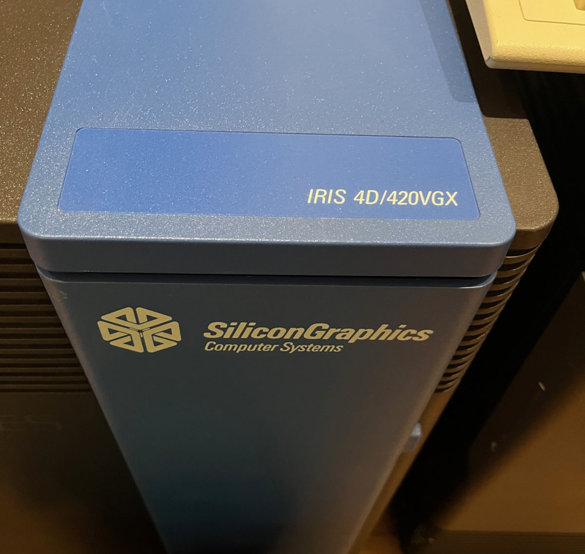

I happen to have a real 4D/420VGX in a single tower chassis, though I installed a second CPU board so now it's technically a 4D/440VGX. Systems with VGX graphics have blue top hats:
[Image: 4D420.jpg]

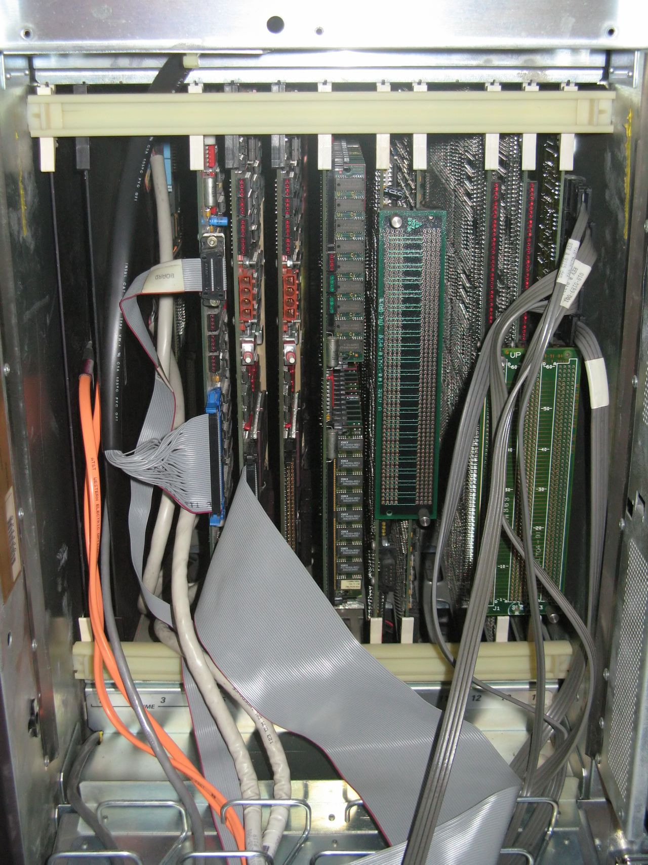

This is what's inside. The IP15 boards are roughly in the middle, with the black handles. If this would have been a 'factory' 4D/440 it probably also would have had a flat cable from the second CPU board to the bulkheads to connect extra serial ports.
[Image: IMG_0006.jpg]
Otherwise, this system has (on the left) two VME option cards: an FDDI board and a SCSI card (narrow high voltage differential, never found anything that could attach to it). This one also has dual raster managers (right hand side, with the row of LEDs) which makes it a 10-span VGX.
Oh, fun fact: I have the original invoice for this system. I think it was well over 200.000DM, after discounts, with a single IP15 board, a single RM and 'only' 24MB RAM (still a lot in 1991, but now it has 256MB). I think the RAM alone cost 1000DM per MB.
I think this is one of my coolest SGI systems. I rebuilt the PSU a couple of years ago, but otherwise it never gave me any problems and it still works fine, despite being > 30 years old.
