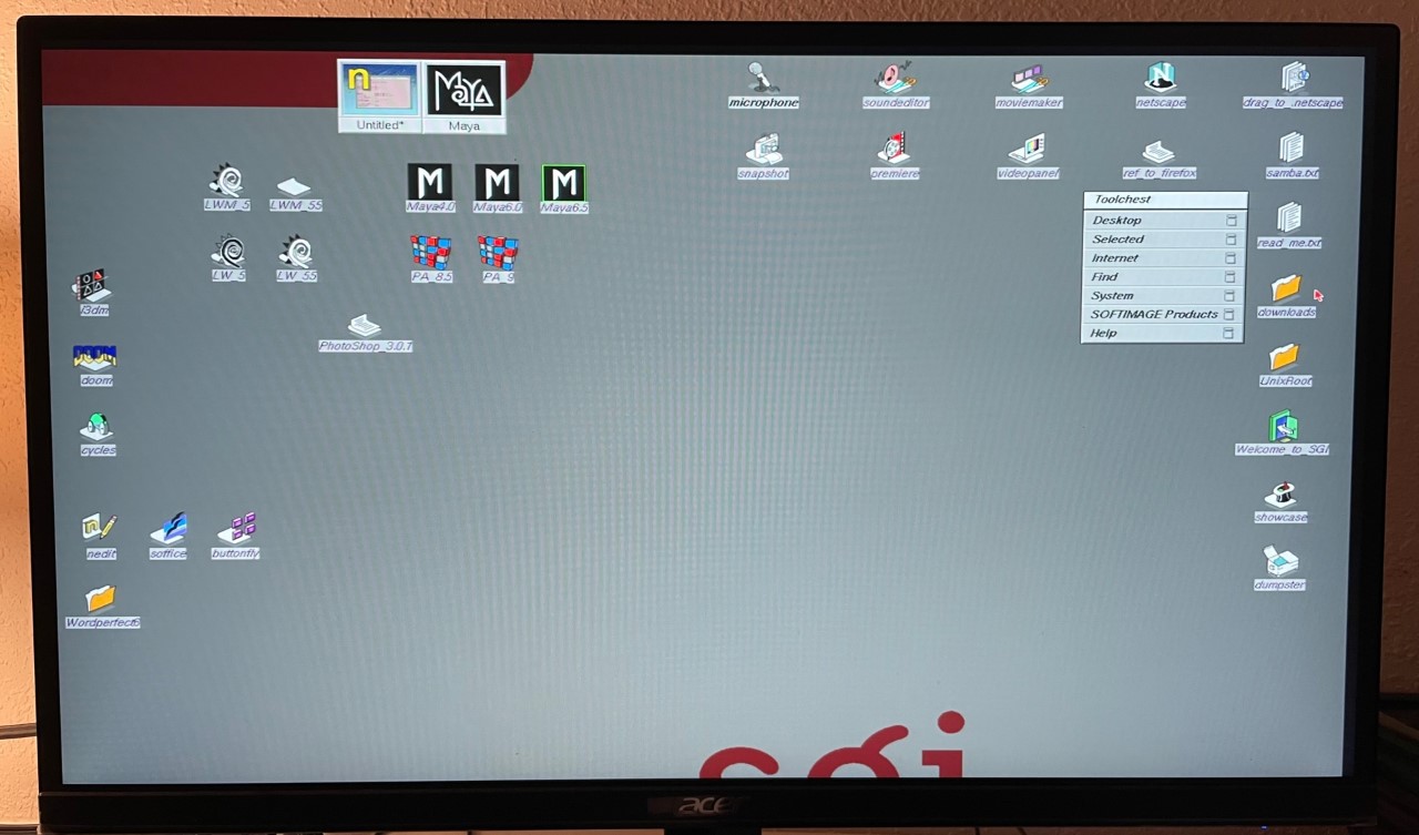

Well, the Octane fired up and worked right away after I received my 13w3 to VGA converter.
A new HDMI/VGA monitor ended up working really well with the SGI to my surprise.
I couldn't find my keyboard and mouse, originals for SGI, but I did have a spare older ps2 mouse and keyboard I used with another 2006 era Xp64 system.
These do seem to work overall but I noticed that the Caps Lock key seems to be stuck in the ON position and this makes it all caps as I type and also seems to nullify
my use of the Alt/Shift keys as I can not navigate 3d views in Power Animator or Maya at the moment.
