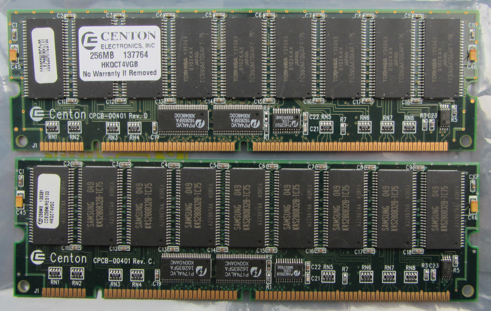

I don't remember where these two originally came from, but they did work in my PWS 500au and it survived both kernel boot (Linux 6.x) and operation (7za b -md=2m, openssl speed -elapsed) with them installed:
[Image: pws-500au-compatible-centon-dimms.jpg]
Those are CENTON CCB256M/REG133, though not identical modules (different PCB revision and different SDRAM chips). Unfortunately I couldn't find anything about them on the WWW, neither could I read out their SPD EEPROM for their timings from the PWS nor from a DL380 G2 and I think I don't have any other systems that can use those DIMMs, except maybe my Blade 100. But I doubt I can read the EEPROM there with Linux. So yeah, those are buffered ECC PC133 modules with 256 MiB each and they worked for me.

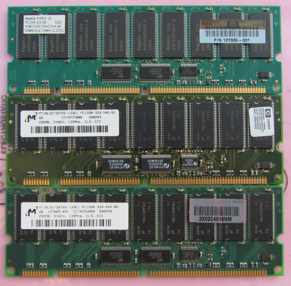

In addition I did pull two from each of the following buffered PC133 256 MiB DIMMs out of another DL380 G2 and all of them worked, too, i.e. same as above: kernel boot OK and operation OK with all of them installed (first pair in DIMM slots J1, J2 (bottom ones, see the DIGITAL Personal Workstation 433a Upgrade Guide (EK–ALMIA–KU. A01) pages 14 and 15 for details) and so forth):
[Image: pws-500au-compatible-hp-compaq-dimms.jpg]
The top and bottom ones have a HP/COMPAQ part number 127005-031 and are:
* top: hynix HYM71V32C735HCT4-H PC133R-333-542
* bottom: Micron MT18LSDT3272G-133E1 PC133R-333-542-B2
The middle one is actually also a Micron MT18LSDT3272G-133E1, though with PC133R-333-542-B1 instead. It has a HP label attached with (specification?) D8266A.

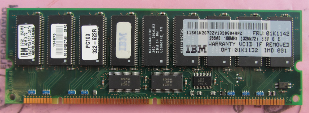

I also found another compatible DIMM type when disassembling one of my IBM B50s. Those are buffered PC100 256 MiB DIMMs from IBM which work the same way as the six modules above and also together with four of those six modules above. They are stacked DIMMs, so actually have twice the amount of SDRAM chips on both sides:
[Image: pws-500au-compatible-ibm-dimms.jpg]
IBM FRU number is 01K1142 labelled PC100 322-622R
As written above I didn't use all or most of the memory when testing with 7z. But I might give that a try when I find the time.
Apart from that all these DIMMs worked much more stable than anything else I tested, except for the non-buffered ECC modules that did equally well and which were installed prior to these ones.

RE: Personal Workstation 500au memory compatibility? - johnnym - 06-24-2023
So, I had another go at this and got new information:
Though the six 256 MiB PC133 registered/buffered ECC modules (two of each of the Compaq/HP related modules from the last post) I had installed in my PWS 500au work through POST, OS boot and "light" testing (i.e. 7za b -md=2m), they unfortunately seem to fail when using more memory (i.e. bigger dictionaries) during 7za b runs. When this happens, the system freezes and becomes unresponsive.
This also happens when testing them separately (meaning two identical modules) in SRM with the memtest tool (see the SRM console reference, page 97 and following for details and usage), which hence might be a good and quick way to determine any "good" modules for a PWS.
So these three (or two when considering the part number or specification) module types are no good for the PWS.
The IBM and CENTON ones though do work in SRM's memtest and also work during 7za b runs unless you hit a situation where the Linux kernel (6.3.x) is not able to handle a paging request.
