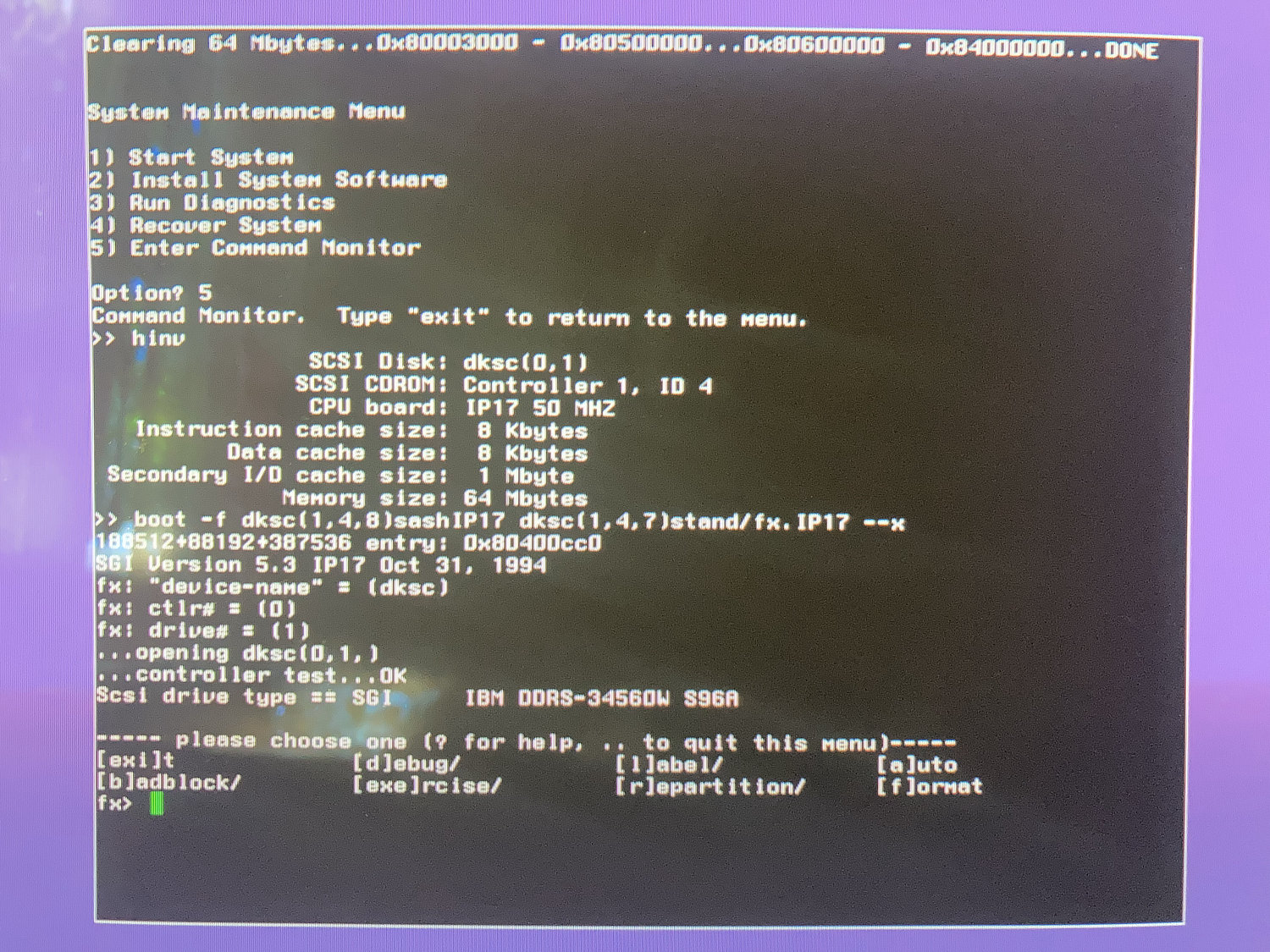

So Crimson's 50-pin-scsi-disk died on me (one of IBM deathstars). I put an 18GB Quantum SCA 80pin drive into the machine via adapter and got massive, not disk-associated errors trying to invoke fx. First I thought there were problems with the external SCSI-CROM. Then I downgraded to a 4gb Disk SCA-disk, with then having no errors.
Are the older machines somehow limited for disk-size?
And here for later reference:
boot -f dksc(X,Y,8)sashIP17 dksc(X,Y,7)stand/fx.IP17 --x
this was the only variation that worked for me using an original 5.3 media ....

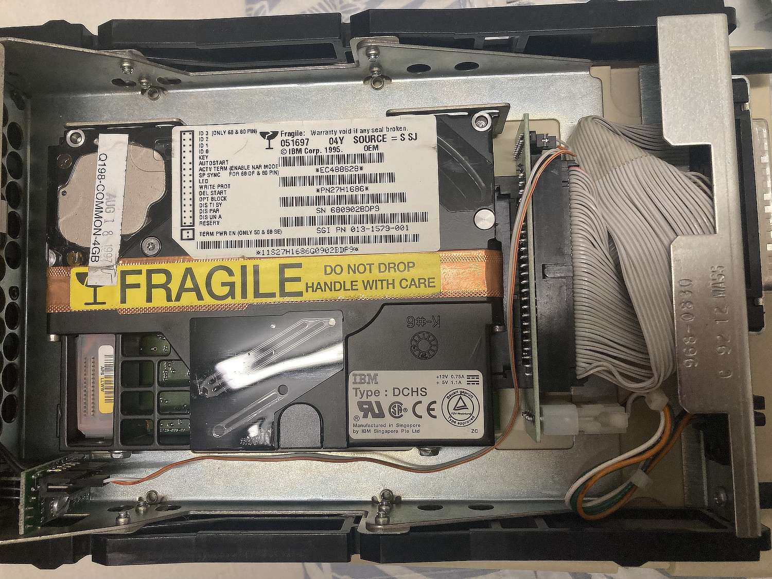

RE: Crimson Harddisk Installation woes - Geoman - 09-06-2022
Yes - that seems to be the problem: the adapter tested good on Indy and Indigo2 - but it produces errors in Crimson. I‘m going to try an ancient 4gb 80pin SCA Drive later this evening in Crimson, the newer 4gb IBM+Adapter gives me a “no room in volume header for sash” error during install.
Yes, a DCHS works. A newer DDRS-34560 produces errors. So it is not only the adapter, but also interface of the harddisk.

This Harddrive was originally shipped with an Octane/SI, which I have upgraded to SI-T and newer Harddisk.
This IBM-HDD is running quite silent, and has a scorpion-logo on its PCB on the back. I find therse quite robust in comparison to the later models. There are many 68 and 80pin variants on ebay, which appareantly work with older SGI machines like Crimson with the cheap chinese SCA-to-50PIN adapters.
