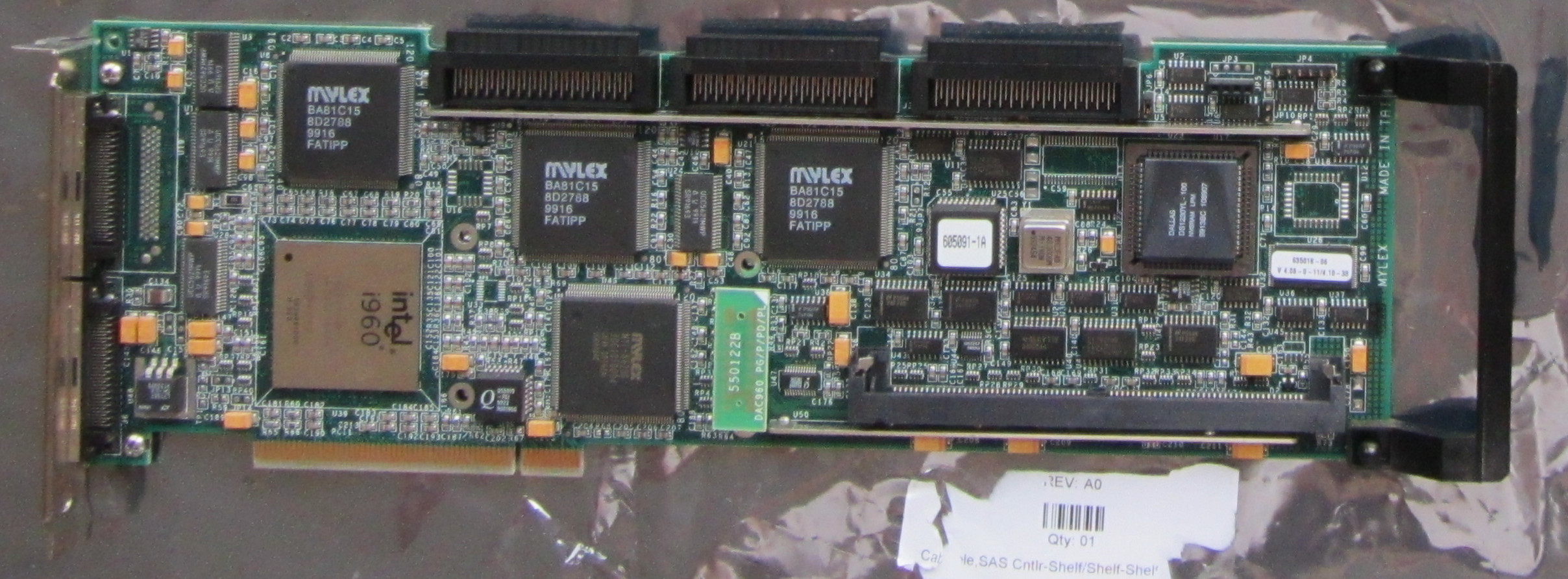

Mylex DAC960PJ
[Image: mylex-dac960pj.jpg]
This one has three Ultra-Wide-SCSI controllers (so 40 MB/s per channel) onboard and the faster i960RD with 66 MHz. It's currently missing its memory module, but I should still have it somewhere. Don't know why I didn't leave it in the controller.  Angry Most likely because it was a bigger sized module (either 32 or 64 MiB).
Depending on the firmware level - which I don't know - this one has the RAID configuration tool included in its BIOS or not. If not you need to use a DOS startup disk with the respective tool (DACCF) on it IIRC.

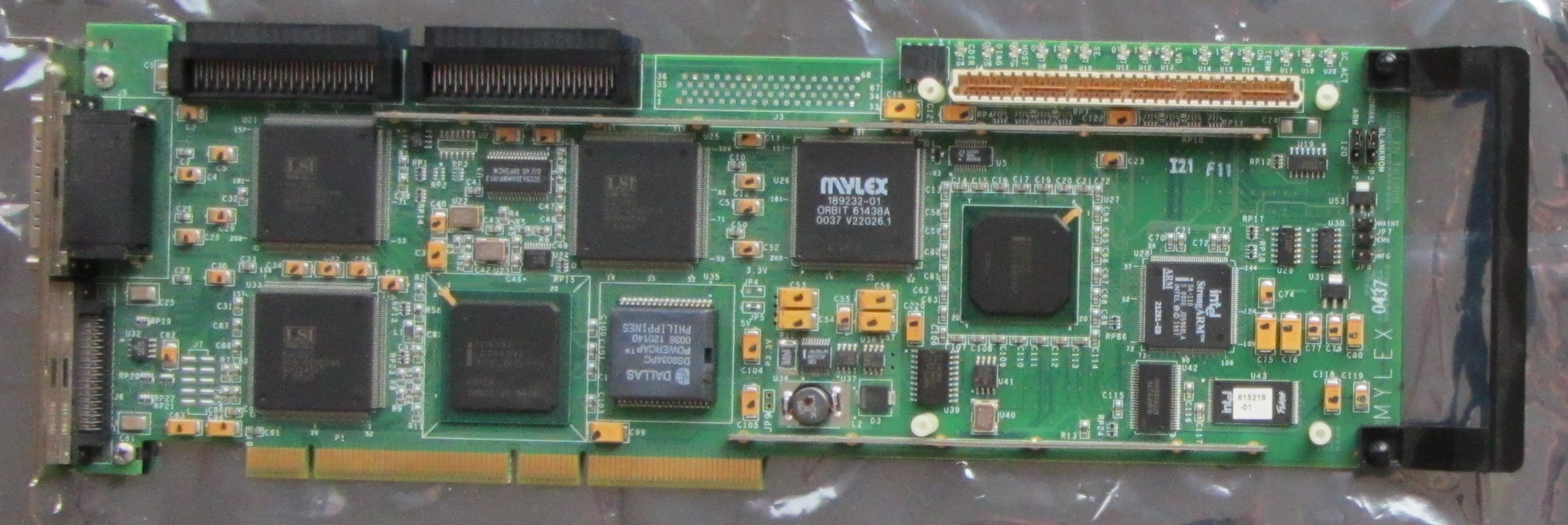

Mylex eXtremeRAID 1100
[Image: mylex-extremeraid-1100.jpg]
This one has three Ultra2-Wide-SCSI controllers (so 80 MB/s per channel) (3 external connectors and 2 internal connectors) onboard and according to this post with 160 MHz StrongARM. It's currently missing its memory module, but I believe I still have a few of those somewhere...
The RAID confguration tool is included in the BIOS for this one.
I also have exactly one of these controllers with 3 internal connectors and two external connectors, but want to keep that one, just in case I want to revive my Primergy 560 plus disk array setup. Sorry.

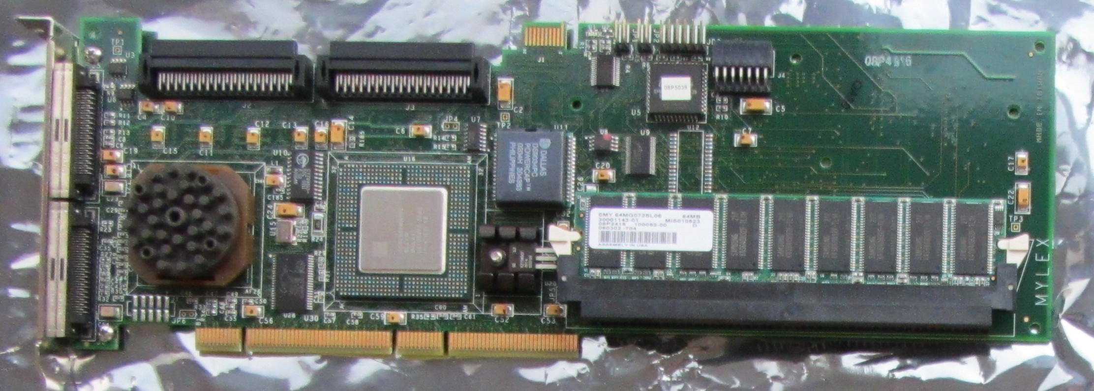

Mylex AcceleRAID 352
[Image: mylex-acceleraid-352.jpg]
This one has two Ultra160-SCSI channels from a single controller and a i960RN running at 100 MHz. This one still has its memory module (64 MiB in size, ECC SDRAM).

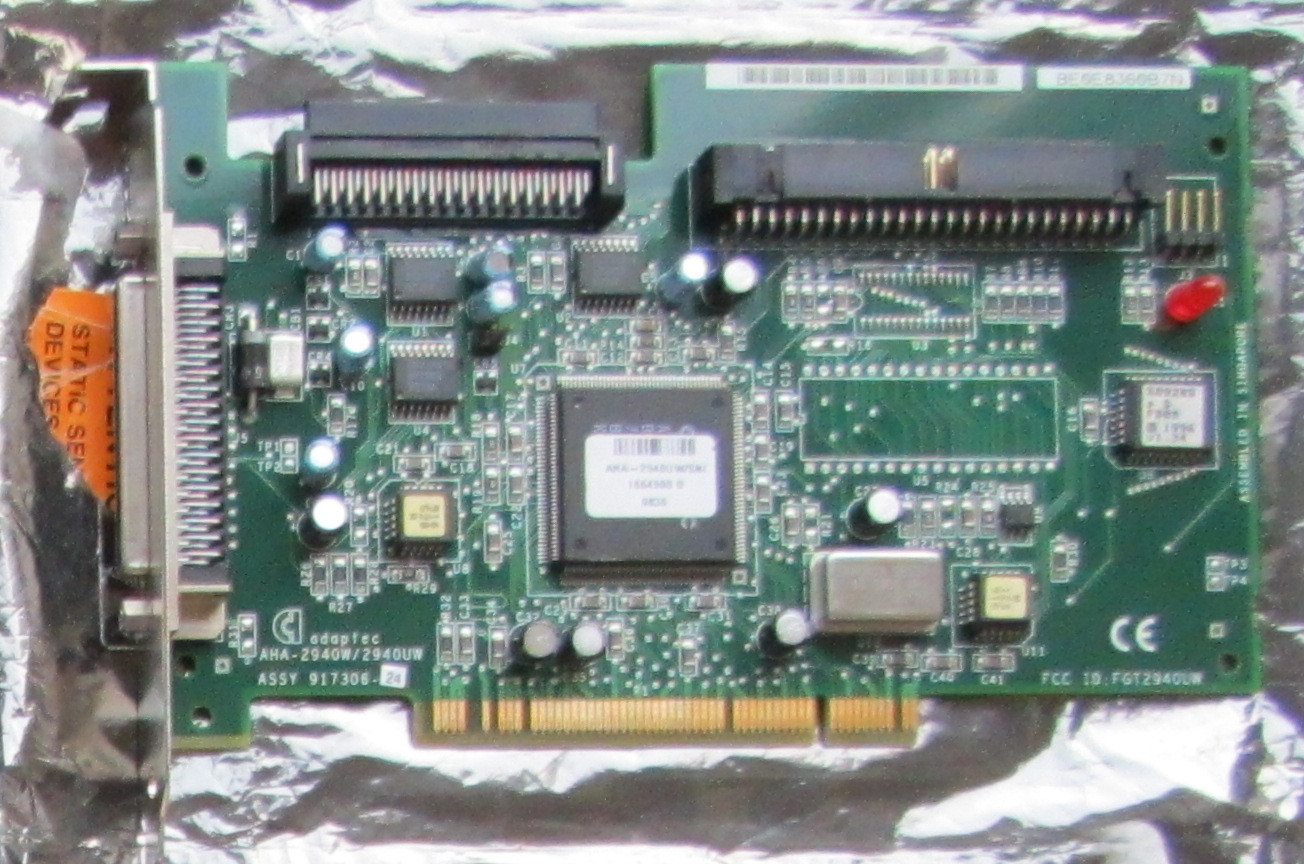

Adaptec 2940UW
[Image: adaptec-2940uw.jpg]
This is the non-Pro version w/o bridge chip between 68 pin and 50 pin connectors. Has its own BIOS, so supports booting from disk and disc drives.
Unfortunately the PCI64 cards won't fit in your single CPU PPRO motherboard (the PCI slots there are missing the notches), so depending on where you want to use it, you are limited to the DAC960PJ and Adaptec 2940UW.
