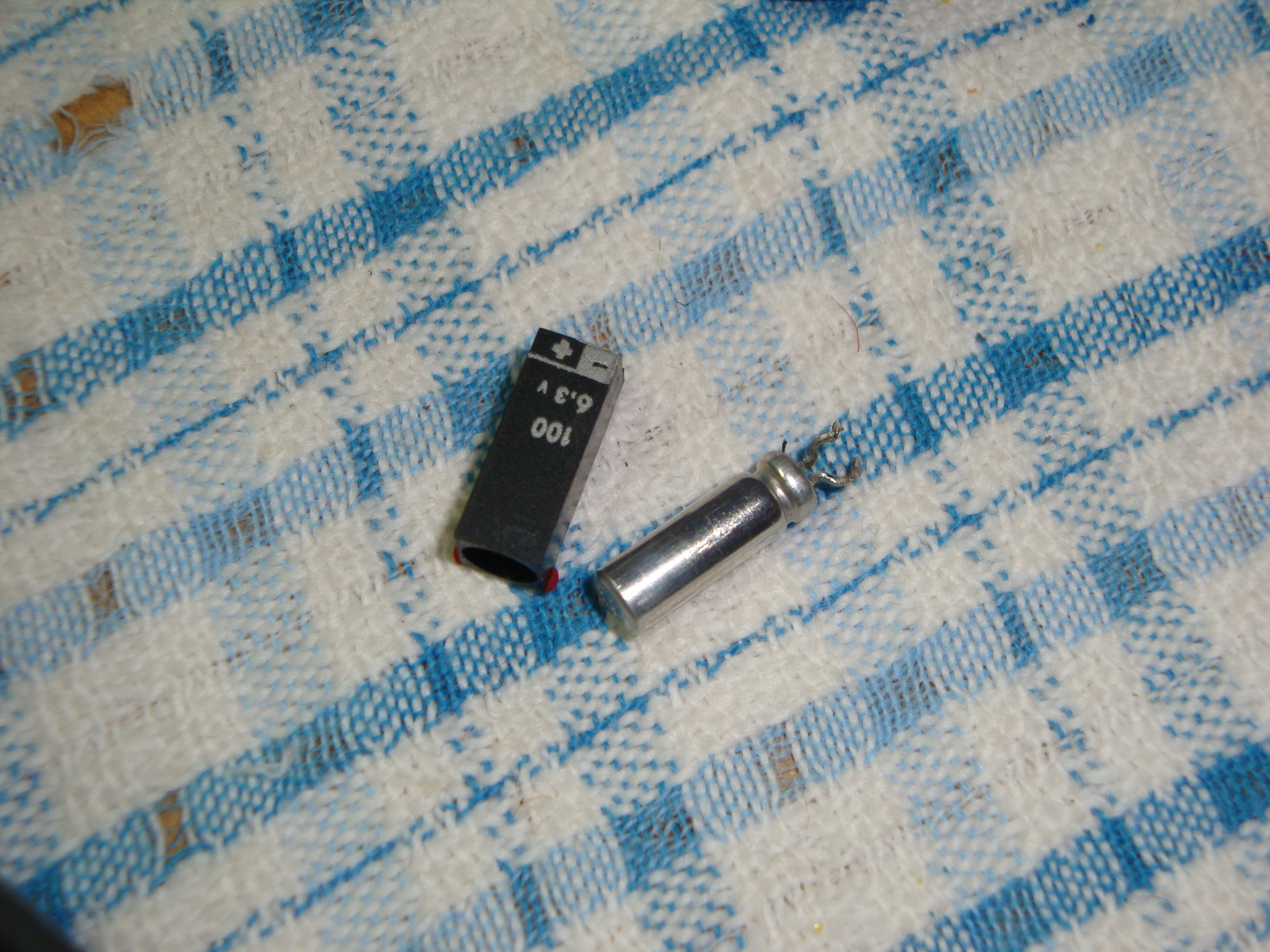

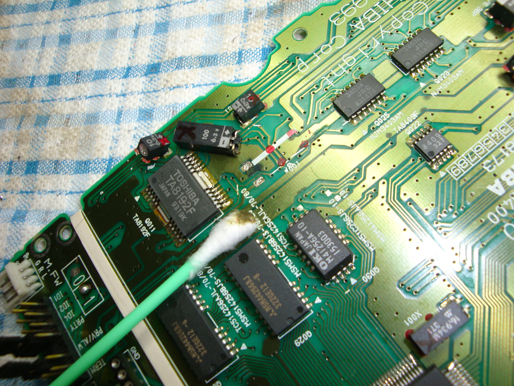

a heads-up for anyone still using one of these old dinosaur CDROM drives in/with their SGIs. I have two XM-3401s in my Crimson and PowerSeries, ca. '93 and '95 production, and the earlier one no longer reads discs. I noticed acrid smelling electrolyte on the PCB near the connectors, with a TTL and SMD cap nearby. Popping open the cast (!) lid revealed further leaked electrolyte on the PCB with the onset of corrosion!
The major culprits are a bunch of 10µF and 100µF 6.3V SMD caps in an unusual thin can package mounted on its side in a rectangular plastic case (see piccies). Desoldering these things released a stench so intense, I had to open a window and leave the basement. I'm now considering replacing these with 5mm diameter TTL caps, also on their side.

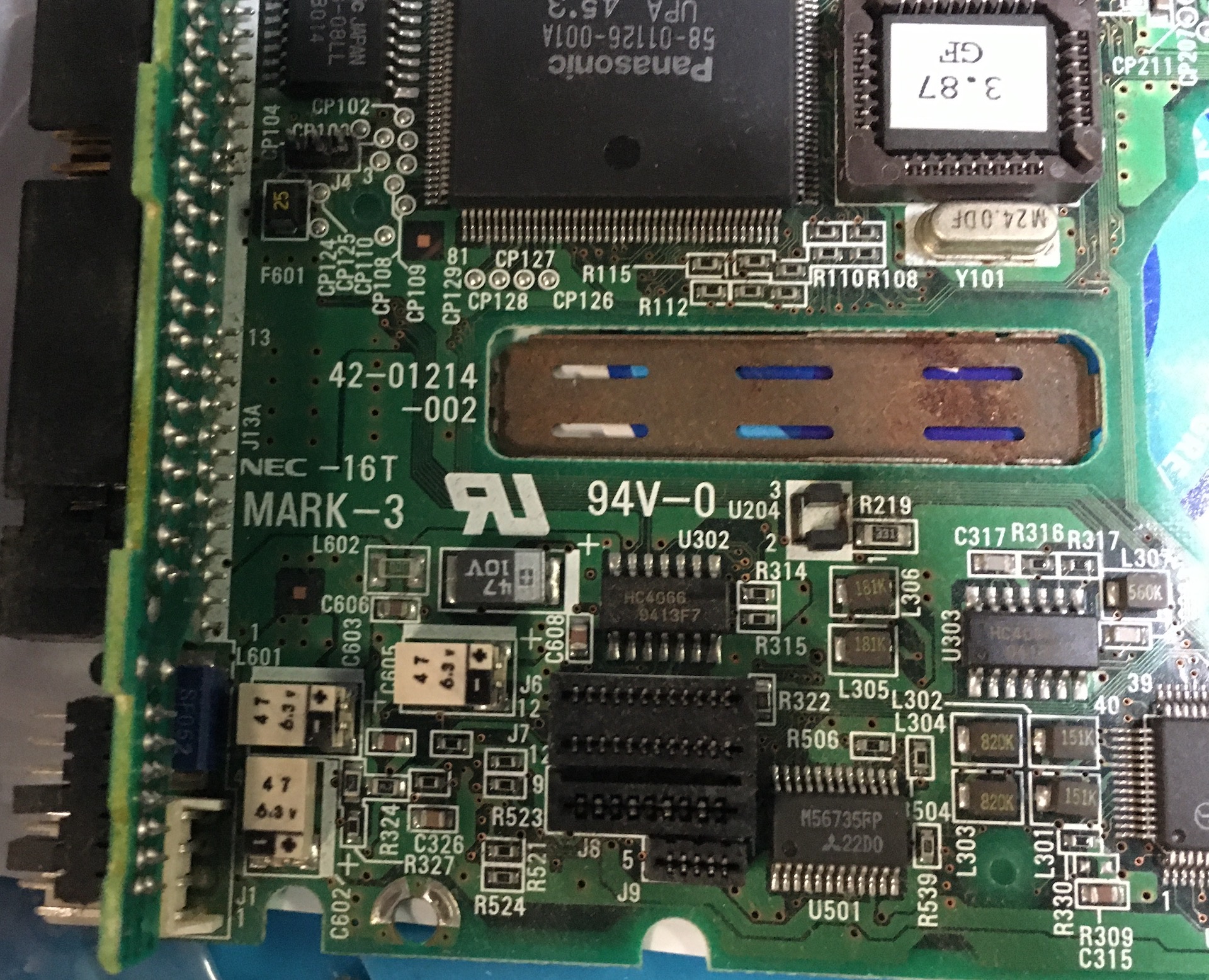

Thanks for the alert and pictures of the offenders. A cursory look might misidentify them as tantalum; the "+ –" polarity mark is also strange.
RE: Toshiba XM-3401 CDROM leaky caps - weblacky - 08-28-2022
I've seen caps like these in Insite flopticals and yeah... the form factor was retired YEARS AGO, so the pads are never right for a new cap, best you can do is loop the legs of a cap (think upside-down santa's sleigh) and solder them down. They are simply plastic containers with normal radial caps on their sides. Just dumb.

Yeah, at first I thought those were tantalums too. And there's another part on the PCB with exactly the same form factor, also containing a "metal can", but turns out to be a crystal. The label gives you a hint.

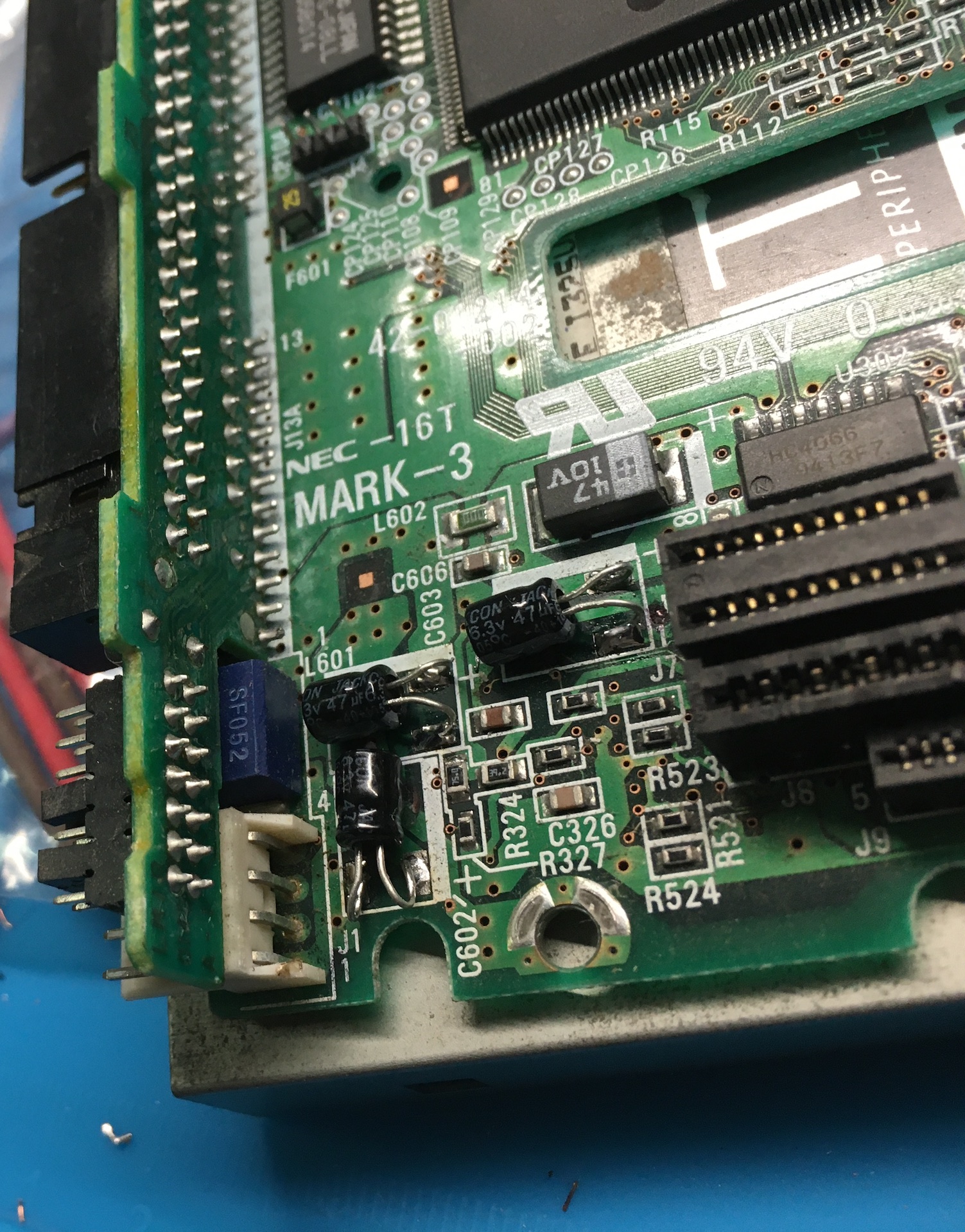

Not to hijack.  Here's the BEFORE and AFTER of the board from an Insite Floptical (repair didn't solve issue, unfortunately).  Same caps and my method to install NEW caps with a standard radial can, they do fit perfectly in both length and height as the board goes UNDER another metal structure so they had to fit.  This demonstrates my upside down sled technique.
BEFORE
AFTER

That board's actually denser than on the XM-3401. I couldn't bend the leads back as you did with some of the replacement caps as I had to keep them short so the caps wouldn't protrude into a cutout for the CD spindle motor. As in the floptical, there's not much headroom between the PCB and the mech, but the 4x7mm 10µF's were a pretty good fit. Dropped them in and the drive works again.
But... Achtung, Baby! There are two bipolar (!) SMD caps on the PCB. Lacking viable replacements (and space for two back-to-back polarised electrolytics), I left the originals. They still measure ok, but the capacitance is a bit on the low side (<9µF). I expect these aren't stressed as much as the polarised caps. Should replace them at some point, probably with SMD bipolars again.
