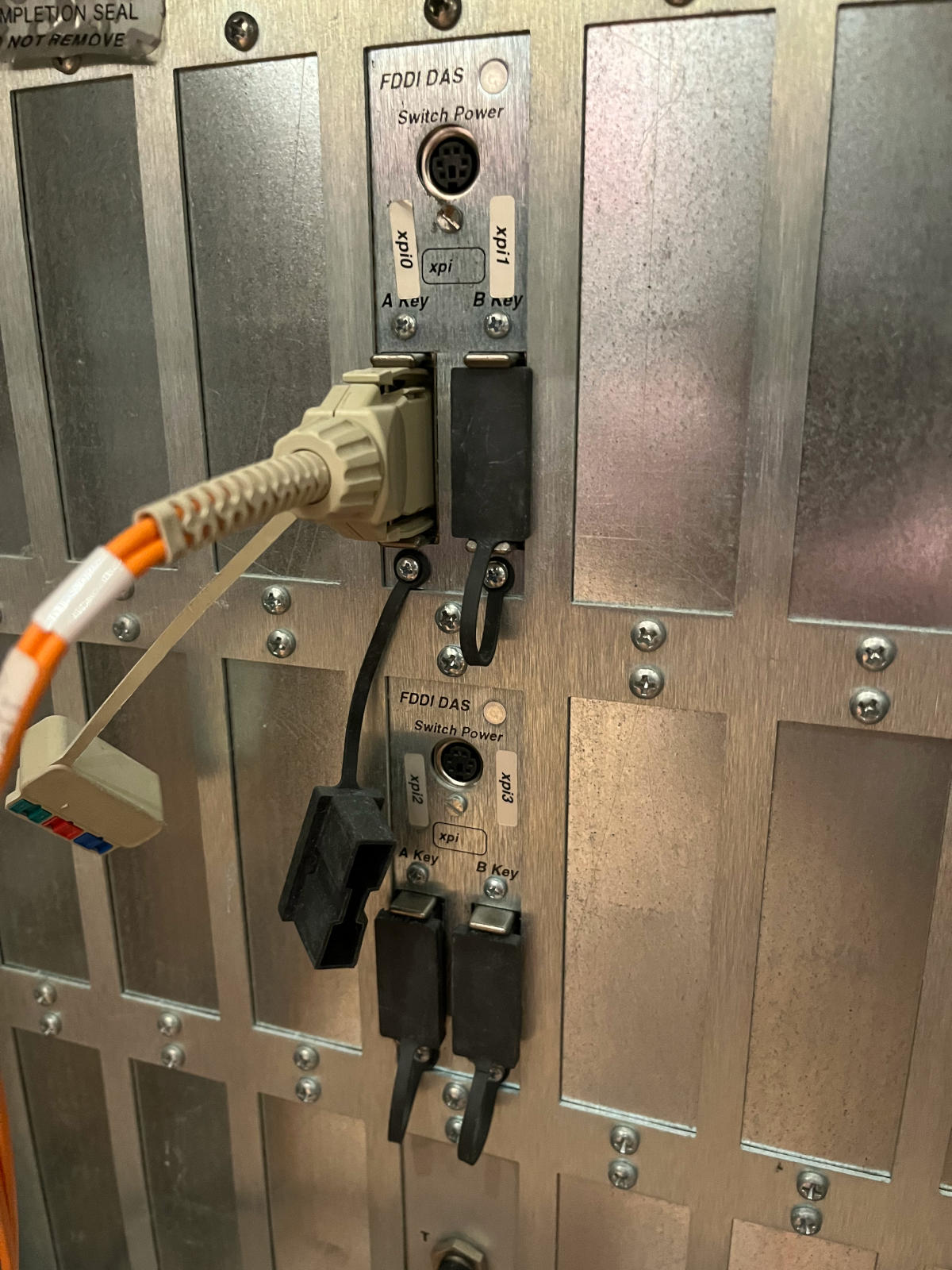

UPDATE: I managed to get a bulkhead plate put together with some 3D printing, some SC-SC connectors, and some SC fiber patch cables.
[Image: 14D7CD56-EC19-43F7-A2CC-7F39E4529A53.jpeg?m=1651113556]
[Image: 36AE229B-84E1-4B3F-B930-80226CA5BB54.jpeg?m=1651114385]
[Image: 0FAAA9E5-1A8F-4523-8979-F85B97DAF085.jpeg?m=1651114415]
[Image: A460C25A-7A93-4606-BDAA-DC34206E64E0.jpeg?m=1651114445]
Next up: Figuring out how to connect this to my network/creating a network.
