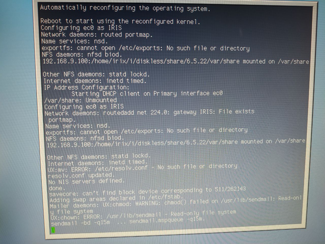

RE: Option to boot IRIX from network - Docter60 - 03-21-2022
Okay firstly, thank you Raion for your reply, any and all info on the matter is much appreciated!  After a weekend of brainstorming, troubleshooting, and testing, I have a raspberry pi that can both net install IRIX and net boot IRIX to the Octane.  I don't exactly know how stable it is yet for long sessions, but I can at least bring myself to the root's desktop and shut down properly.
My setup procedure is the following (briefly):  The Octane is set up as a mock diskless server where the dskless_server subsystem is installed along with all the /var/boot programs.  The pi provides an NFS directory where the diskless tree will be installed to.  After mounting the nfs directory on the Octane, I go through the processes described in the diskless guide to create a share tree and client tree catered for the Octane.  After installation, I took note of how the Octane's local configuration files for exports, hosts, bootparams, and inetd.conf were changed.  I also had to check the client tree's /etc/hosts because the Octane put 127.0.1.1 instead of the LAN IP.  Rebooting and changing the PROM variables resulted in a lot of trouble, but lots of reconfiguring eventually got it working.
Right now I'm using nfs-kernel-server with NFS2 and 3 enabled only. I had a problem where bootparamd was sending back resolved IP addresses from the pi's /etc/hosts instead of the hostname (this, again, sent 127.0.1.1 instead of the LAN IP), so I just used the IP address in the bootparams configuration file.
Currently I feel that the setup is in a "proof of concept" state, meaning it is messy but attainable. So I'll be continuing to polish and test more in the near future.  I also just revived an Indy, so that will be another machine to test on.

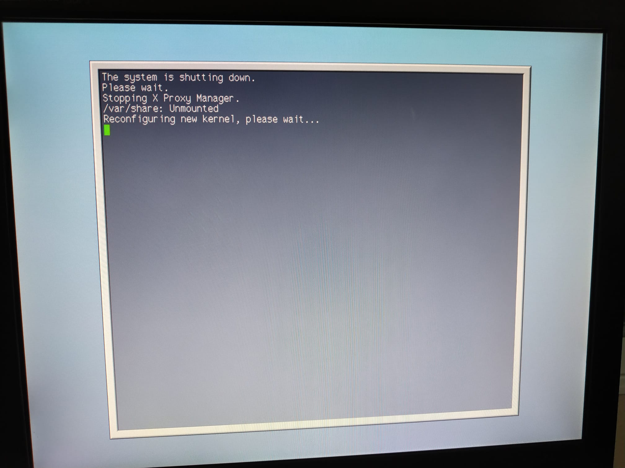

RE: Option to boot IRIX from network - Linux-RISC - 04-22-2022
Thank you, Docter60. I'm working to add this functionality to Reanimator and I'm using your documentation to polish some configurations.
I have booted my Indy on network using a RBPi+Reanimator as NAS and I have some remarks/questions:
- I have used my Octane2 as server, like you, to generate share and client directories
- I prefer to generate the installation on the local disk and to use tar to backup and transfer to RBPi using scp, the generation over network is still slower
- Using a SD card on RBPi is very slow, and the SD card loses write cycles
- I'm working on booting Indy using bootp on RBPi but moving the storage to a NAS (a GNU/Linux thin client) to increase the general speed

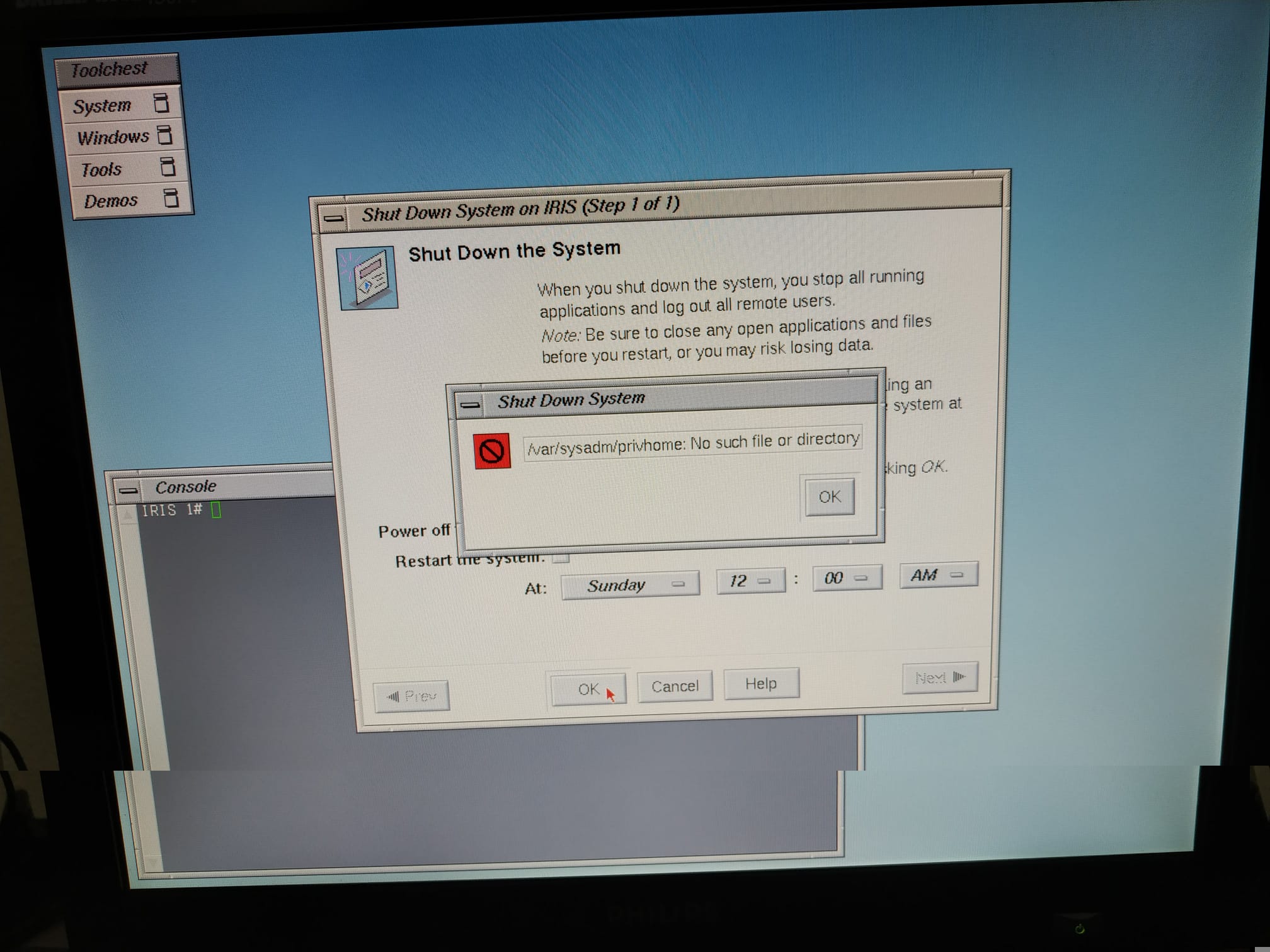

Questions:
- Indy booted showing a simple window manager and I couldn't shut it down, a missing file error is displayed and I shutdown executing "shutdown -g0 -p -y", have you experimented the same problems?

Oh, replies. I don't check back here often, apologies.
For the first question, can't say I have had that exact problem. The first solution I attempted was actually what you described (local tree generation then transferring)!  Tar-ing everything kind of screwed up the files somehow for me...so that might be what's happening.
As for the second question, yeah they kind of are useless.  They're only useful if you plan on creating network classes for your machines.  Those lines are essentially just pasted over from the bootparams file generated by the mock server.
