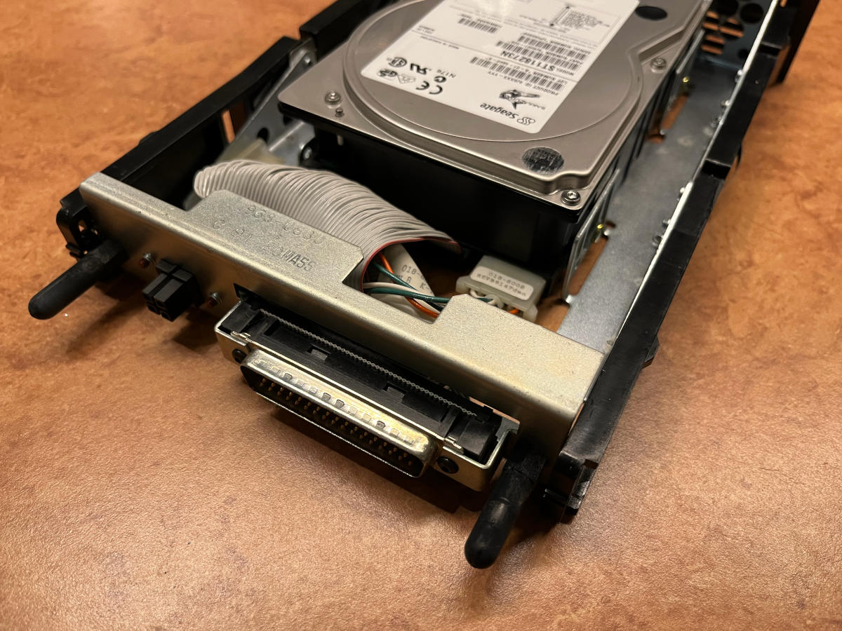

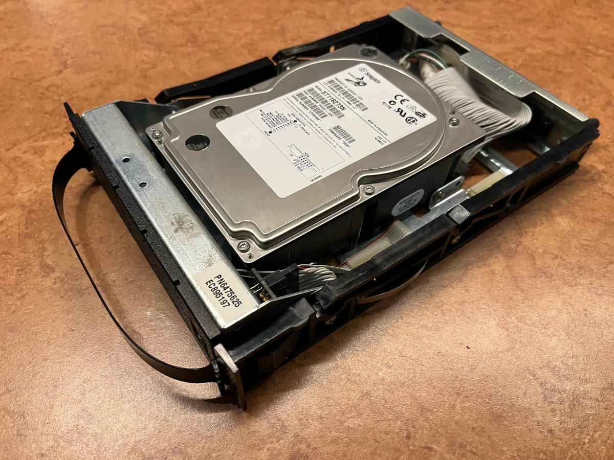

The disk tray in my Crimson. The disk itself (18GB narrow half height 3.5" SCSI) is not original SGI so the SCSI ID dial at the front currently isn't functional.
[Image: IMG_8348_sm.jpg]
[Image: IMG_8349_sm.jpg]
I recently noticed some production dates ~ Q2 1994 on the Crimson's internals so I guess by then the full height 5.25" disks were going out of fashion.
