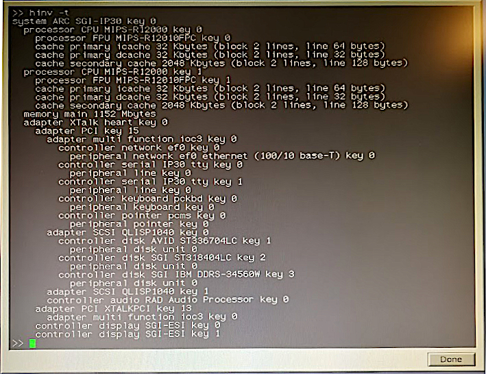

RE: Problems with installing IRIX on my Octane - Dionisis - 02-25-2022
This is my hinv, i do not know which serial is my MB and what mermory modules are, all i know the old disk which i replaced with the new one worked (IRIX was booting but i didn't have the root pass), so i can rule out the MB and RAM.
RE: Problems with installing IRIX on my Octane - weblacky - 02-25-2022
Why don’t I see a cdrom/dvdrom on your hinv? To get part numbers I think you use -vm on hinv? Please drop the -t, it just visually mangles output in a way that’s harder to read. Hinv -vm is your friend.
Okay, I don’t even know why I’m responding and yeah I’m now going to be slightly flippant to this but the hinv you posted is formatted by connection and scsi qlisp140 key 1 has no drives listed under it, therefore you have no external drives shown.
Where as scsi qlisp140 key 0 has three hard drives, two are seagate part numbers and one is an IBM. I wanted to confirm you’re not riding on another ID or the controllers’ native ID. But I guess I’ll simply say my piece and leave this thread as you don’t like checking the basics we ask, so you don’t want our help. It’s always the basics. But here’s my last offer of help as I close the door, best wishes.
