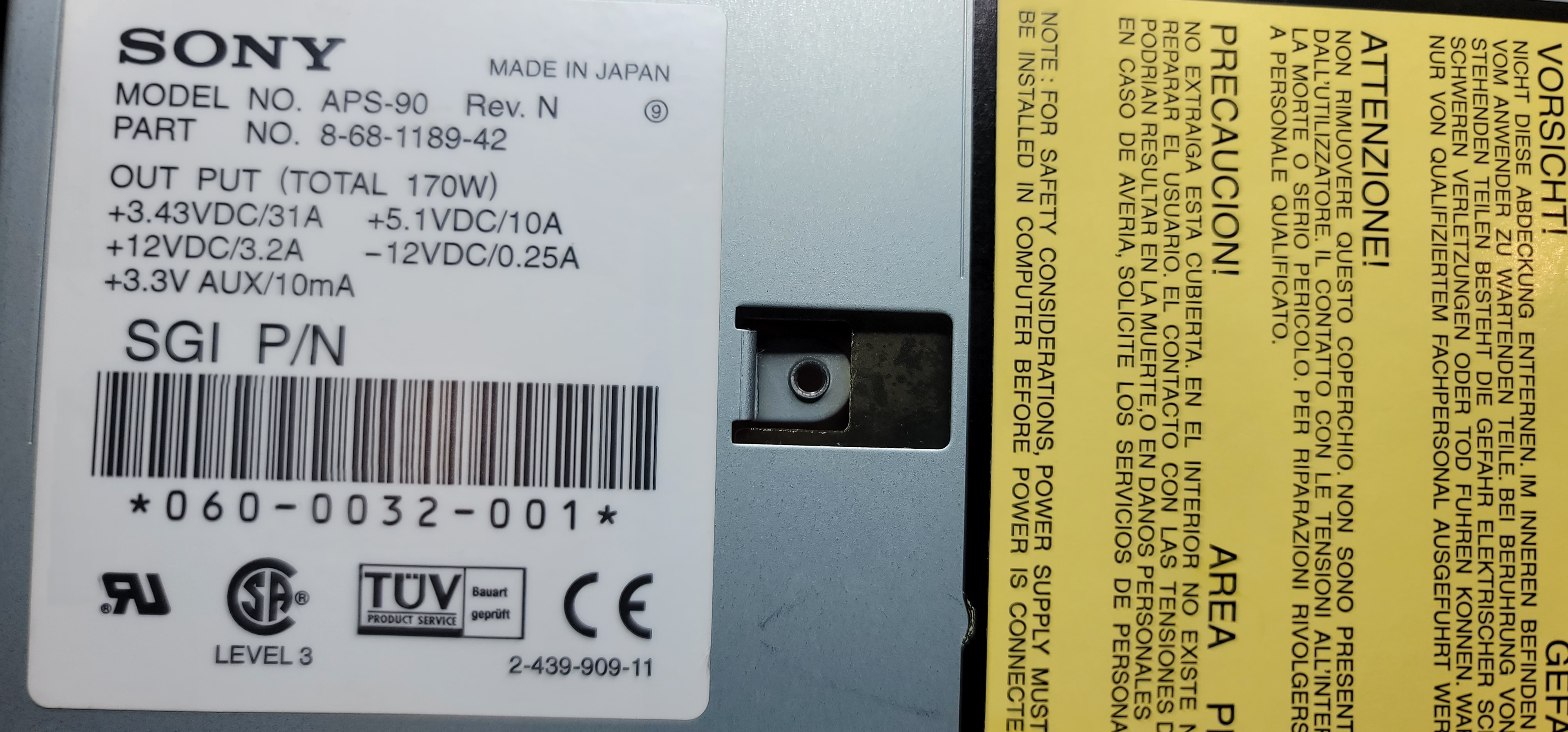

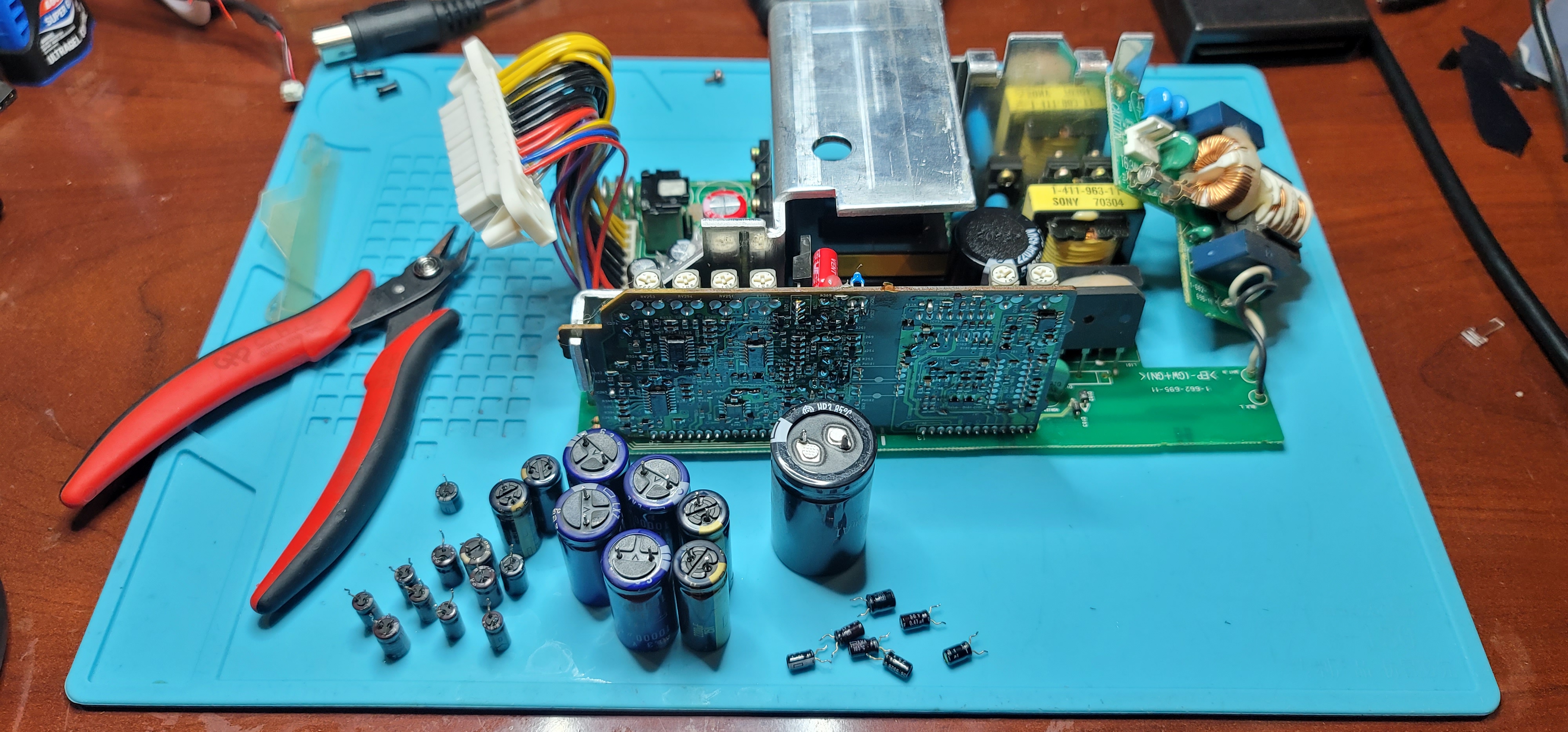

I just Finish recap of a SGI O2 Sony PSU Model APS-90.
Capacitor List:
SGI O2 PSU V2
Mouser # Mfr. # Order Qty.
710-860160672001 860160672001 4
710-860160672002 860160672002 2
710-860160373016 860160373016 4
710-860040573004 860040573004 2
710-860040672001 860040672001 5
80-ESW475M025AC3AA ESW475M025AC3AA 1
647-UHD0J222MPD UHD0J222MPD 2
710-860160473015 860160473015 1
598-SLPX221M450C7P3 SLPX221M450C7P3 1
710-860160478033 860160478033 2
647-UPM0J103MHD UPM0J103MHD 4

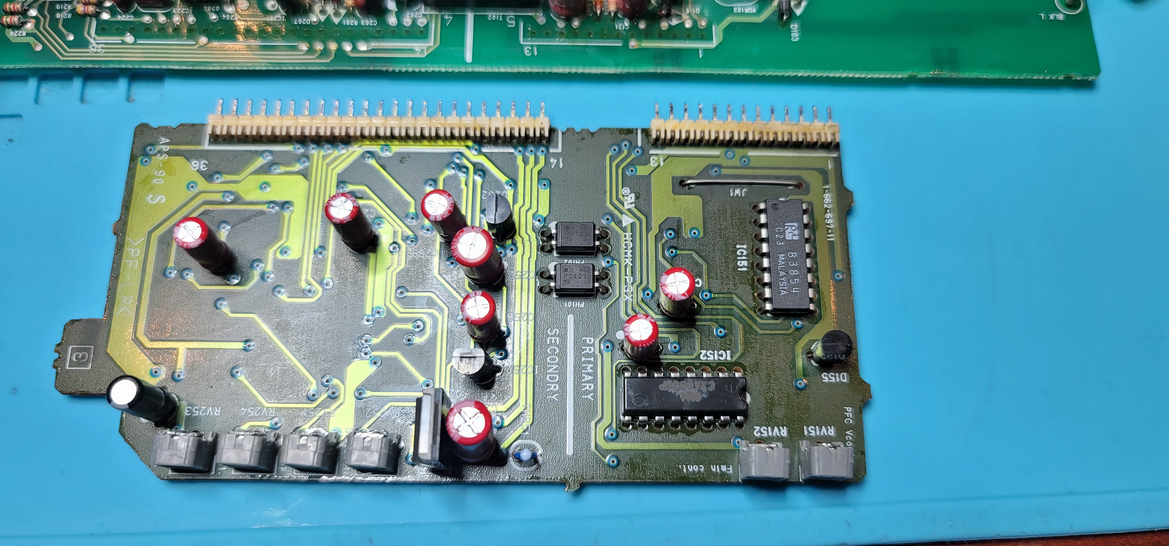

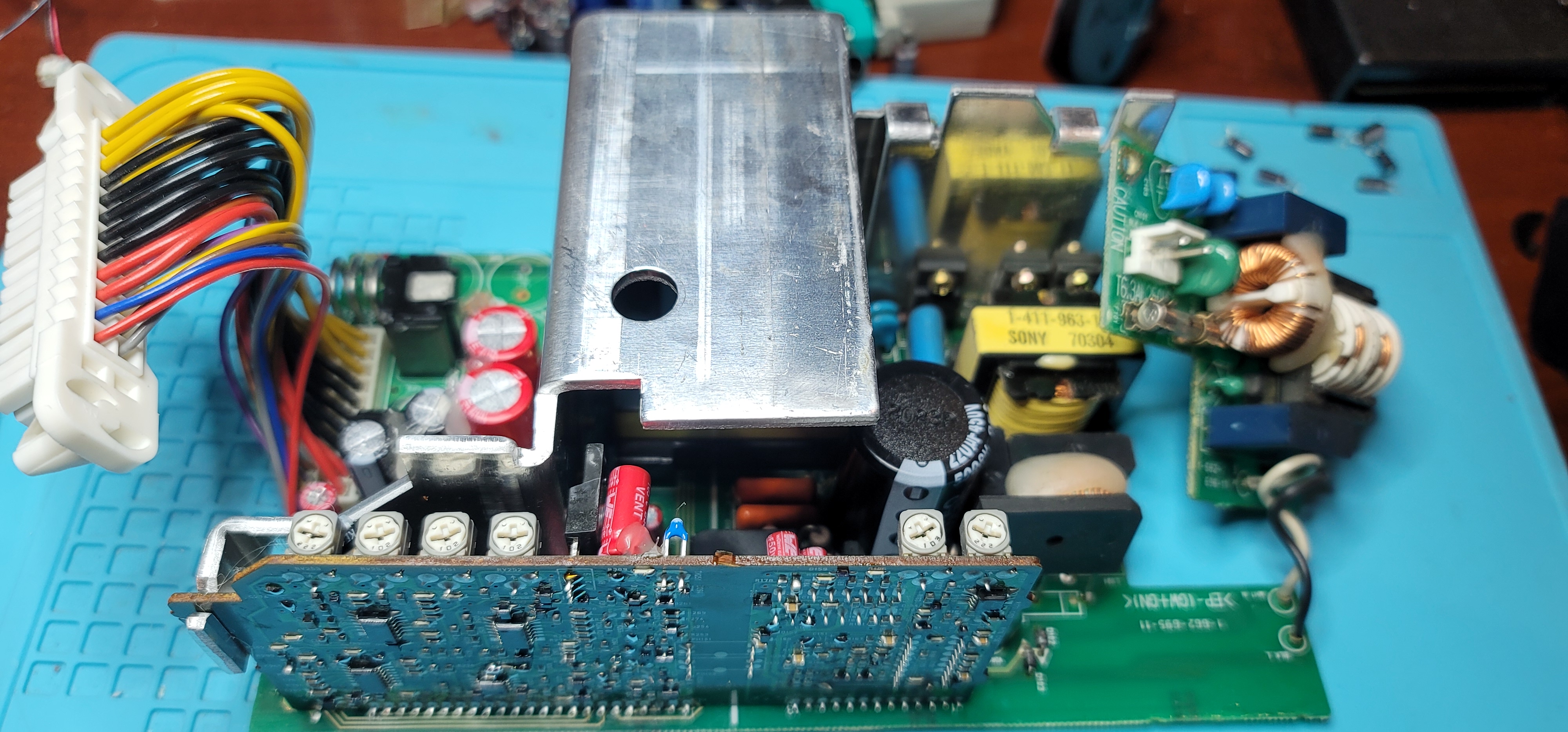

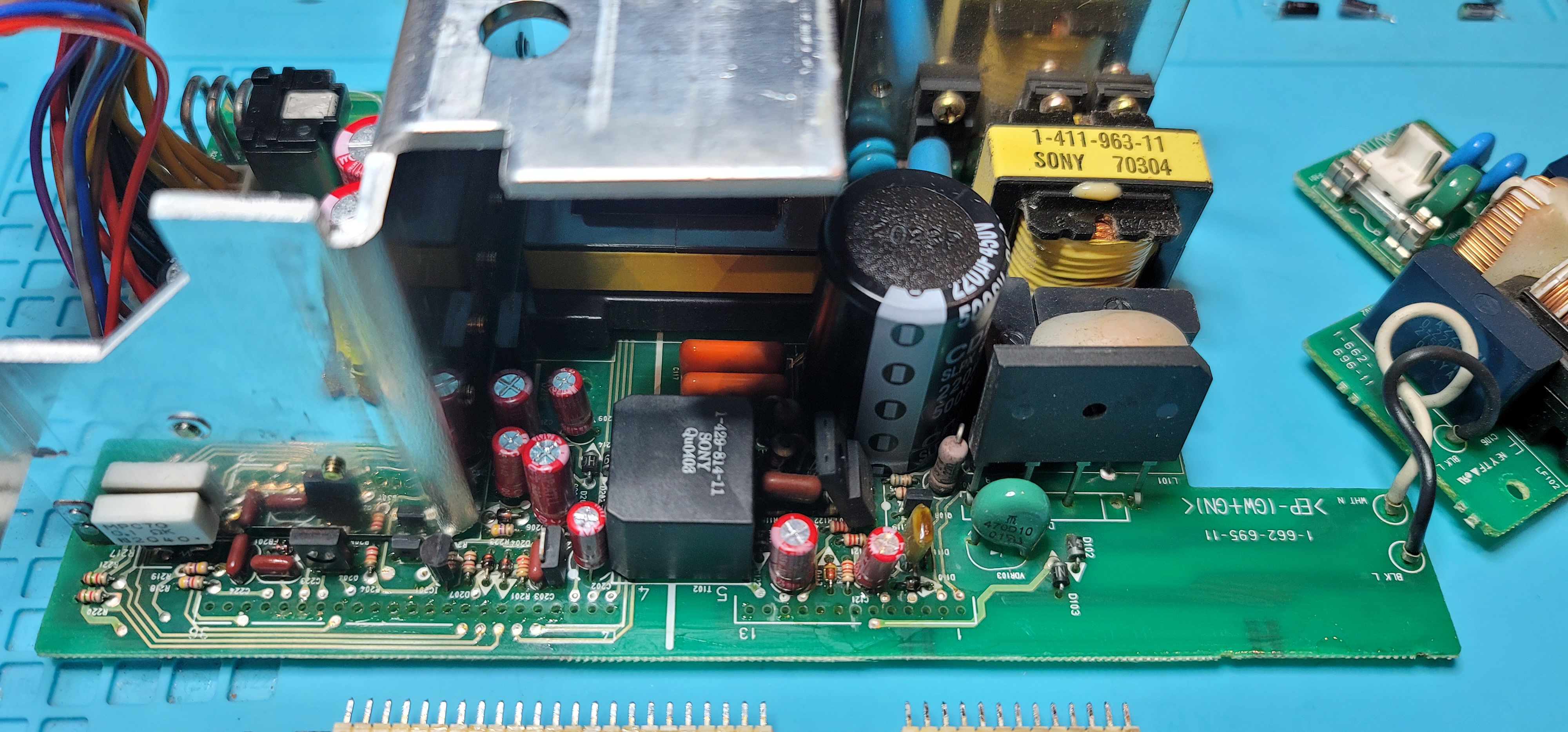

Main Board cap replace.

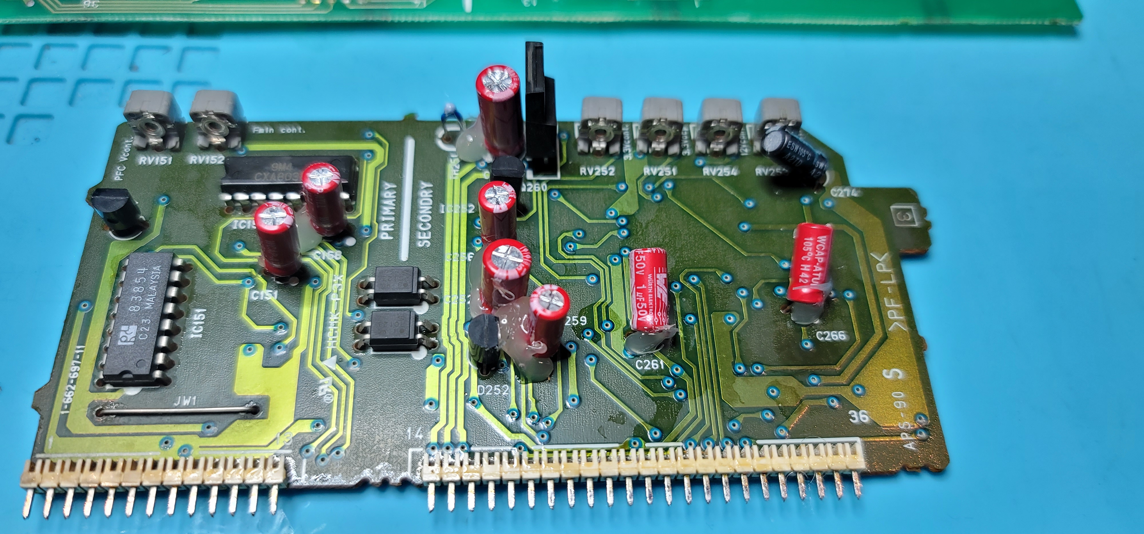

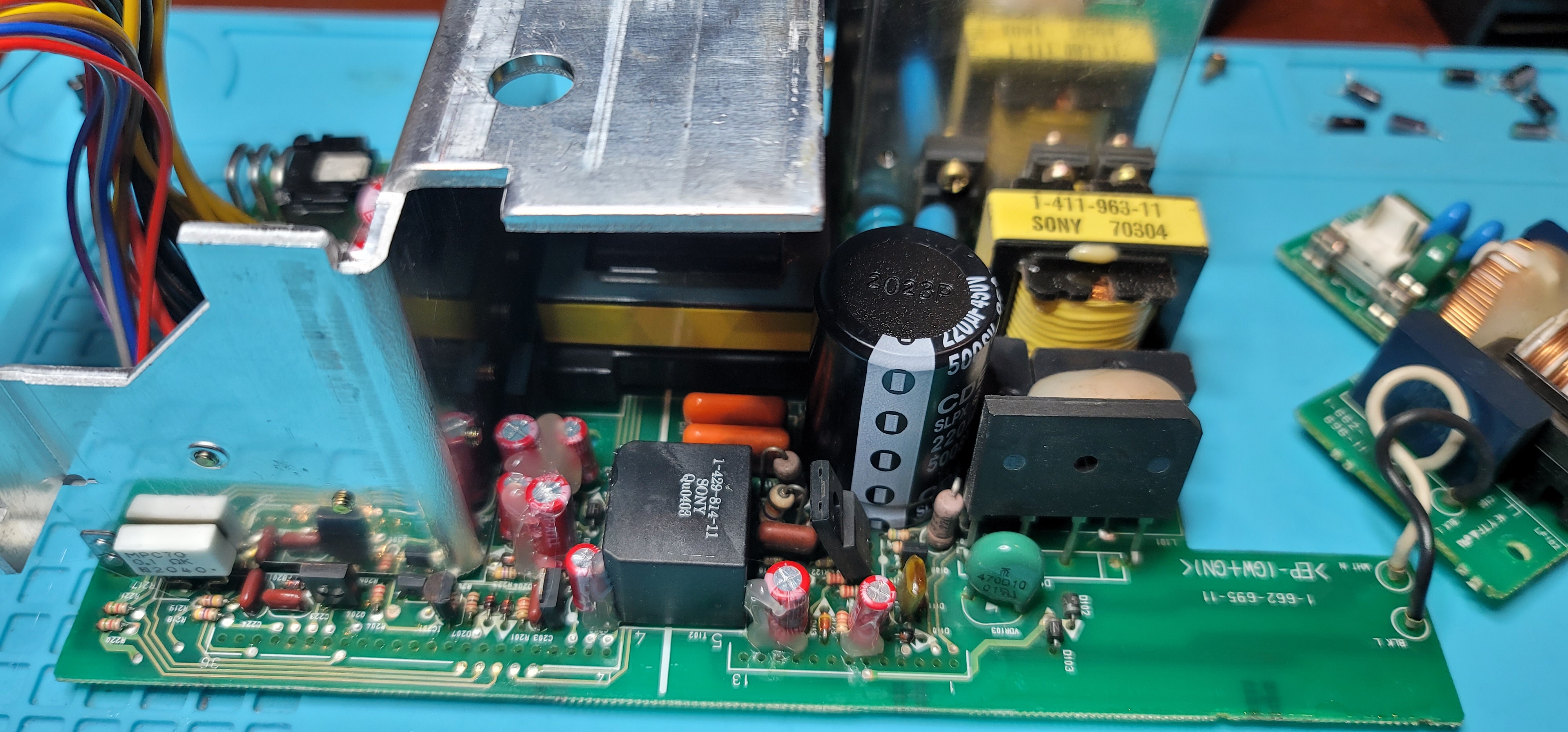

PSU Control board...Because I use longer life caps, couple of them have to be laid down a little.

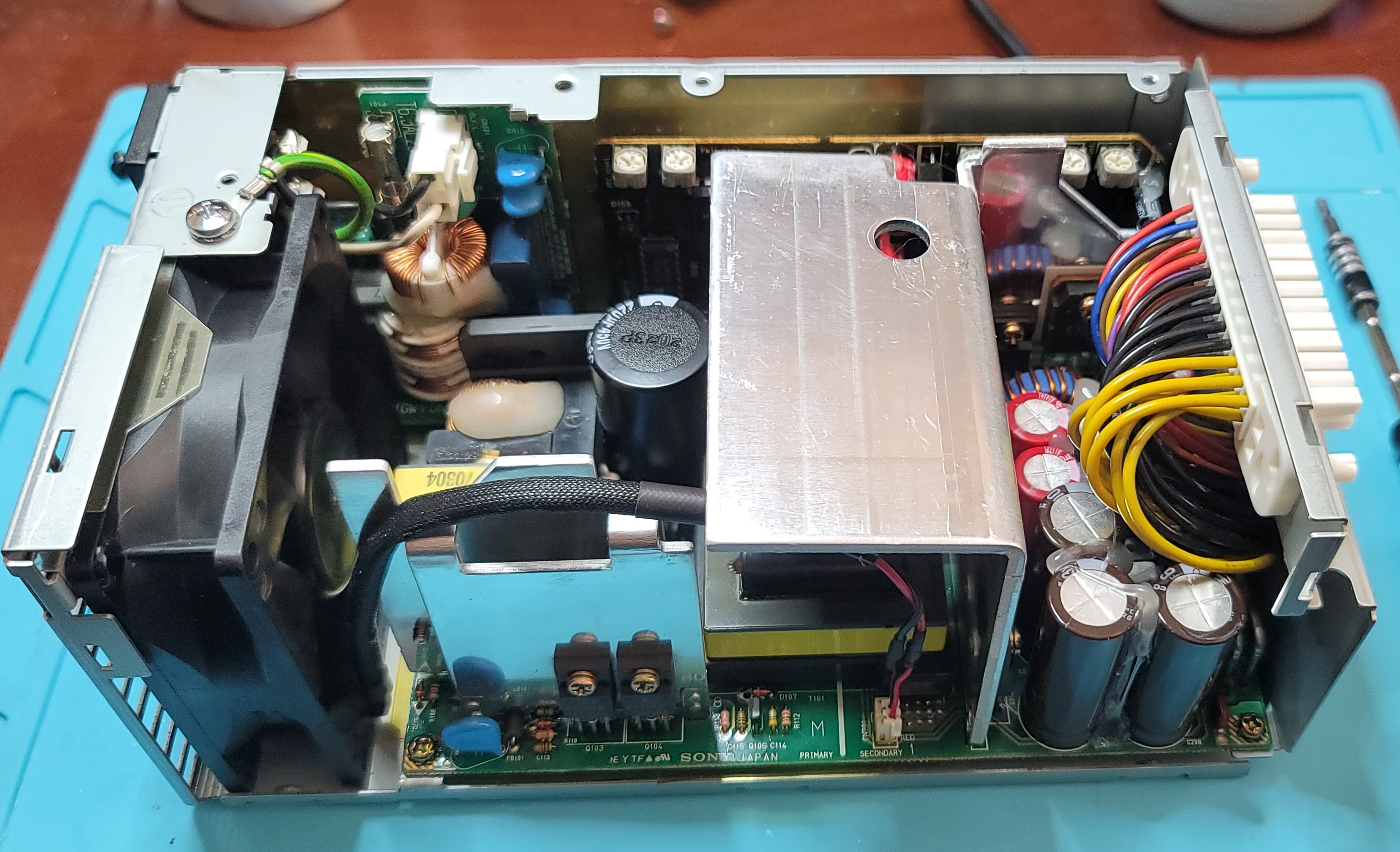

Control board attached to the main board.

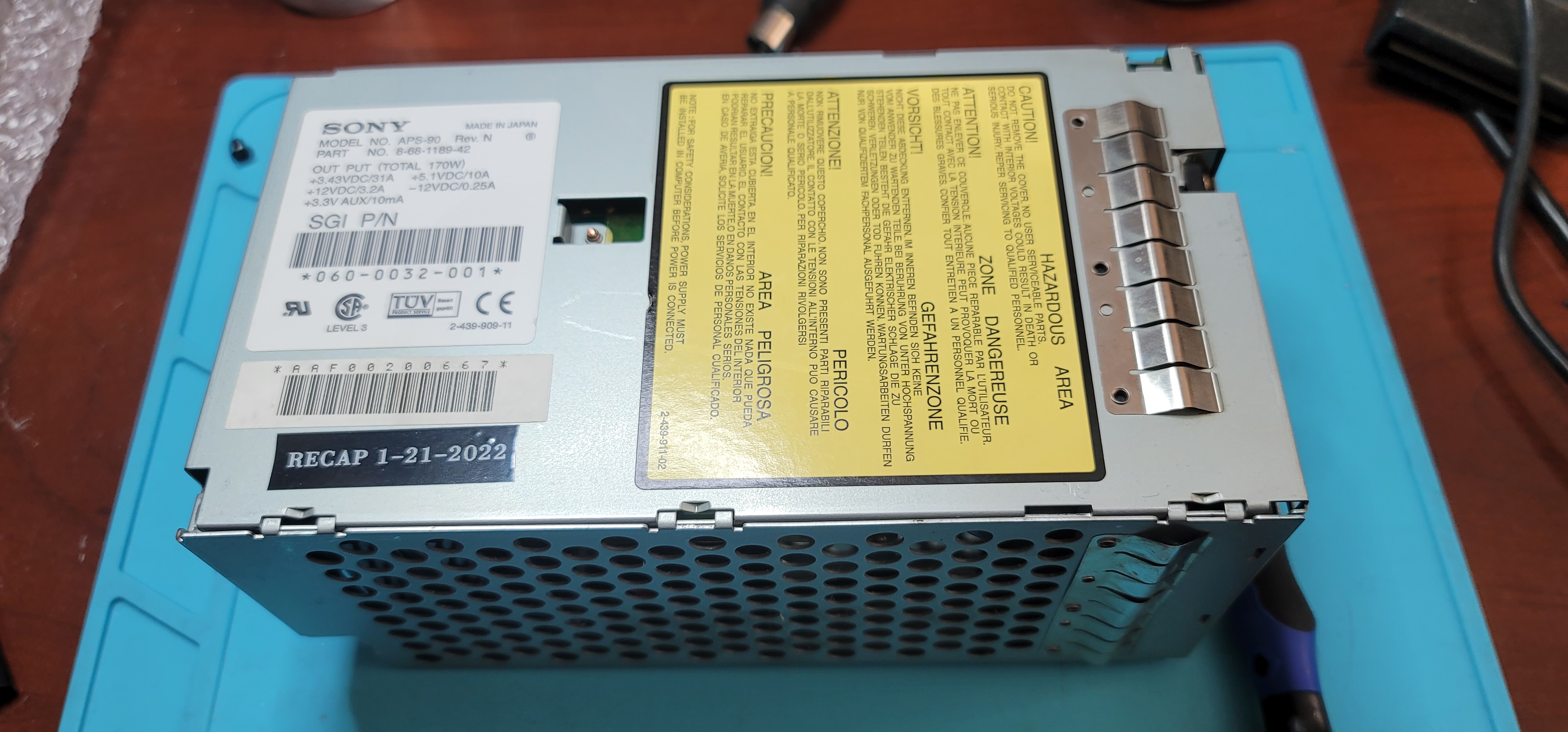

Ready for assembly
Ready for use!
RE: SGI O2 PSU Recap -
weblacky - 01-21-2022
I'd recommend you remove that glue and use real Silicone stabilizer. Hot Glue is hydroscopic and will eventually become conductive, potentially dampening or shorting out your caps, before their life is actually used up. if you want to use it then don't get it into the legs or metal cap of the capacitor where it came interact with energized parts. Just stick it to labels and between components. Also don't get that glue into coils, it will change their readings.
megaimg - 01-21-2022
(01-21-2022, 10:48 PM)weblacky Wrote: I'd recommend you remove that glue and use real Silicone stabilizer. Hot Glue is hydroscopic and will eventually become conductive, potentially dampening or shorting out your caps, before their life is actually used up. if you want to use it then don't get it into the legs or metal cap of the capacitor where it came interact with energized parts. Just stick it to labels and between components. Also don't get that glue into coils, it will change their readings.
Thanks!
wroteafaq - 01-21-2022
And I know it can be tough to find the correct form factor parts, but for reducing vibration you can't beat getting the lead spacing right.
