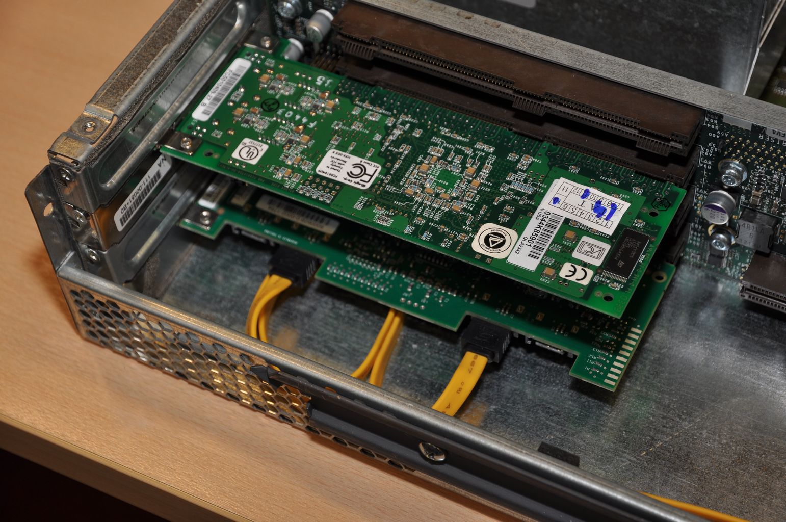

I added 4TB of local storage to my Origin 350: two 2TB SATA disks attached to an LSI SAS3041X-R, striped using XVM. These are “eco” (5400RPM) models. The SAS3041 is in the lowest PCI slot of the second Origin 350, where you would normally find the IO9. It has the PCI bus to itself so it runs at 100 or 133MHz PCI-X speed. I had to order some special 70cm SATA cables with an angled connector at the drive end: there’s insufficient between the drives and the nearest fan for anything else.

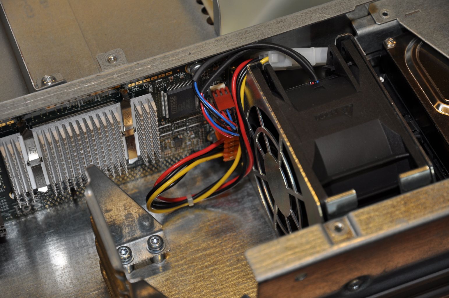

[Image: DSC_6963.jpg]
Power cable
[Image: DSC_6960.jpg]
LSI SAS3041X-R, underneath a QLA2342 dual 2Gb FC board

Space between the disks and the blower is limited. I looked around for a suitable SATA backplane but found nothing. Actually, I suspect that the Altix 350 has it. But that’s why the cables have to be just right. I had the right SATA power cable in my junk bin, but not the extra long, angled SATA cables. They have to be the ‘left’ / ‘straight’ model.
There are some clips on the outside of the Origin 350 chassis, and the space to route the cable around the fan, which is why I chose the left hand cable. The more common cables with vertical attachment won’t work on the lower drive (not enough space).
