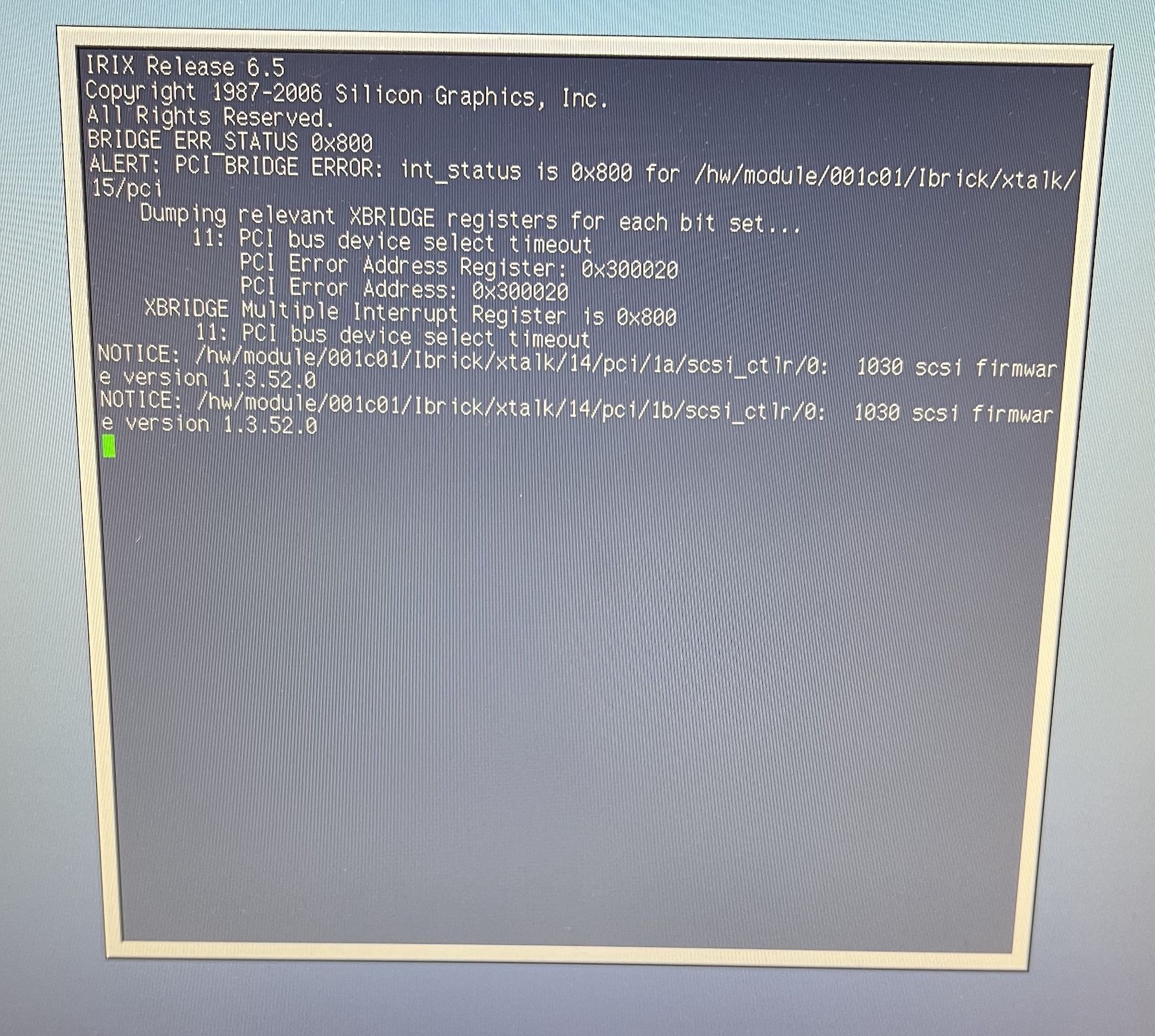

So the version jump wasn't huge, but it's there.  Rebooted and check that the Windows 7 OS I had running on the PC saw the two SCSI HBA controllers on the card and installed drivers...done...popped it back in the Fuel.
Fuel again sees the additional SCSI controllers and doesn't complain about firmware...recognized now as:
So there you go!  A vendor Dell LSI21320-IS pulled onto LSI Retail Production firmware, RAID removed (it only had like Raid 0 or some crud anyway...no loss at all)!
