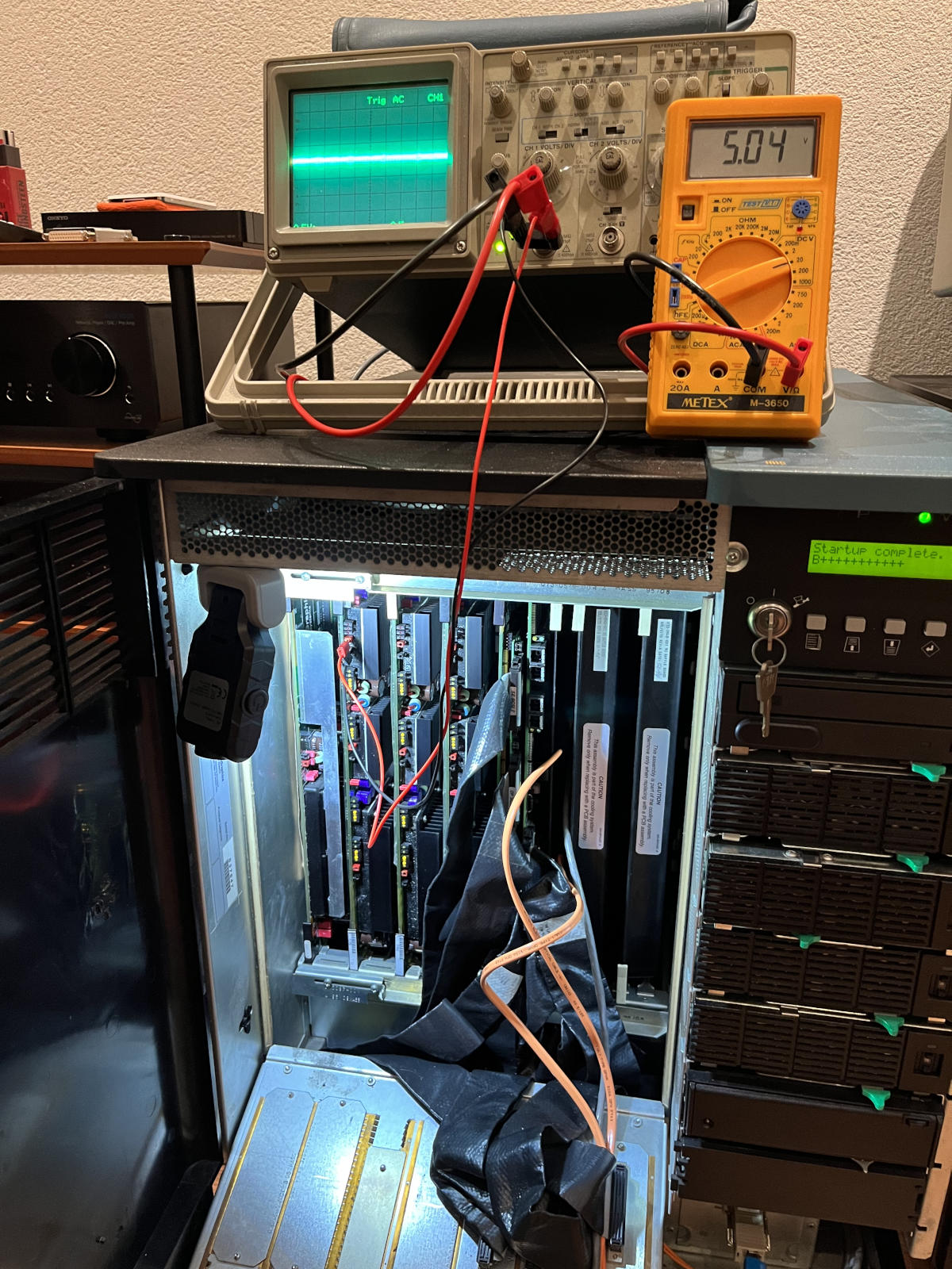

Back to my system. The only source of -5V and -12V in the system is the IO4 VCAM. So I replaced the IO4 with a spare, which changed absolutely nothing. Damn. Fortunately, the VCAM is fitted with test points for all DC-DC converters, but they're not accessible from the outside when the card is in the system. So I wired up some extensions:
[Image: IMG_7313_sm.JPG]
[Image: IMG_7317_sm.JPG]
This confirmed that the voltages were all correct and in spec. The problem wasn't with the DC-DC converters, but with the environmental monitoring. This isn't very different from what the O3K / Fuel generation is known for, but unlike those you cannot disable monitoring on the Challenge/Onyx series (nor would you want to...).

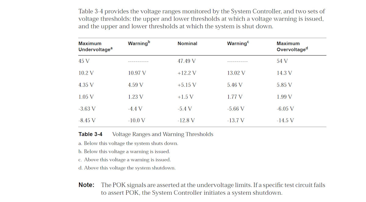

Like I said above, most boards monitor their own on-board DC-DC converters. There's an upper and lower warning limit, and an upper and lower fault limit:
[Image: thresholds.jpg]

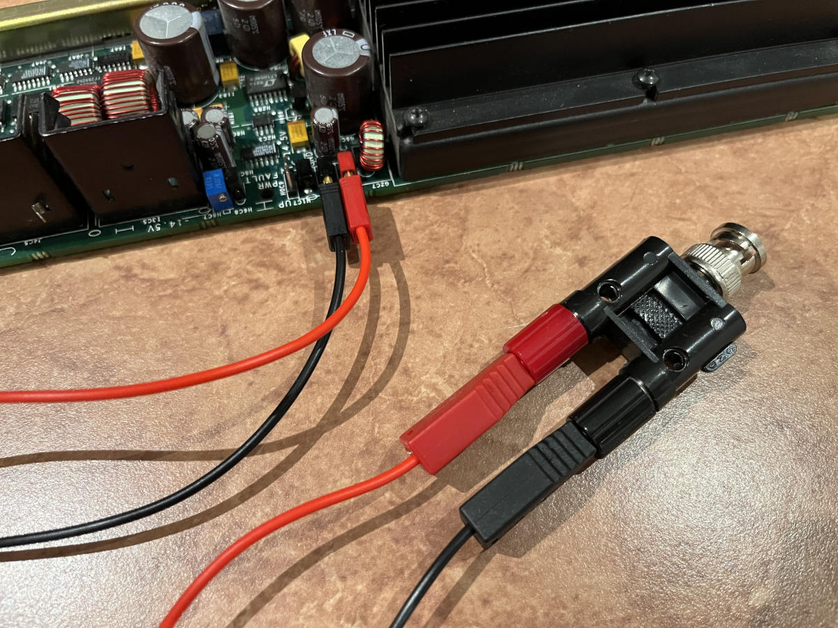

I can report that the little power probe sockets on the various Challenge/Onyx boards will fit a 2mm mini-banana plug:
[Image: voltages1.jpg]
I bought some 2mm mini-banana to regular 4mm banana cables. This makes checking the various voltages in the Challenge a lot less nerve-wrecking than poking around with the volt meter in a live system.
[Image: voltages2.jpg]
