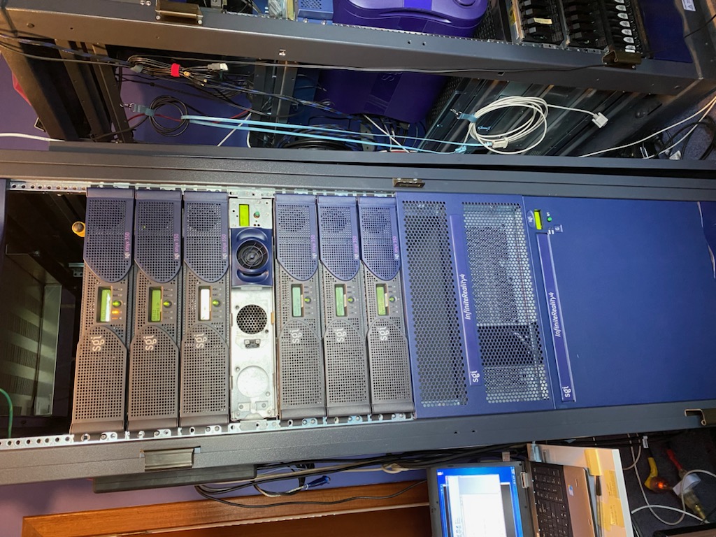

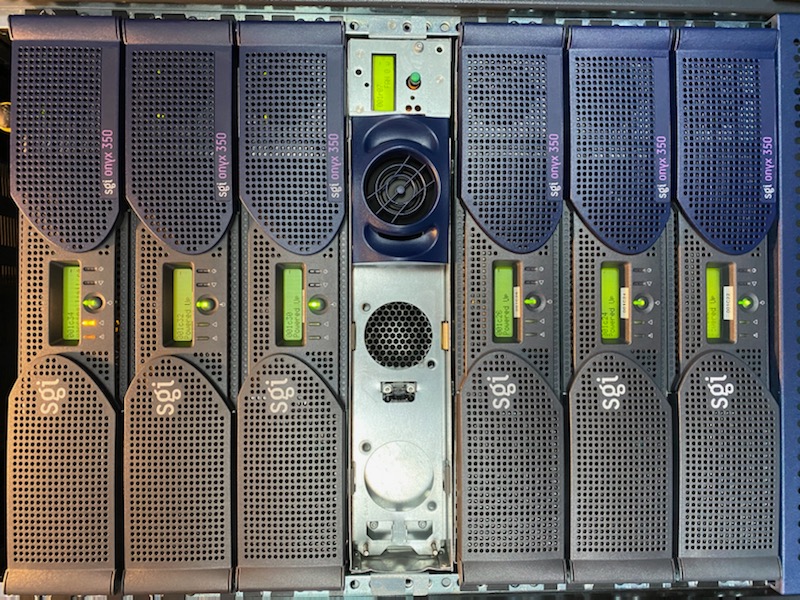

So here are six spare O350's now connected using a Numalink router (yes its a bit beat up as the freight company shipping it were brutal).

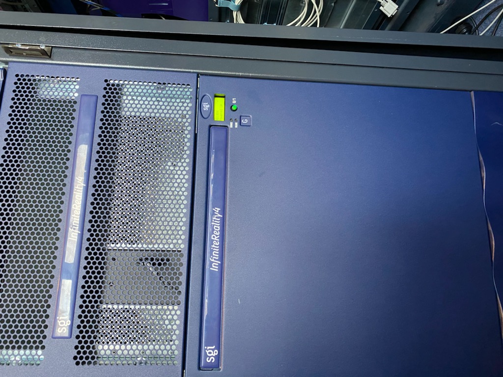

For graphics I used a spare IR4 which was already in the base of the rack and simply connected it to the XIO port on the base O350.

Unfortunately it' not all quite right as yet as there are missing fans on the C34 and C7 router which have to be replaced. Also, several memory sticks seemed to have died which need replacing. I'll get these sorted as soon as practical.
Here's a photo of the complete system.
Image_0566

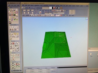

Lastly, even though its not been setup for any particular task, I was looking around for an application to test its capabilities. I loaded MultiGen2 flight simulator which runs quickly although I'm yet to learn how to use it! I also don't have a licence so I can't save anything:(
Image_0571
