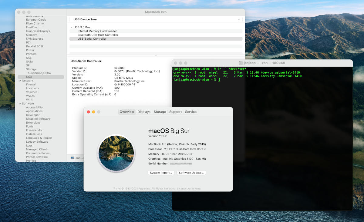

This is not for Apple to sort out, the question is "has the 3rd party created a driver using the new framework". I have no idea what serial adapter you're using, but if I were you I'd just buy one that doesn't need a 3rd party driver. Then it just works:
[Image: bigsur.jpg]
This one is a Sweex CD003, and probably 10 years old. It's just another el cheapo Prolific PL2303 adapter.
NB: I'm happy to report that BlackMagic has released Big Sur compatible drivers for the Thunderbolt mini-monitor and mini-recorder. That's what was keeping me back.

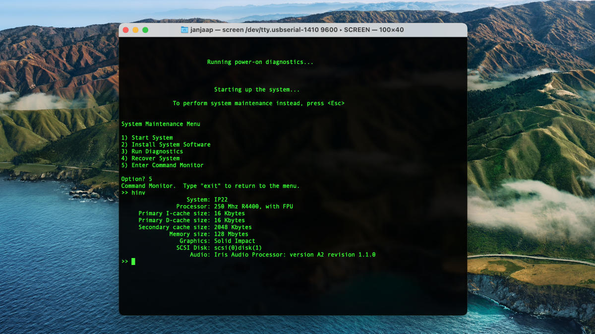

Well, maybe it works after all? Mine does:
[Image: pl2303.jpg]
Otherwise, buy something with an FTDI chip. See : https://tips.graphica.com.au/macos-big-sur-rs232/
