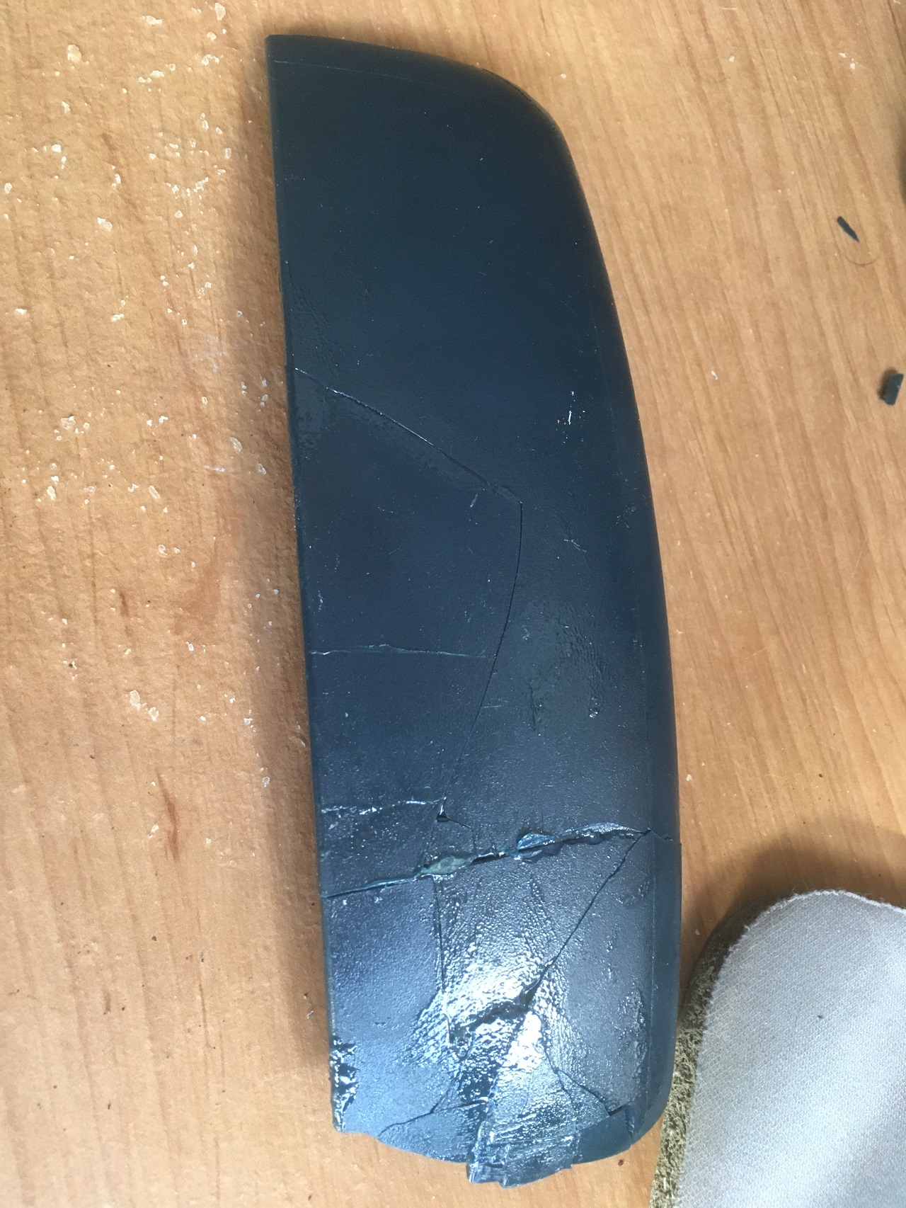

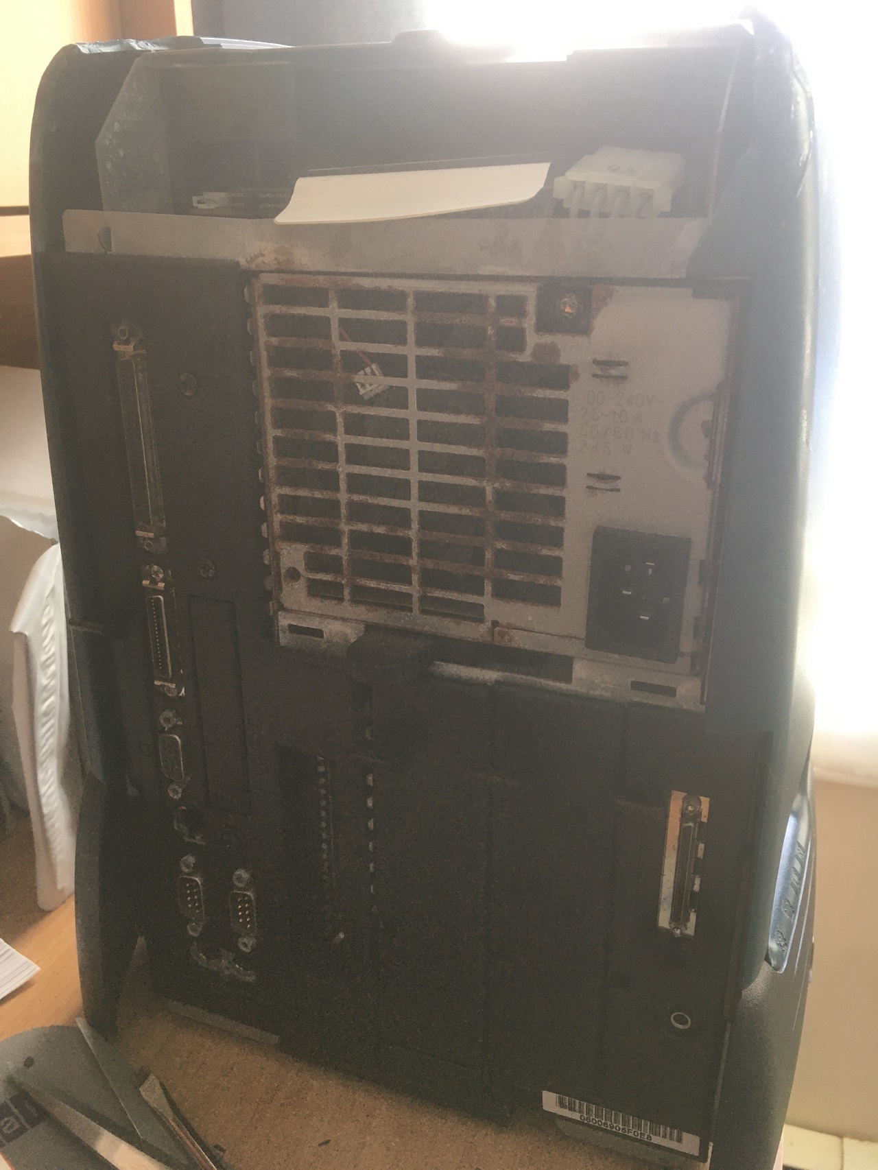

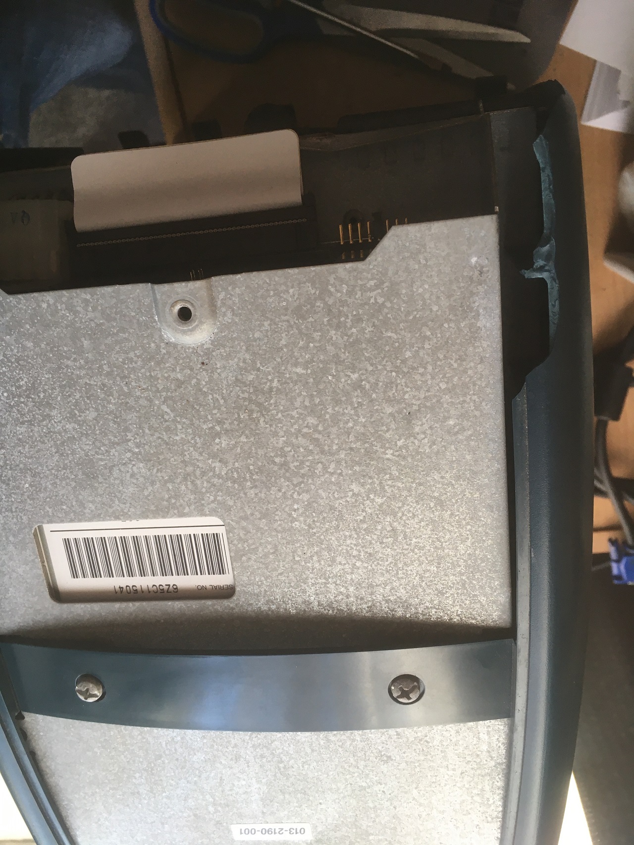

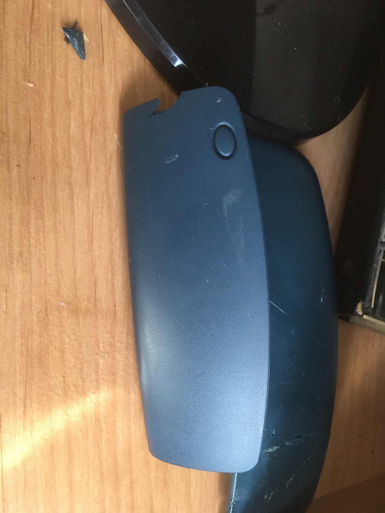

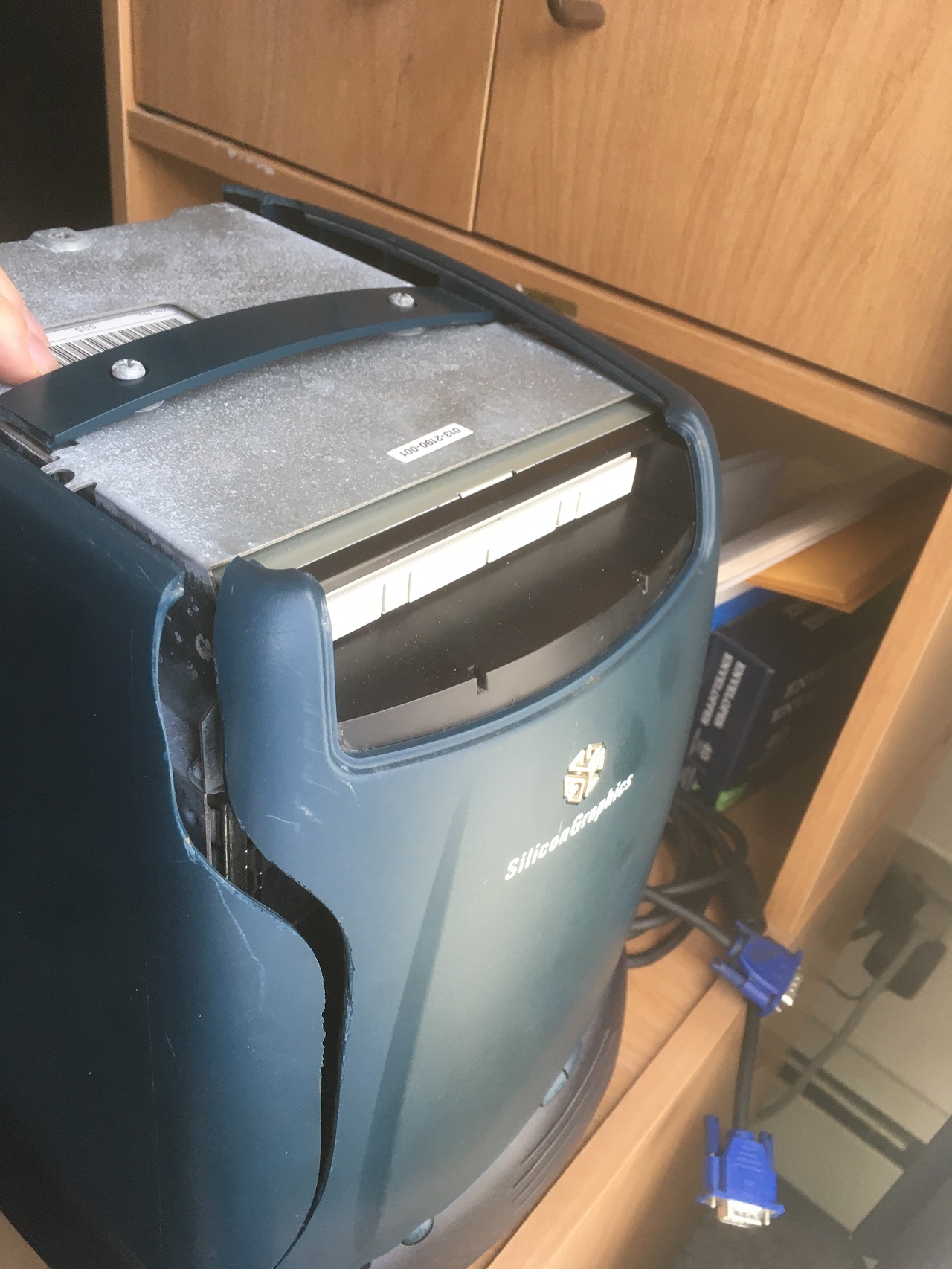

So I've got a o2 FINALLY no luck on the octane tho lol. It runs and works fine psu fan seems a bit loud but regardless the o2 cosmetically is a hurtin lil boi. The metal case has some rust (especially the psu case and) the plastics are in HARD shape. The back piece that the hat (the top bit) is a jigsaw puzzle which I put back together and there are several huge cracks from top to bottom. I plan to just glue these and form a hat out of another hat with a plaster of paris mold lol. but enough about my hurtin plastics I knew they were busted before I got it. but the metal case needs a sand and a paint. I got the psu out and took the screws out and the top folds off easy peasy. The fan had a screw in the bottom and it seems to have to plastic clips up top. Is there anyway to get the fan out without breaking them? If I do decide to reuse the fan it kinda needs to not be broken after painting does anyone also know how to get all electronics connectors out of the metal case? I found the service manual but it only shows how to strip the o2 to the base and the metal frame with connectors inside. Now I know painting is pisses people off but If I showed you a picture of this badboi you agree with me lol. Itd be nice to paint it the original colour if I knew the colour code but I may just paint it white with black metal.
edit: Added a few pics it was clearly a shed boi and came with some nice cat treats inside and some cobwebs!
