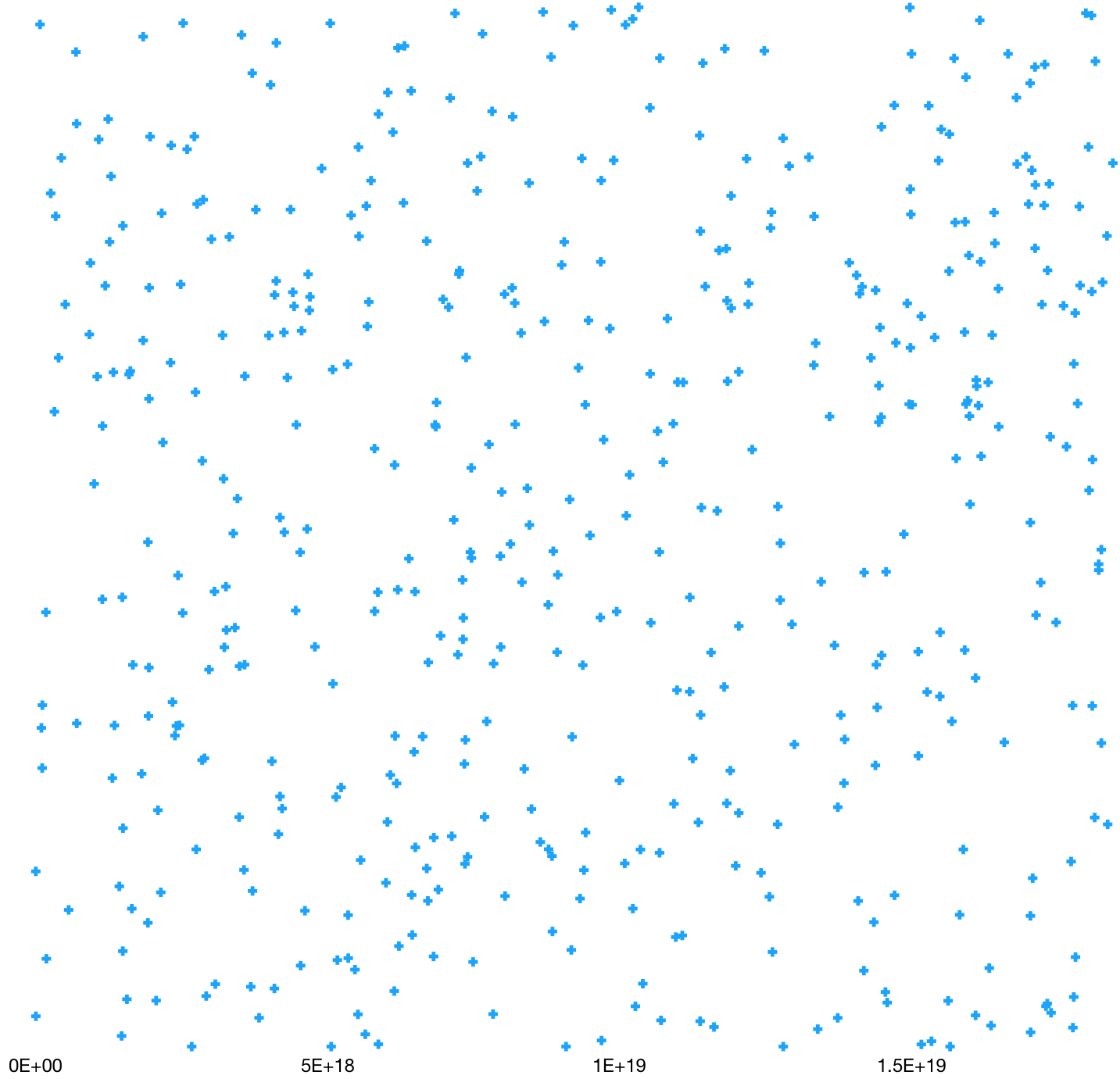

Here's a graph of ssh-rand-helper randomness, it's not too awful, from 1000 samples.
