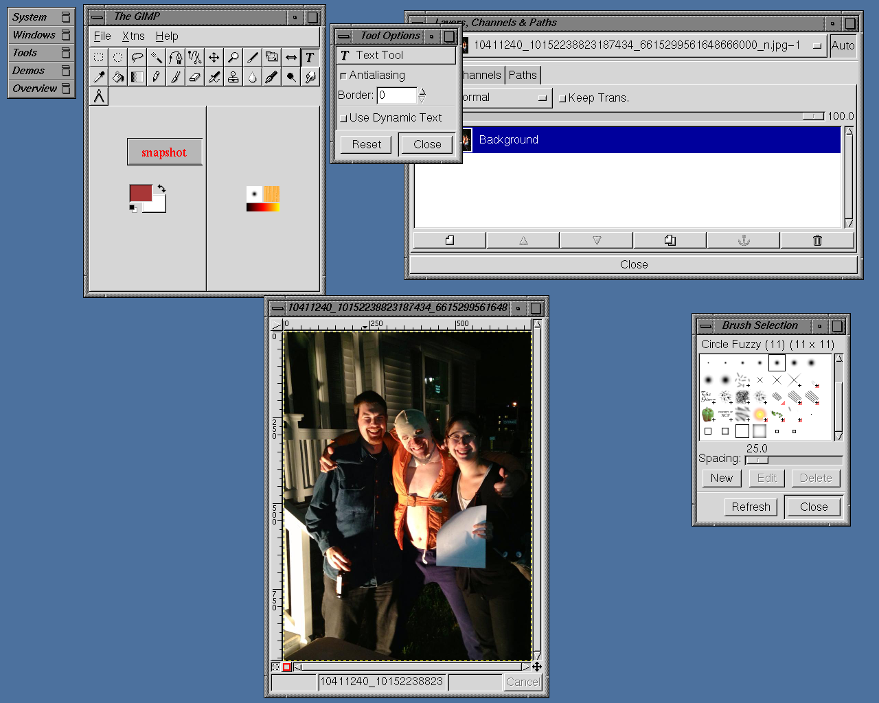

Backporting GTK 1 to IRIX 4 (well, X11R4): done. So you can have ugly stuff like GIMP 1.2. But I want more. MORE!
