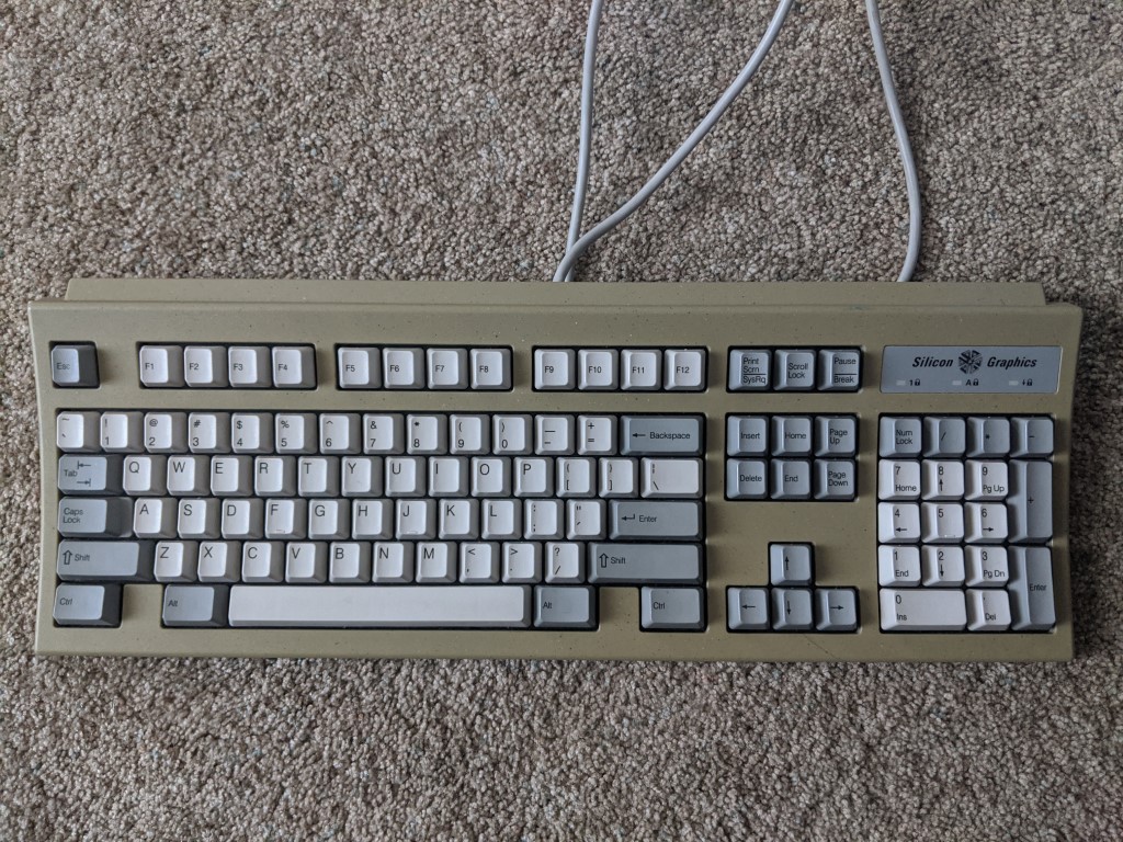

I recently picked up a RT6856T off eBay for a good price but it was pretty yellowed so I decided to try to retr0bright it. This would be my first time doing this so I looked at the original formulas and process as outlined on the original retr0bright page but after a bit of Googling and too many YouTube videos I found multiple people just using professional hair developer cremes or liquids to accomplish the same thing as they are usually ~12% hydrogen peroxide.
The success of the retr0bright really seems to come down to a good % of hydrogen peroxide and UV / heat to promote the process.

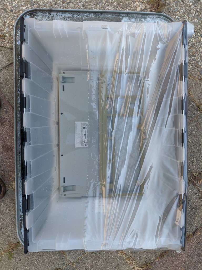

The creme like the original retr0bright process would be applied directly to the surface and then covered by clear cling wrap but some people warned that unless you get it evenly coated the part or go out in and kinda squish it around during the process you may get blotchiness and uneven results. The clear developer is liquid and people seemed to have success just submersing the part in a tub with developer + water mix covering the tub in cling wrap and setting it out in the sun for awhile.
I decided to use the Salon Care 40 Volume Clear Developer since the keyboard was fairly large and I didn't want to worry about blotchiness in the results. I used a storage bin that I had in my garage and dumped in the 32oz of the developer and added water. I weighted the parts down so they wouldn't float and set it out in the California sun.

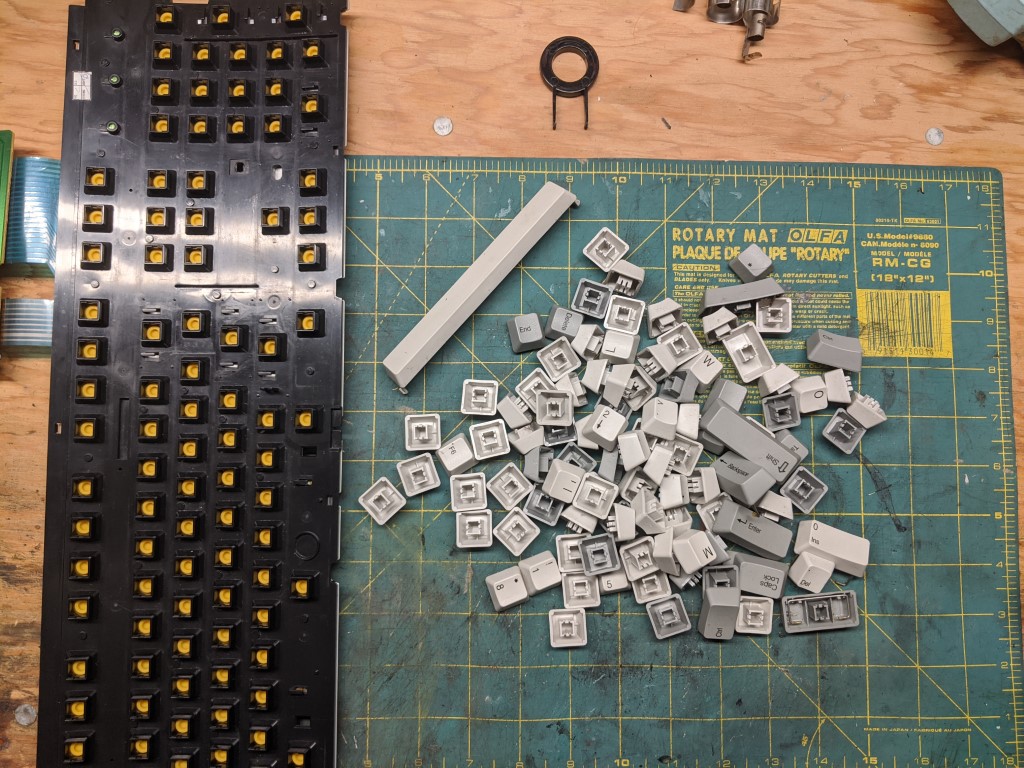

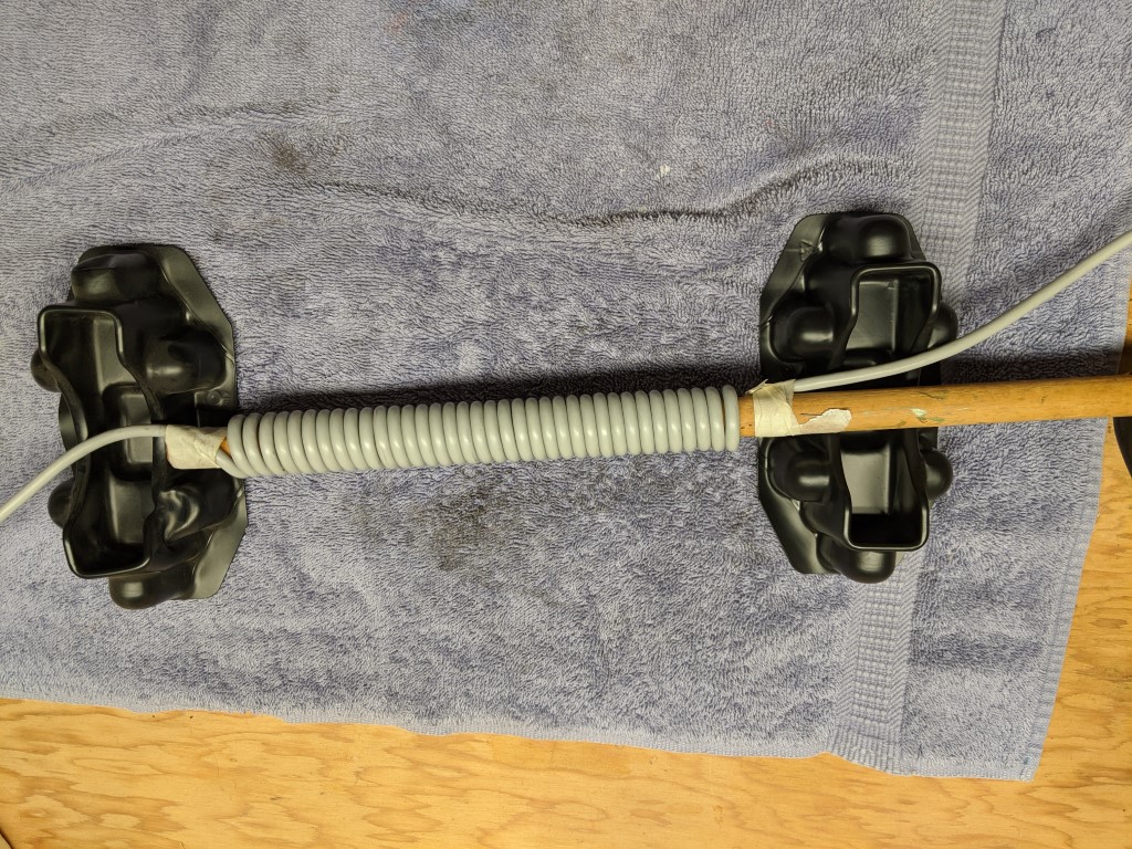

While the keyboard plastics were being brightened I decided to give a good clean to the keys and the base keyboard since it was pretty dirty and grimy. I pulled all the keys and cleaned them in a dish soap + water solution in an ultrasonic cleaner. I also decided to coil the extremely long keyboard cable to help keep it manageable for the limited desk (or floor space) I have for the SGI at the moment.
Overall I am really happy with the results. I believe that I diluted the solution with too much water as after about 6 hours in the sun the plastics were still a bit yellowed, but still a big improvement, so I ended up setting them out in the sun for a second day and the results were much better. I believe with a less diluted solution a single day would have sufficed.

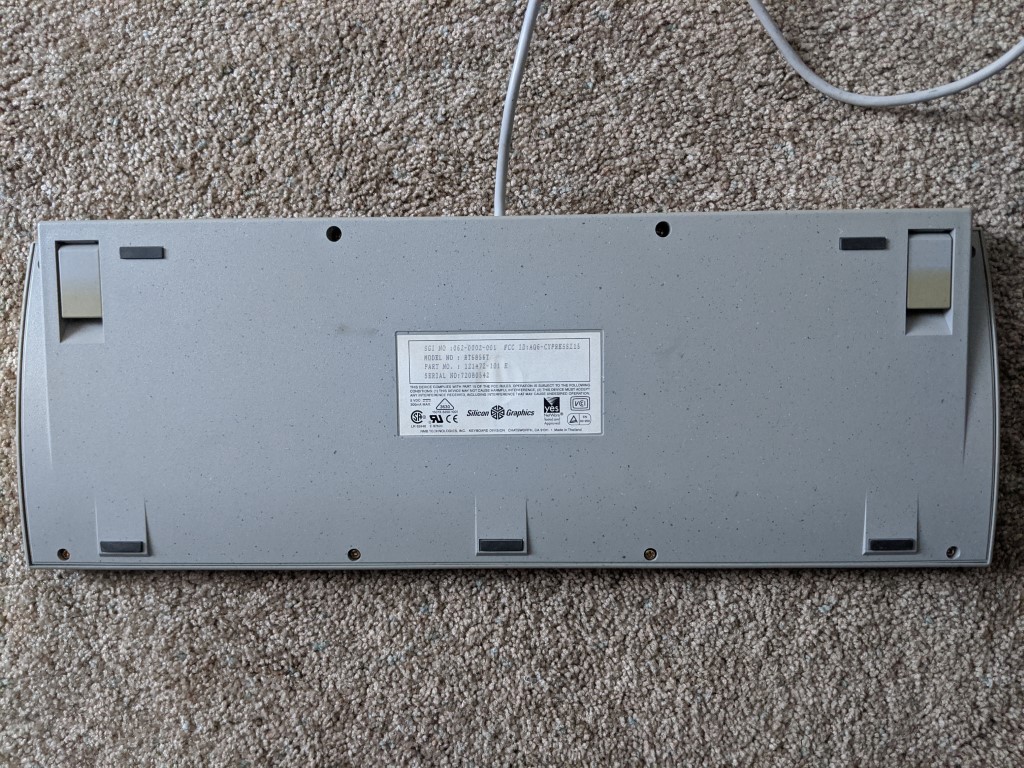

weblacky Wrote:One question for you, I can’t see well enough in your final pictures, how much of the “granite speckles” survived? I see the gray color, but I don’t really see the black specks. Did those survive?
The speckling definitely softened on the front where the yellowing was much worse than it did on the back side but even on the back side the darker speckles did soften as well, just not as much.
I tried to do a few comparisons of before and after, but note the lighting conditions are different and the after pictures seem cooler in color than they do to the eye. As you can see the back label also bubbled a bit and the "typed" model number text lightened up quite a bit but the "printed" label like the box and SGI logo still look crisp. The ripping of the label was me unfortunately poking the label while it was in the water by accident, before that it wasn't ripped.
I used an IR thermometer on the first day it it looked like the water was ~120F. The speckling softening may not have been as bad if I was able to get the results I wanted in a few hours, or if the hydrogen peroxide concentration was higher and water temp was higher. I would probably suggest doing a test run if at all possible, esp if some of the targets are rare hardware.
