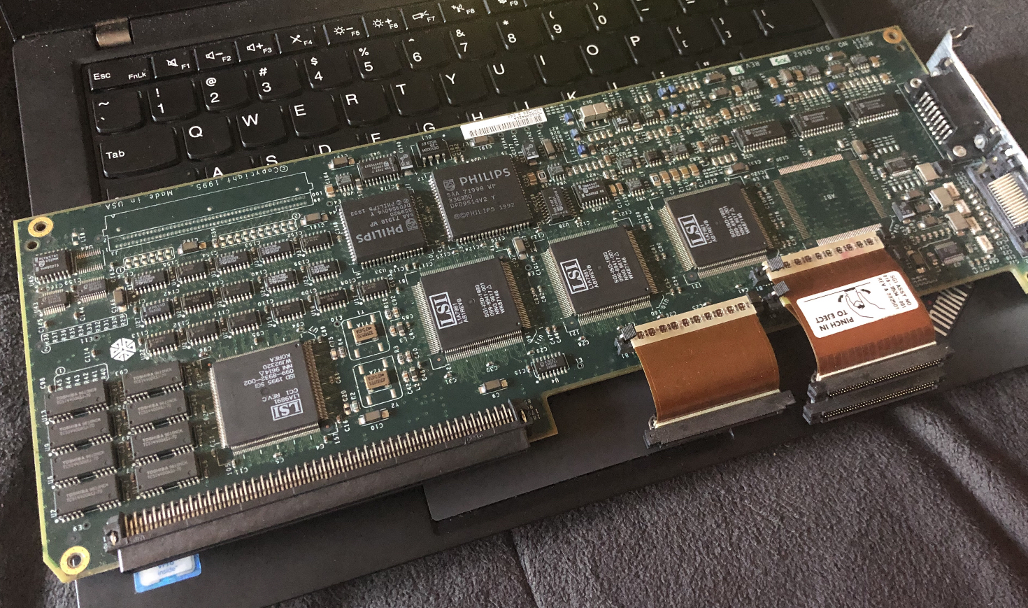

RE: Just picked up an Indigo2 R10K. Want NTSC video out. - chulofiasco - 08-09-2020
The board looks like this.  Make sure you have the cables to connect to the IMPACT boardset.
Provides a connector for the IndyCam and another connector for a breakout box.
The breakout box gives you 2 x Composite Video In/1 x S-Video In and a single output each for Composite & S-Video.
