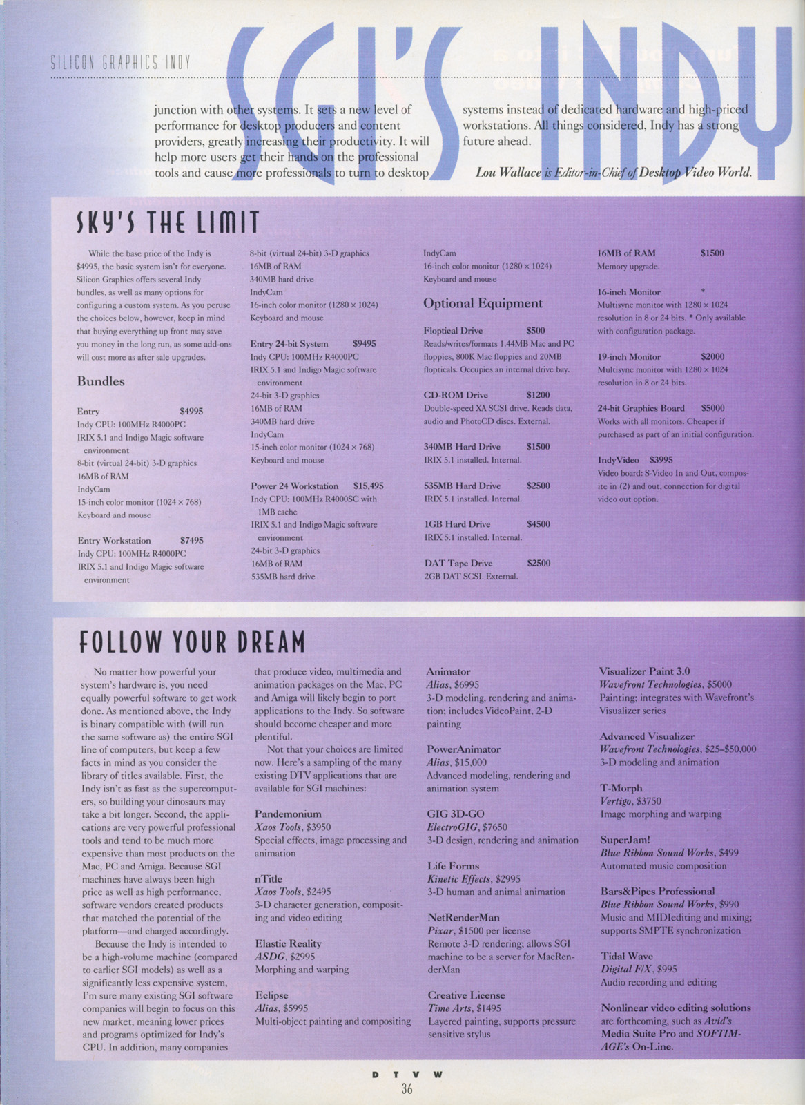

Scanned this out of the October/November '93 issue of Digital Video magazine - page shows some software pricing as well.

Confirm this is only the XL-8 and24 bit graphics, and not XZ graphics, as I thought XL was only for 2D graphics, on an R4000 Indy anyway?
I am aware that the XL-24 was the better card for the R5000 variant, due to the improved floating point arithmetic performance of the MIPS IV architecture.

So basically my Indy was a $10,000 machine.  Wowzers.

(07-05-2020, 11:39 AM)Irinikus Wrote:  Confirm this is only the XL-8 and24 bit graphics, and not XZ graphics, as I thought XL was only for 2D graphics, on an R4000 Indy anyway?
Yes, I think that XZ debuted a while after the Indy was introduced. And the XL-24 doesn't always come out ahead on R5000 systems - as Ian Mapleson discovered, the hardware z-buffer on the XZ gave it an edge in large viewports with complex geometry despite the R5K's superior floating point speed. I think some of the benchmarks on his site reflect this.
Lady Serena Kitty: Yep, that widely-touted $5,000 starting price was just marketing puffery. You didn't even get a CPU with secondary cache until the price hit the $15,000 mark, and that STILL only included 16MB of RAM, most of which would be consumed by IRIX 5, which was a bloated mess when it debuted (famously documented in a salty USENET post by an SGI engineer at the time). Upgrading to 32MB through SGI cost an additional $1,500, which was roughly triple the street price of the 72-pin parity SIMMs that you could buy at retail instead.

(07-08-2020, 02:05 AM)Silicon Classics Wrote:  Lady Serena Kitty: Yep, that widely-touted $5,000 starting price was just marketing puffery. You didn't even get a CPU with secondary cache until the price hit the $15,000 mark, and that STILL only included 16MB of RAM, most of which would be consumed by IRIX 5, which was a bloated mess when it debuted (famously documented in a salty USENET post by an SGI engineer at the time). Upgrading to 32MB through SGI cost an additional $1,500, which was roughly triple the street price of the 72-pin parity SIMMs that you could buy at retail instead.
Yea, I've got a 100MHz R4400SC, and XL-24. When I acquired this machine last year it had a 1GB disk and 64MB memory. Now it has a SCSI2SD board with a 16GB SD card (planning on moving to a 64GB card soonish) and 96MB memory.
