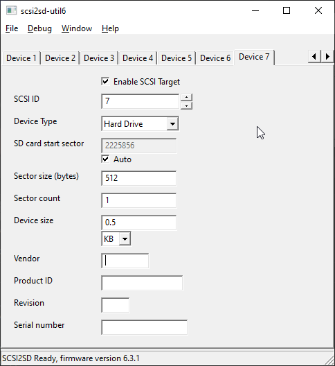

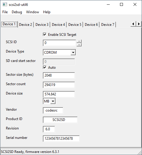

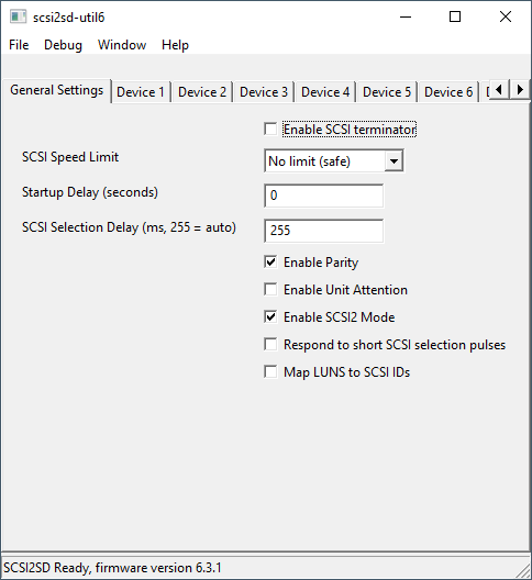

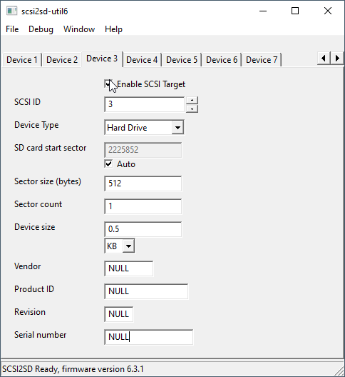

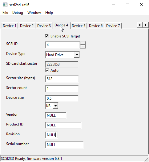

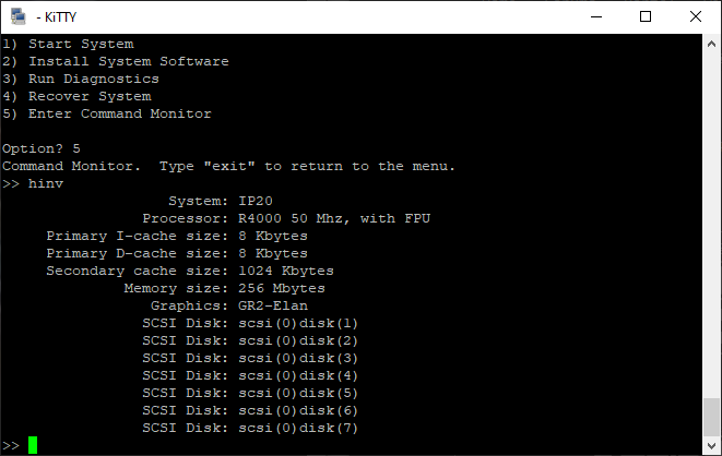

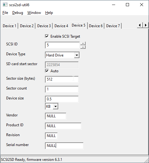

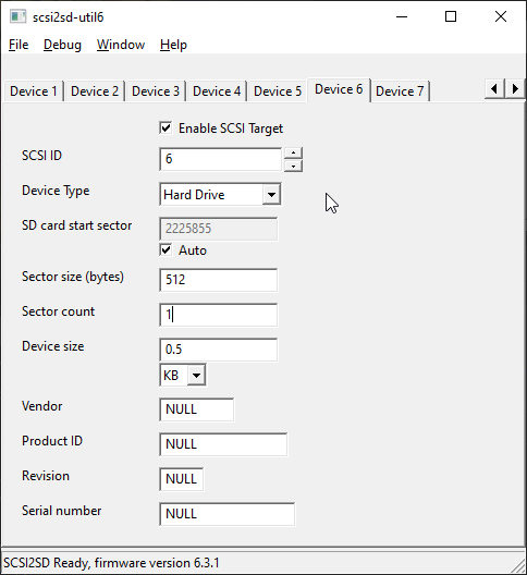

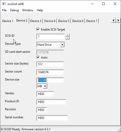

I need some help with Setting up a SCSI2SD Version 6 as it keeps showing this.
These are my settings for it.
RE: SCSI2SD V6 Help. - callahan - 06-27-2020
All SGI systems have the controller at SCSI ID 0. If you have another device at this ID (which your setup does), you will get many errors. Customarily the primary system disk is at ID 1 (although you can change the boot location environment variable) and a CDROM is at ID 4.
You can find my SCSI2SD settings on my GitHub, which have been tested on an Indy, Octane, Indigo2 and Iris Indigo. The most recent firmware, 6.3.1, seems to work fine.

RE: SCSI2SD V6 Help. - Mario9501 - 06-27-2020
Thank you for the configuration file. I figured out what was causing the multiple listing of the SCSI devices was because I left the USB plugged in and once I removed it it was fixed.
