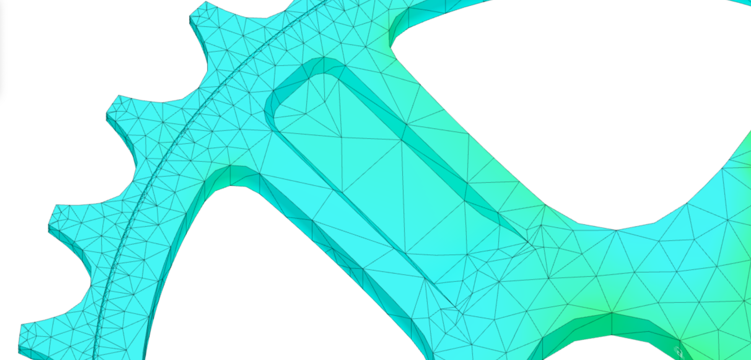

My o2 is in storage, and I don't know what Irix software can do this... (Autodesk Fusion)
Plan- at least convert model to Iv so I can play with it on o2, when I've found space and a flat panel for it.
