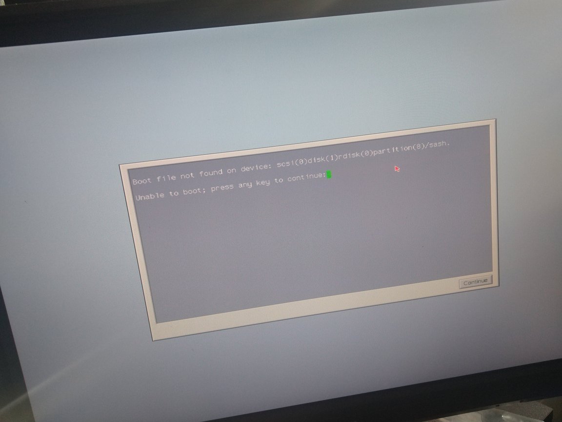

I am trying to get my Indy to boot successfully.
When it attempts to start, I get this error:
Afterwards it falls back to the main system menu.

Hardware wise, the machine is A-Okay. I suspect something might be amiss with the software installation.
So the main question being, is there a way to salvage this or is it time for a fresh IRIX install?

Is it the original hard drive? When I bought mine it had the same problem.
RE: Indy won't boot - kaigan - 05-09-2020
It looks to me like the hard drive may be having issues if this was a previously-working IRIX installation. Unless you have any data that needs recovery from the Indy, I'd try reinstalling IRIX. If that fails, it's probably time to find a replacement drive.

NB: it looks like the system of the O.P. has a wiped, corrupt or missing system disk. The result: PROM cannot load IRIX or standalone diagnostics. If you attach a CD-ROM drive with an IRIX OS installation disc, the PROM will look for diagnostics there as well, and load those if it can't load diagnostics from the system disc.
