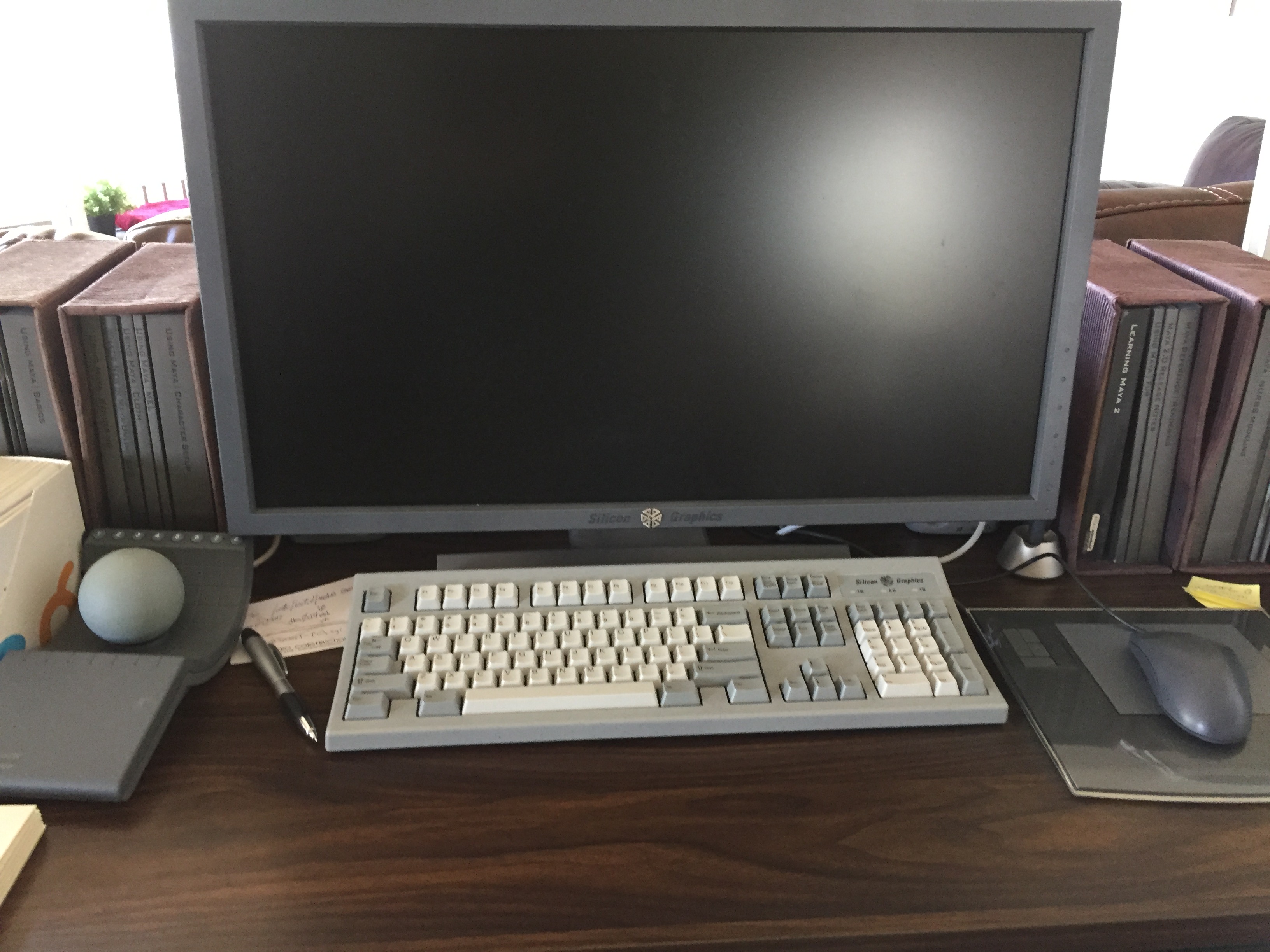

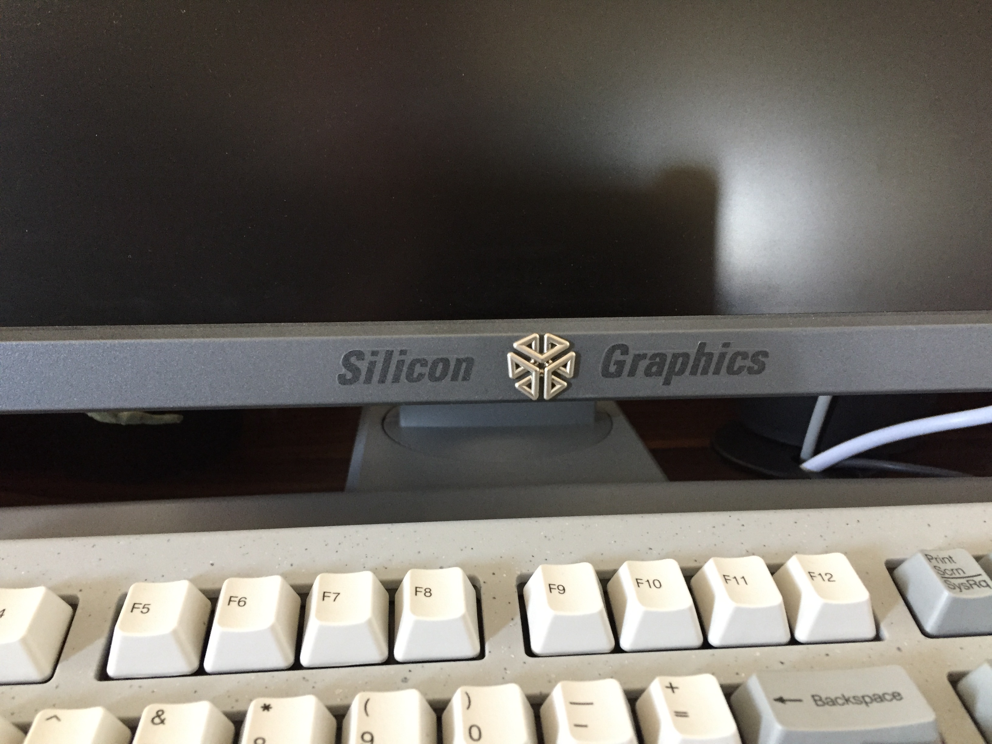

Re: Monitor fantasy - bjames - 08-13-2018
I took apart my brand new 27" BenQ Zowie FP monitor and removed the plastic skins and painted everything 'granit grey' which is not a stone paint, just a light grey (slightly) darker than the SGI Granite. I had the SGI cube logo from my old Indigo 2. The SIG cube logo on the I2 was in 2 parts. The silver Cube logo was attached to a back plastic backer. the Silver logo was held on to the backer by 8 or 10 pins that were push fit onto the backer. I used a razor to lift the silver cube logo from the backer. I used the plastic backer as a jig to drill the 8 or 10 (cant recall how many) holes into the front monitor bezel. I then printed my own 'Silicon Graphics" logo text using Testors clear waterslide decals and placed them on the bezel. I then used flat clear cover over the entire bezel to protect the decals and paint. Then I just pushed the silver cube logo into the holes (snapped in) and wholla!! I have a good homage SGI monitor. I will get some photos tonight. stay tuned.
I do have to say that my Wife thought I was crazy when I had the monitor taken apart 6 min after arriving home from the store. I took a risk and accepted that fact that if I screw up, I have no one to blame but myself.
Re: Monitor fantasy - bjames - 08-14-2018
Here are some pics as promised
