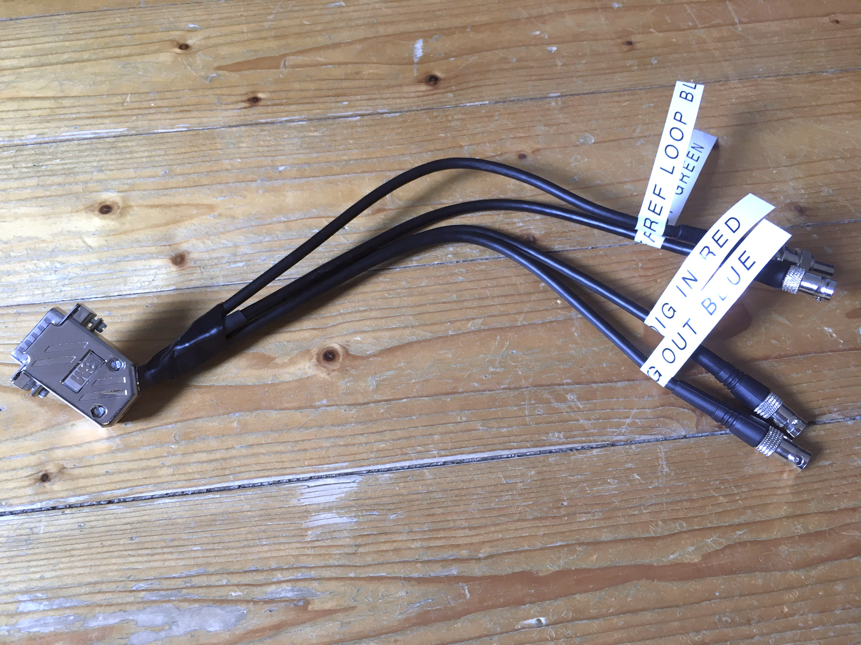

Does somebody own a "4-way BNC Breakout Cable for RAD Audio: 65 UKP (SGI PN 018-0648-001)" to check it via multimeter??
-- even Ian does not have it, and every distributor gives me a "not in stock" quote, because I would rather buy than solder but here we go again...
One would think compared to the "LVDS-cable hell", this would be easy, because of the good documentation. BUT there are a lof of grounds. Can I / do I have to connect these ground together? Like in the graphics below? The pinout is:

RE: SOLVED: 018-0648-001 breakout cable grounding pins - Geoman - 02-27-2020
I measured the pinout at the adaptor's side, and it shorts to chassis at 1,4,6,8,11,13,14 as stated above. So save to create this cable at your own.
RE: SOLVED: 018-0648-001 breakout cable grounding pins - jan-jaap - 02-27-2020
I'm sure the grounds are connected inside the digital video adapter. Probably some sort of star topology.
But I still wouldn't connect them externally, that creates ground loops. If the grounds could be connected in the cable there would have been only 1 ground pin in that D-sub connector.
Yes that's what I planned: to ignore chassis ground alltogether and only solder 4 pairs of signal and ground to get 4 cables:
1, COAXIAL DIGITAL_IN GND
2, COAXIAL DIGITAL_IN
3, VID_REF
4, VID_REF GND
5, VID_REF
6, VID_REF GND
9, COAXIAL DIGITAL_OUT
11, COAXIAL DIGITAL_OUT GND
RE: SOLVED: 018-0648-001 breakout cable grounding pins - Geoman - 03-01-2020
What an ordeal - 40 $ of material and 4h of my time, but now I've got all the Tezro-Cables I need.
2, COAXIAL DIGITAL_IN is shorted to PCI-ground-pin via 76 Ohms, all the GNDs are shorted to ground via 0 Ohms i.e. the outer isolation of the coax-cable. That's the internal organization of the PCI-card.
I only soldered 8 wires as stated above.
