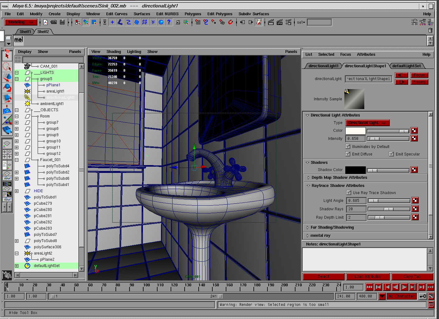

There is no Global Illumination or Final Gather.
The goal was to try and make it look like a modern linear workflow physically correct energy conserving (meaning lights and materials) shader render.
So this uses no GI or Final Gather. Only a carefully balanced ambient light. You can also use the directional light to create sunlight looking shadows that start super sharp and then fall off gradually by using the light angle. I think 0.45 is correct but I ramped it up to 0.65 to make sure it came across a little bit more.

Once you understand quad (four sided) polygon flow you can get to most shapes pretty quick. You start with very basic shapes and primitives and cut and shape them into the more complex shapes. Like the inner sink basin was a sphere that I cut in half then edge extruded a couple times out from the upper lip edges to create the top surface. Then moving the second row of polygons upwards in the back vs the front to create that back ridge that keeps the water from rolling off. Then extruded downwards from that entire edge set to create the outside of the basin and scaled the bottom inwards to match the roundness. Finally when I have that basic very blocky shape I convert it to a subdivision and it is able to smooth out and be round.
I will likely do a tutorial on how to assemble a scene like this. Showing the older school methods.
Today we have GPU render engines like Redshift that I use a lot and it makes viewing the render near realtime so you can adjust and not have to wait for renders by getting pretty good feedback right away. This kind of scene is tricky on old equipment because you have to have some insight on how you are expecting it to turn out and make small choices one at a time and test them out with low render settings otherwise your iterations will take hours to adjust lights and reflections.
I was actually surprised how well I could adapt the old tools to match a more modern workflow. Still need to find an edgeloop tool for Maya 6.5, using the older cut is much slower.
