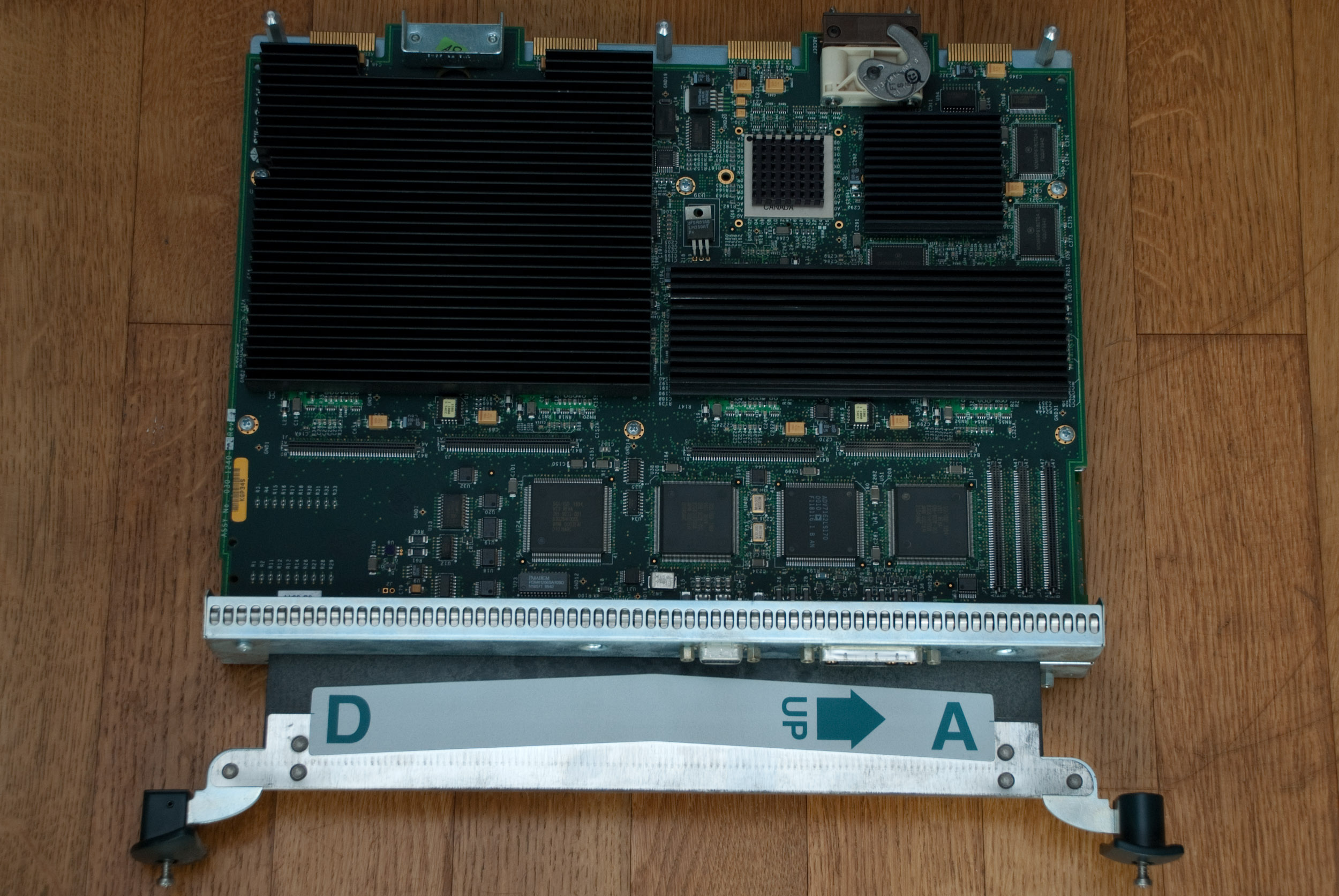

(For what it's worth, look at the photo of an SSE board at http://archive.irixnet.org/sgistuff/hardware/systems/images/octane-sse-1802.jpg.  On the right hand side of the board, near the bottom of the photo, just above the I/O shield, and right of the four square black chips, you will see three very fine-pitch connectors neatly lined up in a row.  Those are for the ribbon cables to the PVO board.)
