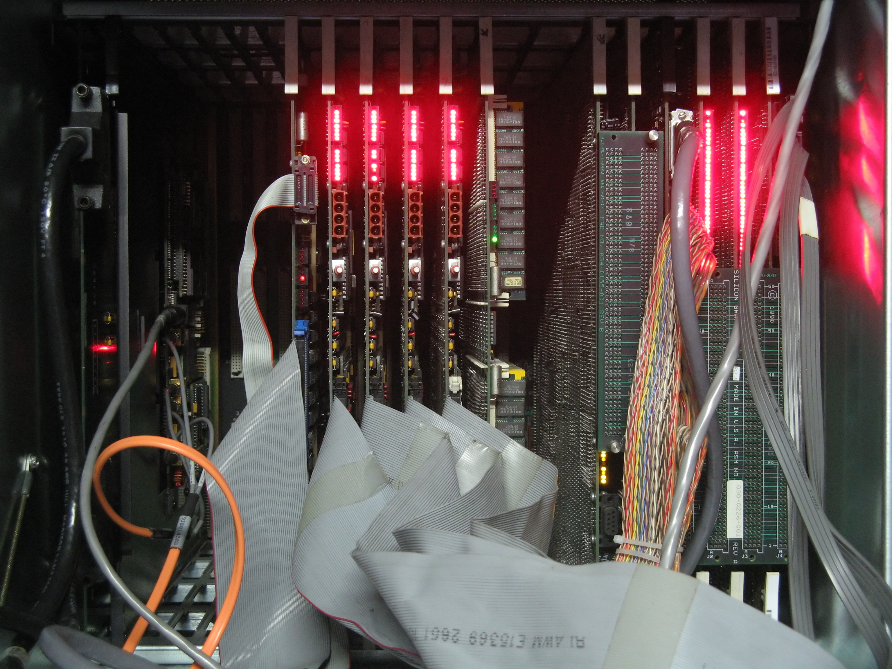

dstep, could you post the on/off configuration of your RM lights? A picture would work perfectly too. I’m back to troubleshooting my VGXT board set and I’m convinced the boards are most likely working correctly but want to be sure. Thanks!

Here's a blinkenlights party photo of my 4D/380 VGX. I don't think the LEDs on a VGXT are any different. IIRC the top LED on the RM's is lit, the 2nd off, the 3rd blinking and the rest lit. Something tells me that most of the LEDs reflect the status of Image Engines -- there are 20 on each RM I believe.
Unfortunately I can't start the monster right now because I'm redoing the wiring to the 19" rack sitting right next to it. The place is a mess and the 4D/380 is disconnected.
If the system is running either IRIX 5.3 or 6.2 I have diagnostics for the big iron graphics. That might help, assuming the pipe is detected and doesn't crash the system at boot.

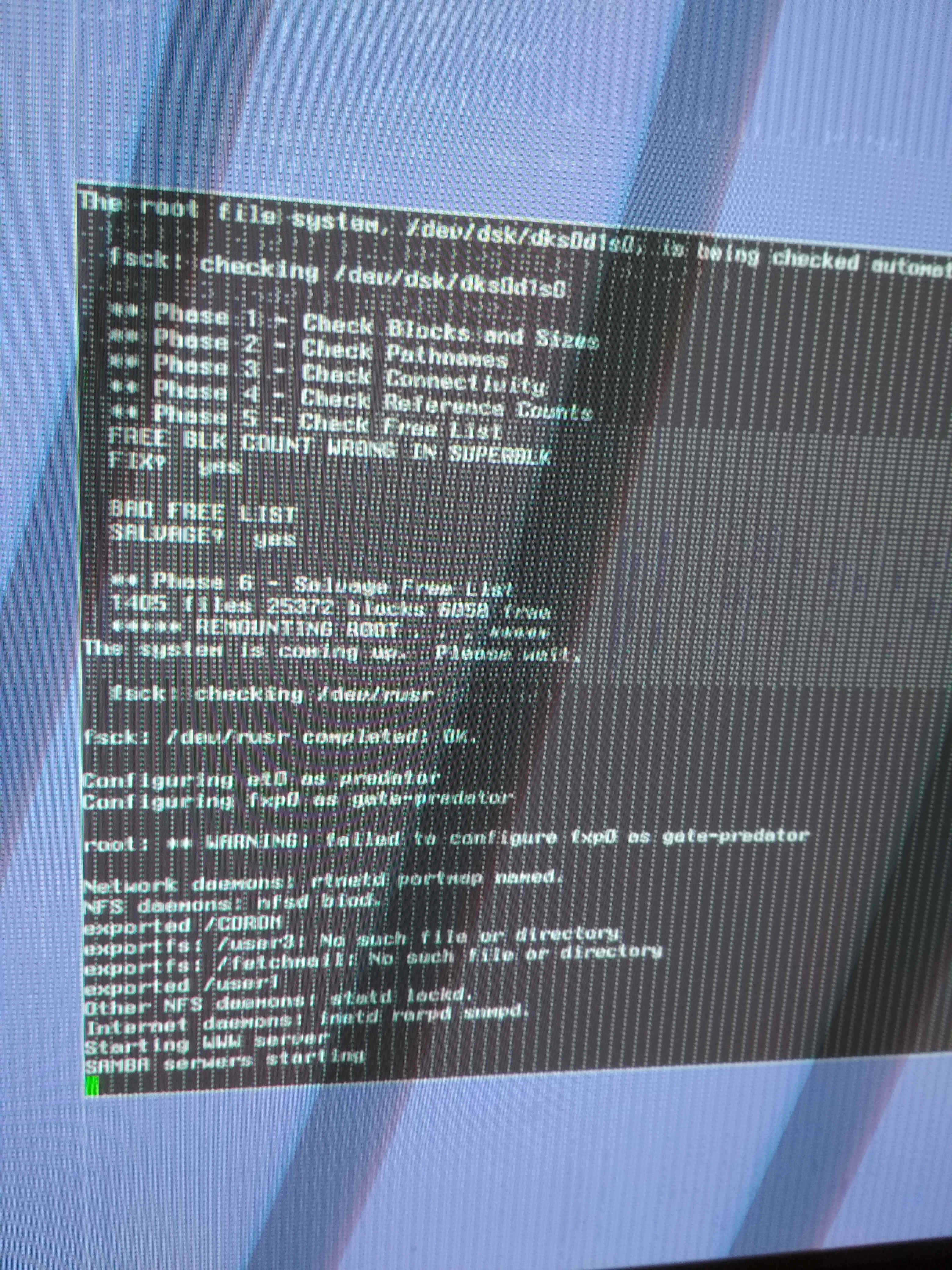

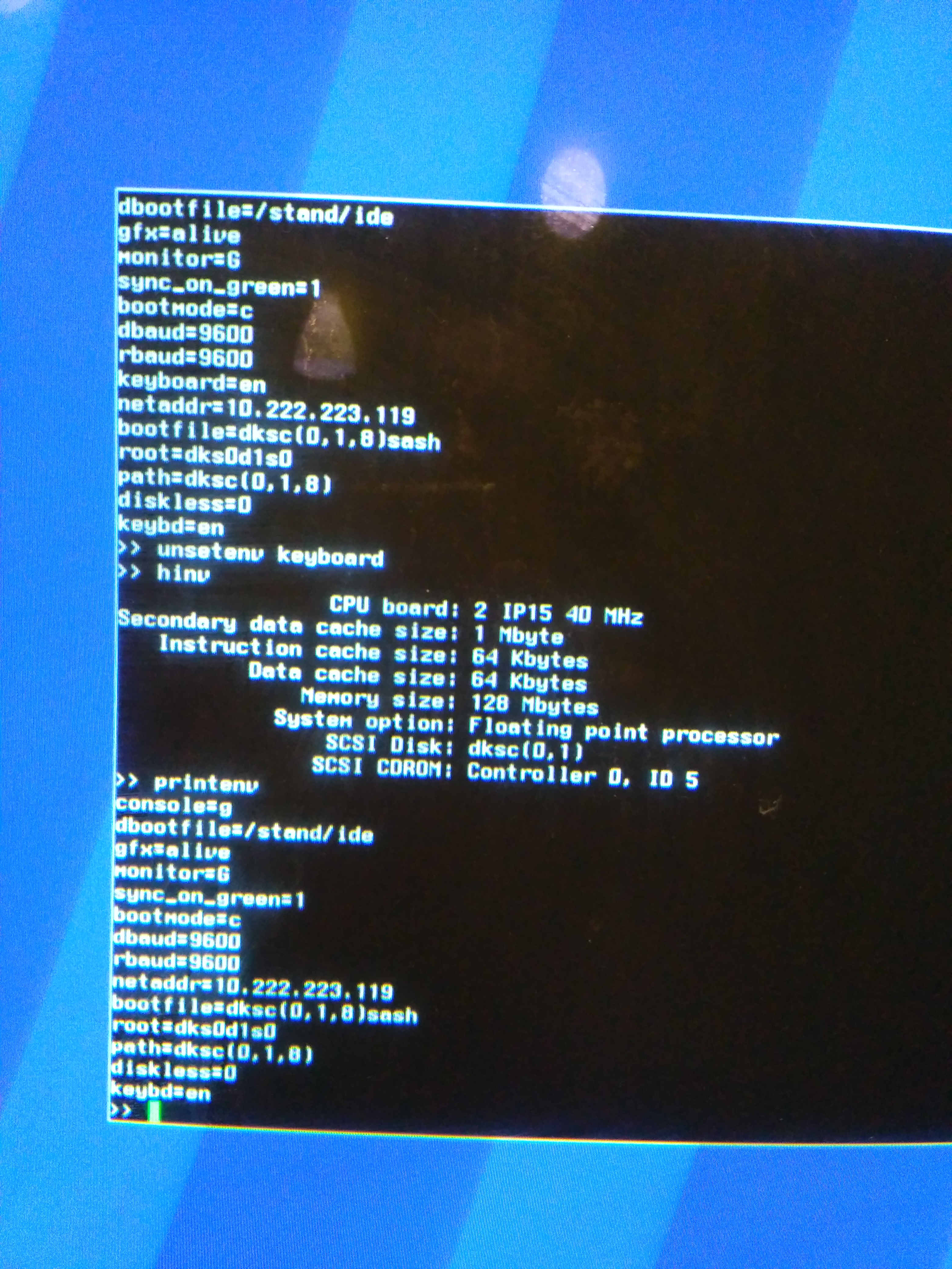

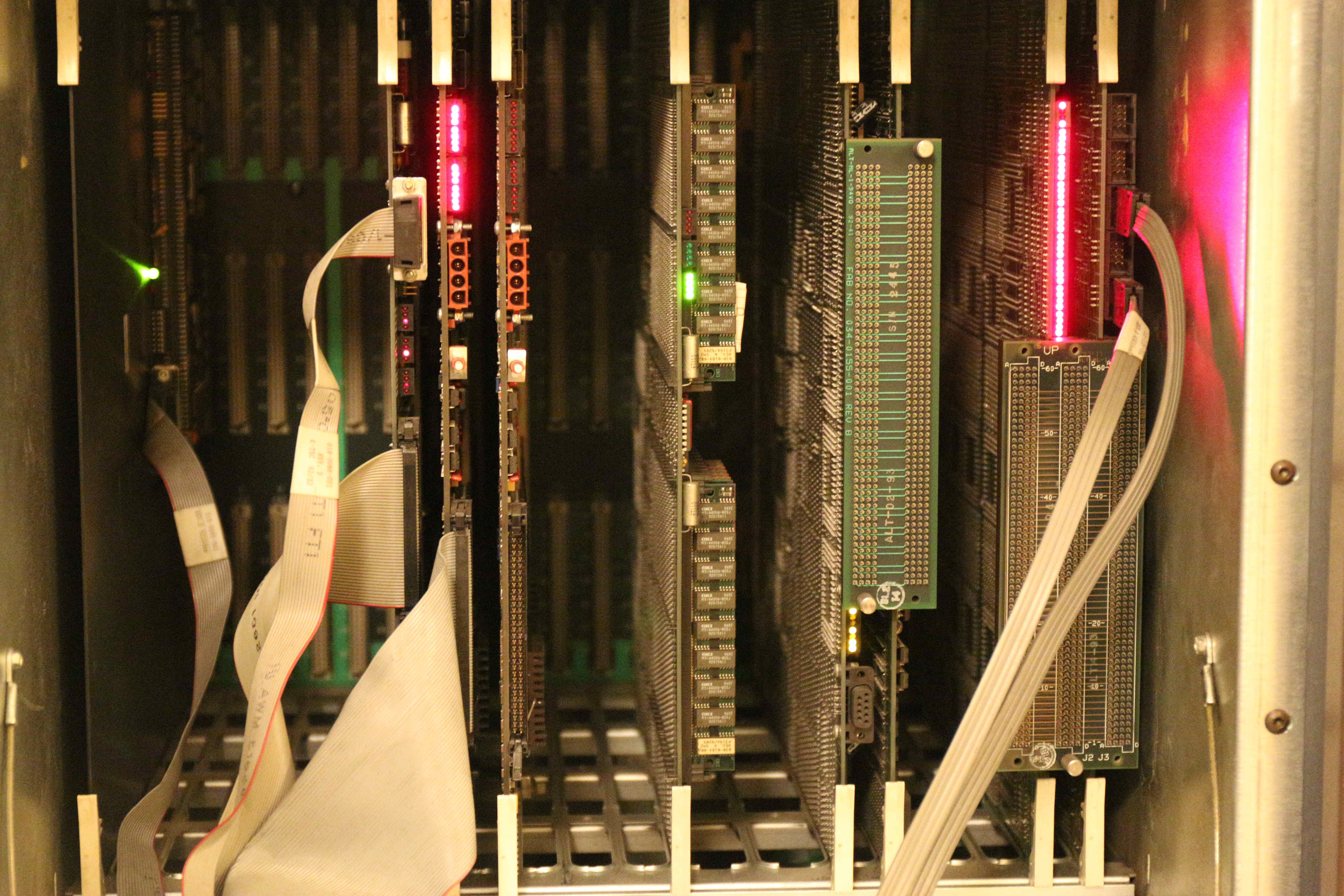

Hello
I have made some pictures and video of mine system with VGXT (one CPU board id disconnected). Also I have trouble with VGXT it displays only at boot stage. VGXT says - checksum error. I will start a new thread for it.
PS I tried to add a video but unsuccessfully. I can send the video to you some other way, if you interested.
By the way I "fixed" all the system which did not start at all by pushing every IC in its bed to improve electrical connection (be carefull, I used big antistatic mat). Also this method helped me to remove "garbage" on display.
