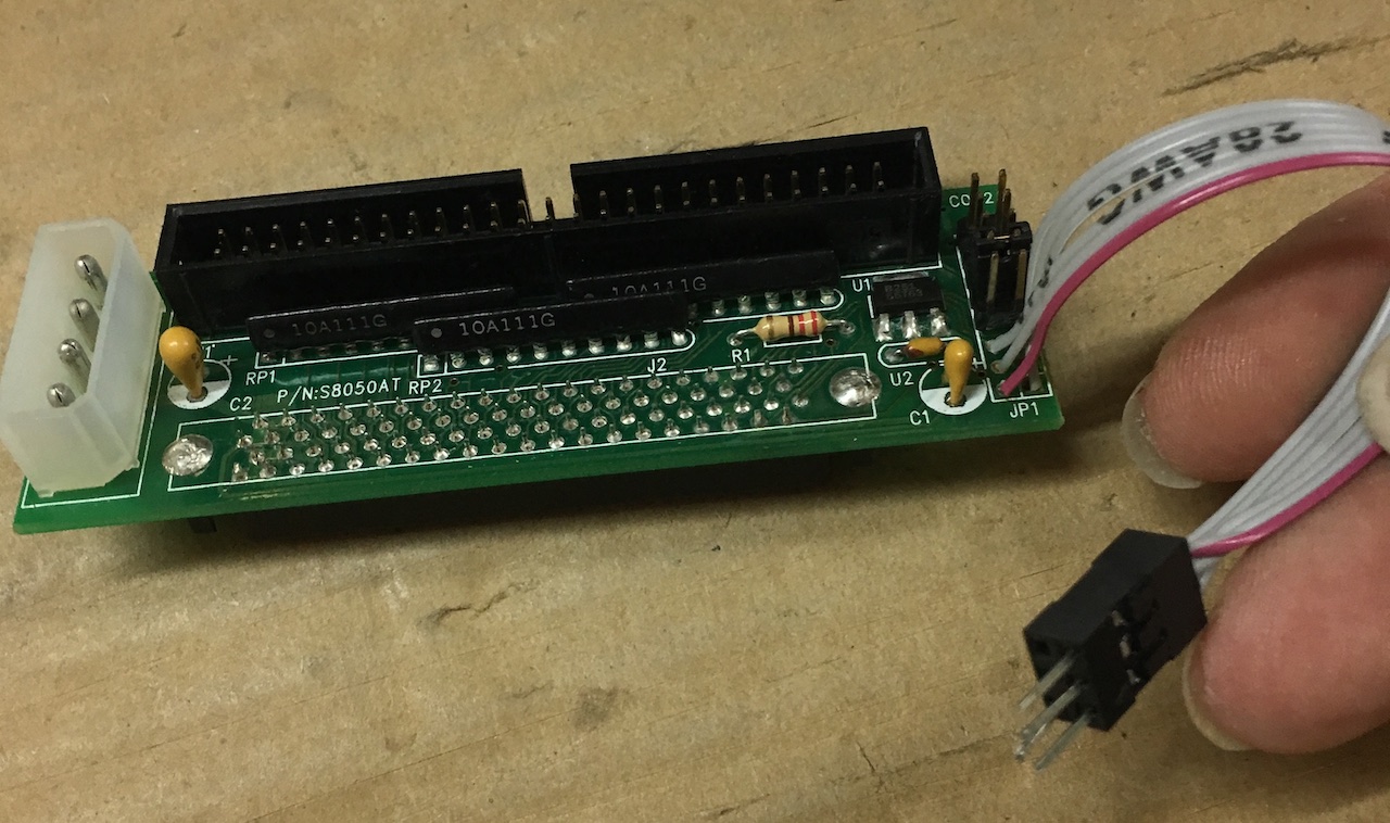

Most hard drives (that use micro-jumpers) use a Dupont 2.0mm connector, so you’ll have to create a simple (but tiny) adapter cable if you want to cable directly to a drive. You can also get a premade male 3.5mm connector and solder the wire ends to a SCA bridge adapter jumper area to automate the SCSI IDs on a SCA adapter used on the Sled (done this twice now, see pictures).

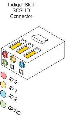

I’ve attached a VISIO orthographic drawing of the sled connector and the pin assignments. Please note, that the lower (bottom three) holes only have one wire and only that hole (with bottom single wire) has a ground connection. That’s the ground in the ID system, the other pins are the ID bits. Most of the time, this connection will seem backwards in natural assignment.

Let me be clear, POLARITY matters! While it shouldn’t damage a drive, the wrong polarity will give weird ID assignments (not what’s expected). The pins for the three ID bits (columns) each have a ground, all grounds are usually tied together. So just check continuity between neighboring pins within the ID group of the drive’s ID setting connector. You find that likely all the ground pins on the ID connector are electrically connected…that shows you which side is to be connected to the sled ID connector ground. Also…since they are all connected together…connecting the ground line to ANY ONE of the these ground pins will work for ANY ID pin(s). So you don’t often need to connect all ID pins to their associated grounds. If you find all grounds have continuity with each other, then any single ID ground will work with ANY combination of ID pins.

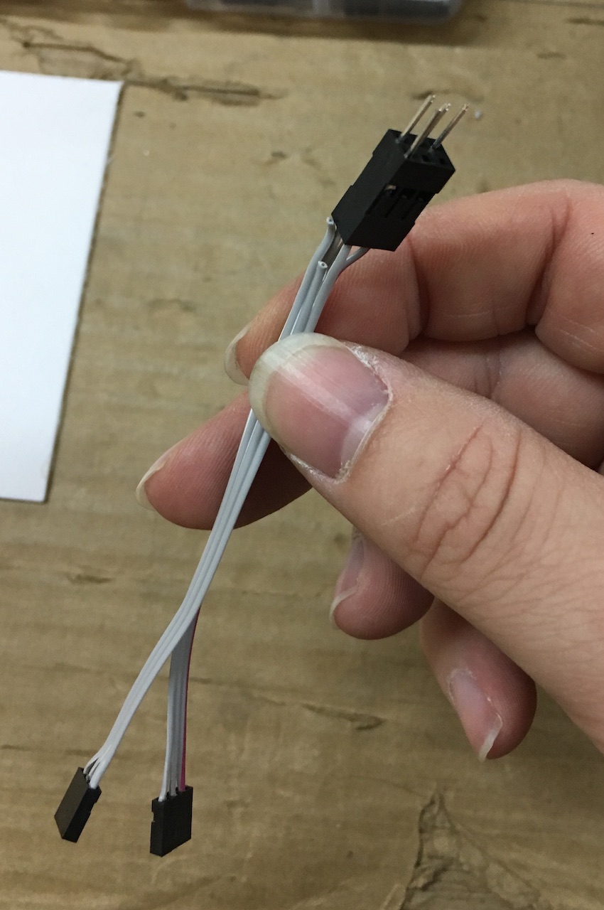

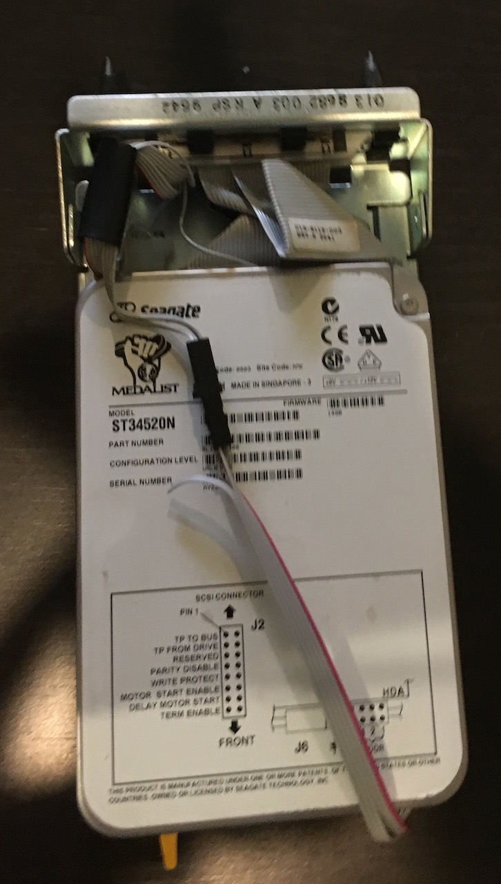

For Hard drives, you’ll almost never be able to use the 3.5mm sled connector to attach to the drive (though I have found some SCA bridges use them instead of micro jumpers). For this I got a small section of “zippable” ribbon cable and crimped and made up 3.5mm male connectors to 2.0mm female connectors (drive side). One-to-one is all you need. I split them up into two connectors because you’ll never know the ID bits polarity of a drive (they do change with each drive!).
Place the ID pins on their own 3x1 DuPont connector, place the ground on a single pin connector or whatever you can get. Then you can rotate the ID connector 180 degrees for drives headers that go ID2, ID1, ID0 instead of ID0, ID1, ID2. Either way you’re covered.

With later stations using SCA connectors, this was all built-in to the chassis, for older systems it was a connector on the sled. Since many people are getting SCA drives as upgrades for their SGIs, I suggest doing this modification on a SCA adapter bridge (as the parts are easier to get and it’s a cleaner look).
