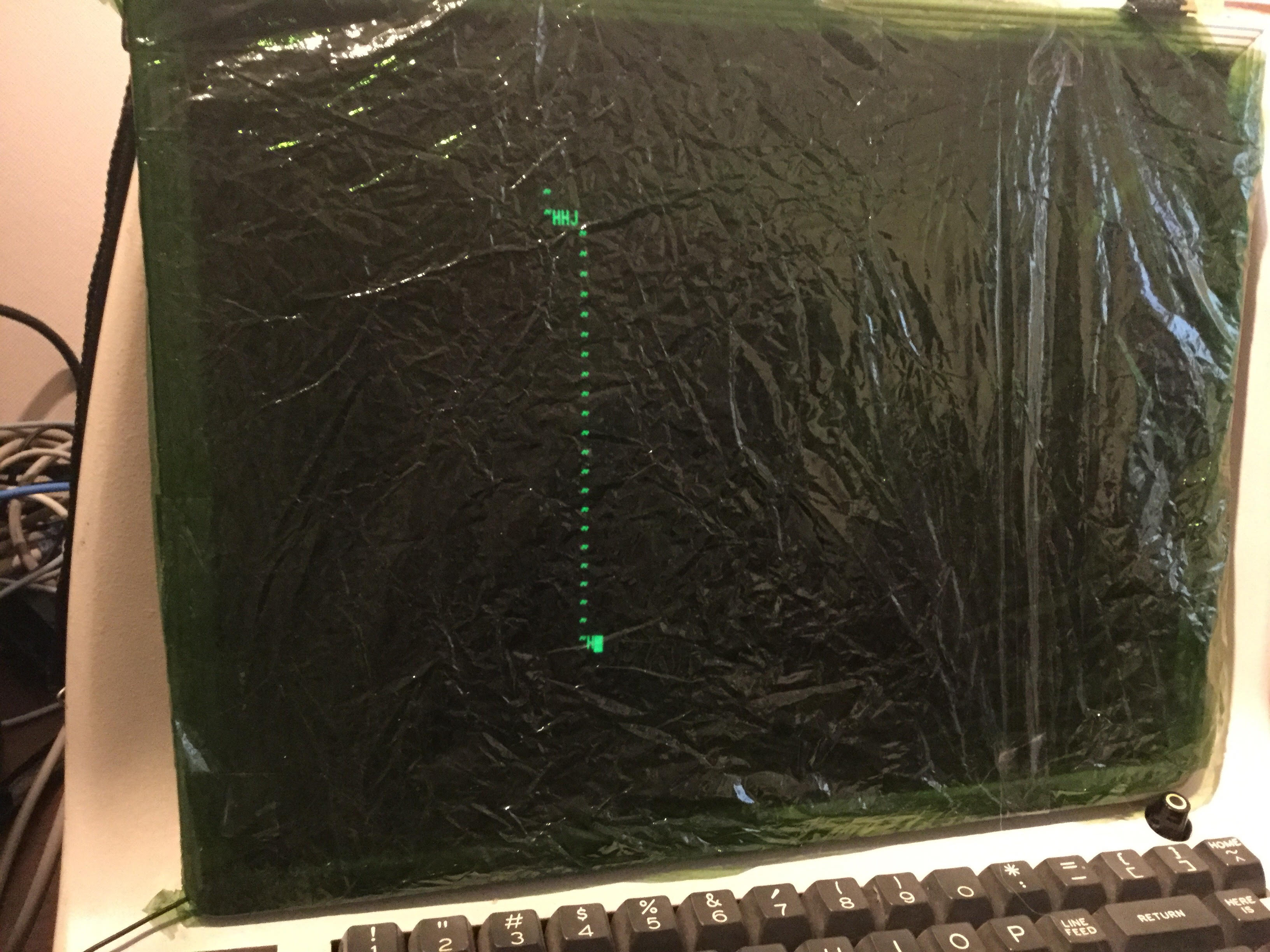

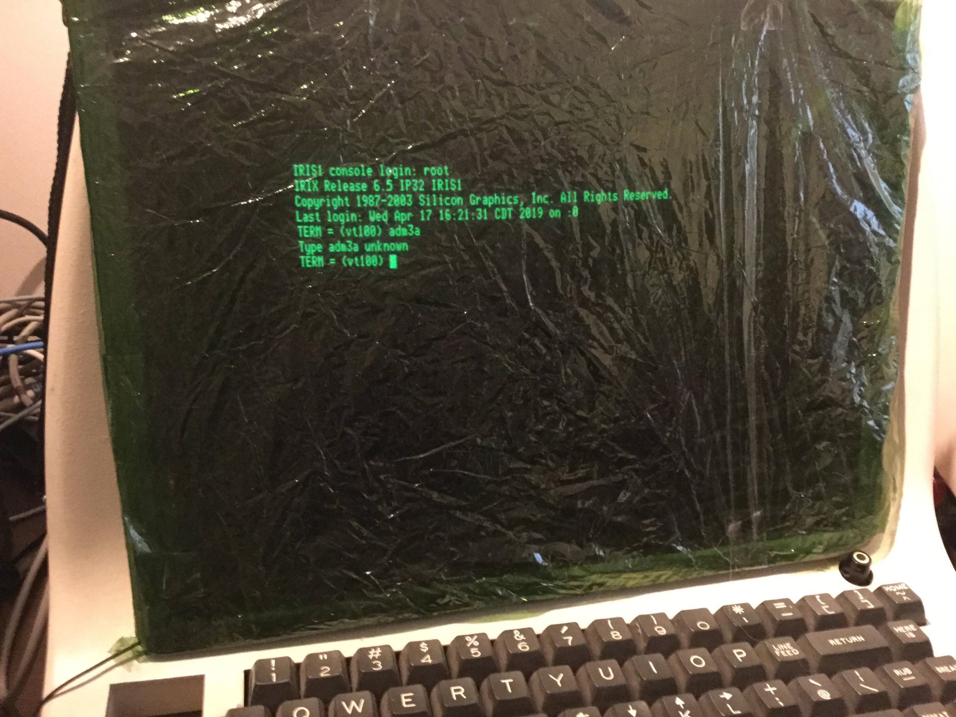

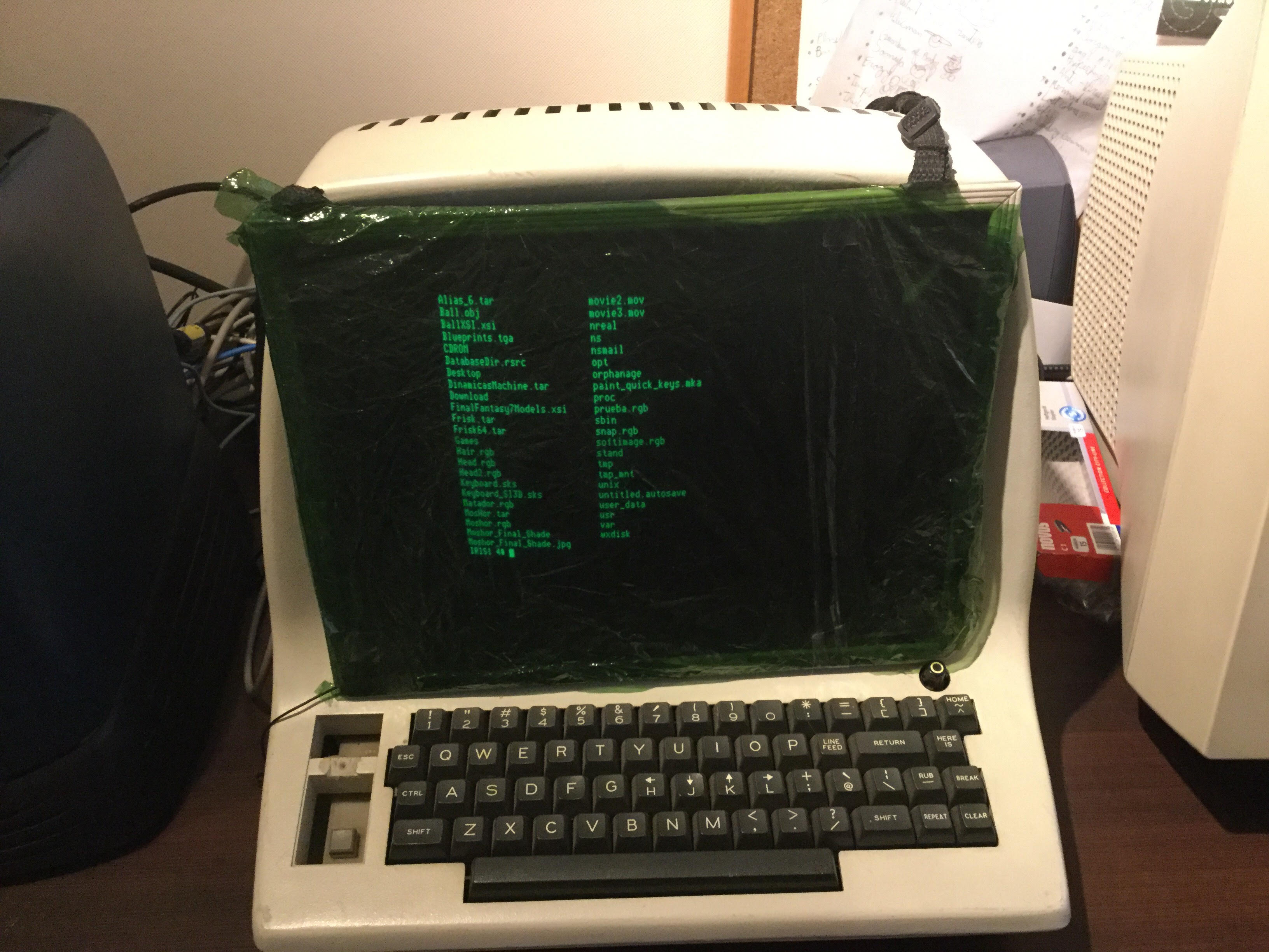

Hi, Yesterday I connected my dumb ADM3A terminal to my SGI O2 to test if it worked and I manage to work, but when I tried to use the vim text editor my ADM3A screen was deconfigured, try to configure it with "setenv TERM adm3a" but when Vim opened a message came out of
"type adm3a unknown".
I do not know what to do, can someone tell me what I should do for my ADM3A be compatible with Vim on IRIX 6.5.

Does your IRIX intallation have an entry for the adm3a under /usr/lib/terminfo/a?  If not, then you probably don't have the full terminfo database installed and you'll need to do so.  It's in eoe.sw.terminfo (on your IRIX installation media) if you need it.
