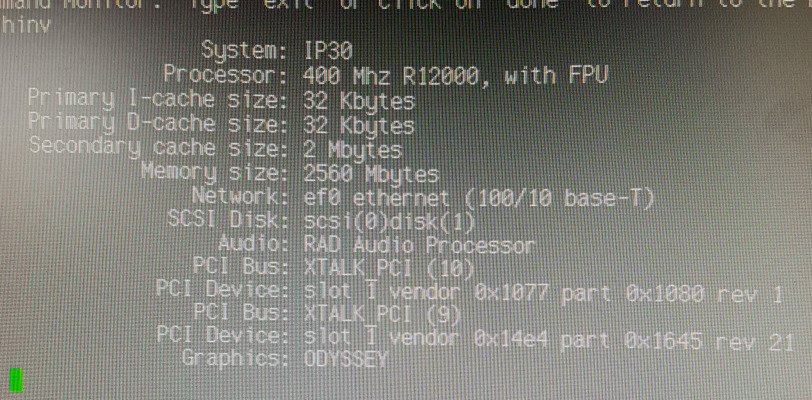

Henlo!
I want to upgrade my Octane2 with a gigabit ethernet card (got a shoehorn adapter) and just naively plugged a 3com 3C966B-T card in there, because I've read somewhere that they are somewhat comapible. Then I installed the hacked driver from futuretech.blinkenlights.nl/depot, but I can not see the card anywhere in IRIX.
Maybe I need another card with fitting drivers, but I only have very little money. Are those listed network cards in the "Octane Hardware Aggregator" the only ones?

These 3Com cards were sold by several sellers and they changed the ID Code of them so you have to match the vendor string of the hacked driver.
I prefered the flash hack (I modded an 3Com card and an IBM double port one).
Unfortunately I only found instructions for the double port, but I think is a very similar way to do:
https://web.archive.org/web/20160319072529/http://forums.nekochan.net/viewtopic.php?f=3&t=16718780&p=7295721

So I have to put the 3com 3c996B-T card in a PC and change an ID with ethtool, so IRIX thinks it is a SGI P/N 9210289 card. But which ID and to what number? How I puzzle the ethtool command together?

That recipe patches the PCI SVID:SDID but doesn't change a couple of other things. It works in IRIX (though I think the TG3 info utility can spot the difference), but fails the Broadcom diagnostics and there was something else (I forgot).
I have a different method, using Broadcom software and EEPROM data from genuine SGI cards. The result is a 100% valid clone (minus the MAC address which can be anything you want). I did a run of cards a couple of years ago for the Nekochan crowd. Never had any complaints. I can do other personalities too, like IBM p/n IBM-73P4219 or HP A6825-60101 which is maybe interesting for HP-UX fans.
