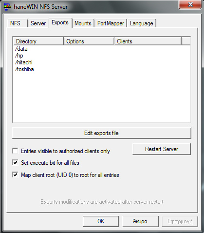

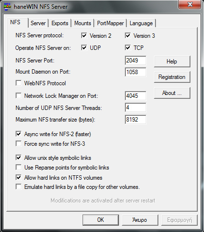

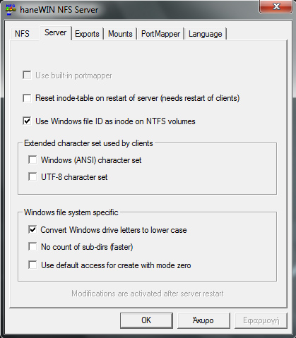

RE: NFS between IRIX and Windows - fast-turtle - 04-03-2019
Of course I can!
I do not remember the defaults for haneWin, so I attached my current configuration below.
I use haneWin 1.2.35 registered on Windows 7 64bit.
I am using IRIX 6.5.30 on tezro on the client side and can mount as read-only and read/write.
I suspect a problem with your firewall (Windows or 3rd party). Can you temporarily disable it?
