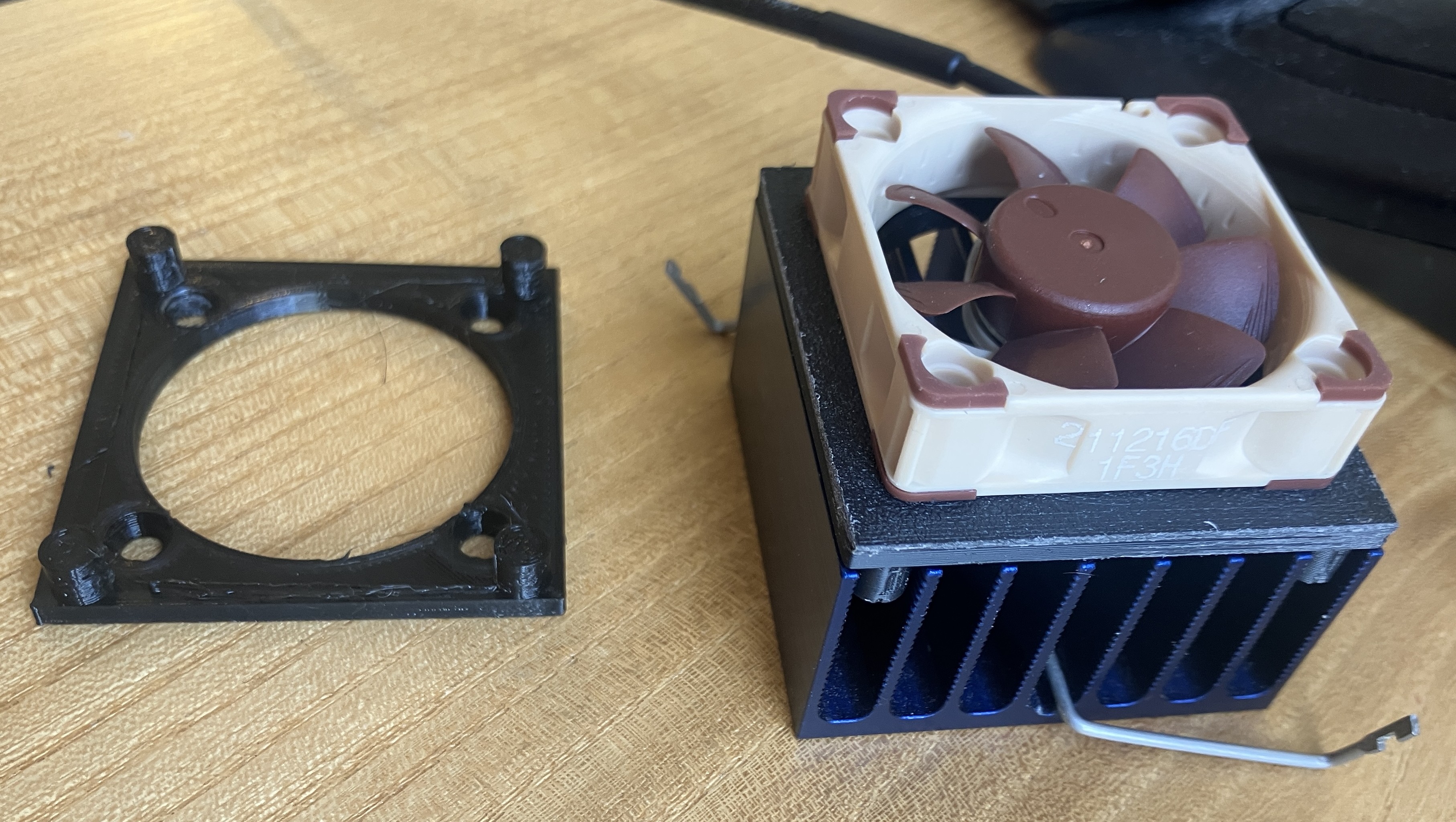

I also ended up throwing a fan on the CPU heatsink. Is it necessary - probably not. Do I feel better? Yes.

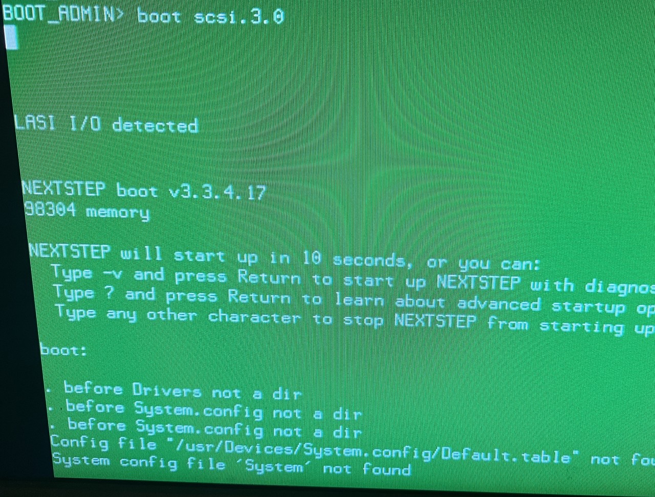

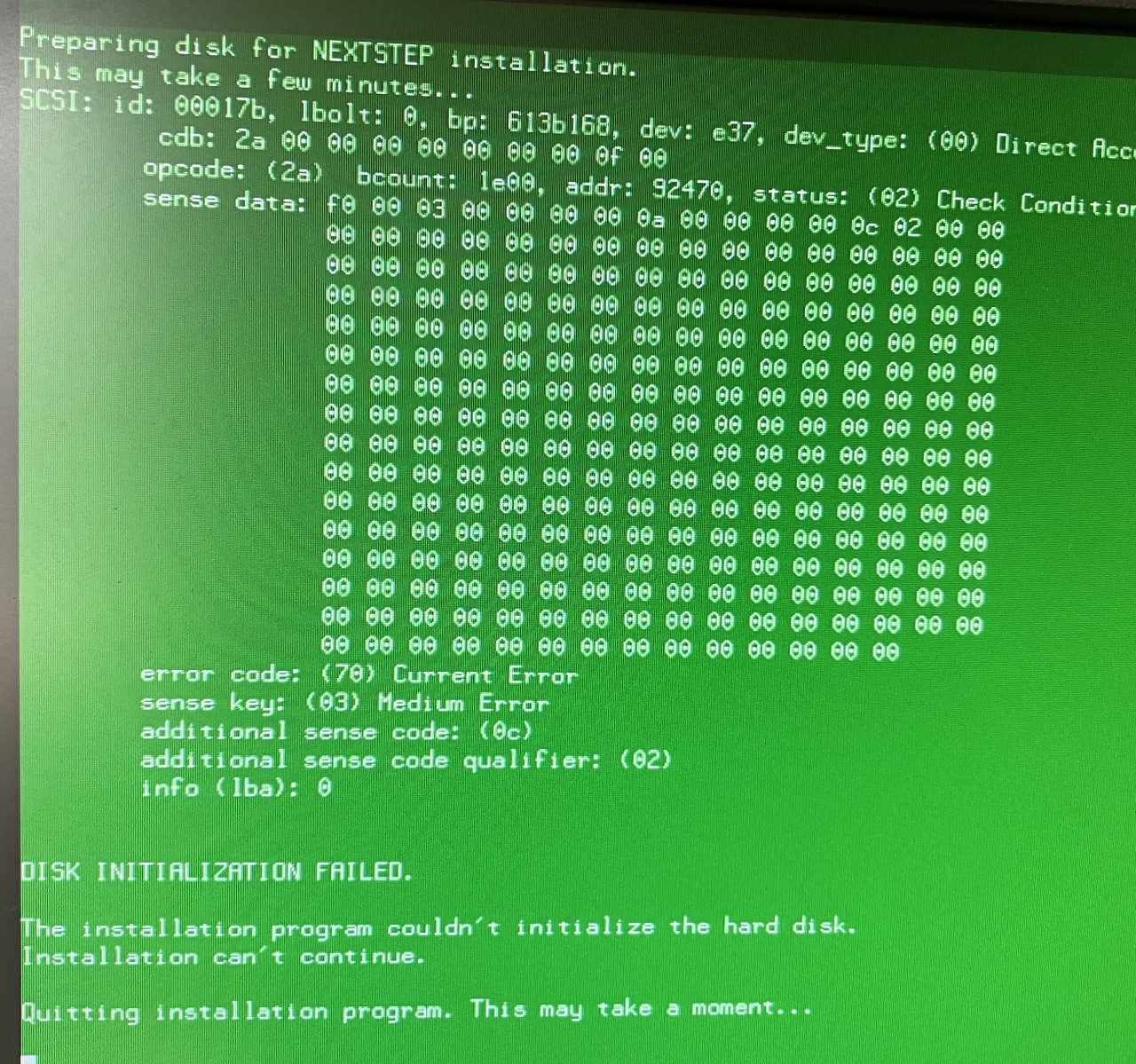

legodude - 10-03-2023
I've progressed to the point where, depending on my ZuluSCSI settings, I can get it to crash at various points in the install. To me, that suggests larger problems than just the disk geometry. I have been trying Sophie's recommended sectors/heads without success so far. Which ZuluSCSI do you have? I have the newest red RP2040-based model (2023a), and I wonder if trying an earlier blue model might be helpful if the BlueSCSI doesn't work.
Only difference between these three crashes is slightly different settings. For example, changing the install media drive type from "CD" to "removable" caused the installer to no longer crash early in the process.

Fan mount with a 40x10mm Noctua fan:
I also need to 3d print a way to remount my floppy case insert (all of the tabs are broken).

RE: HP 712 NeXTSTEP/HPUX SD Images -
robespierre - 10-03-2023
Does it ever occur to anyone that those error codes have defined meanings?!
ASC 0C, ASCQ 02 means "Write Error--Auto Reallocation Failed".
This means that when trying to write the block, there was a defect on the medium and the device server was unable to allocate a spare block.
