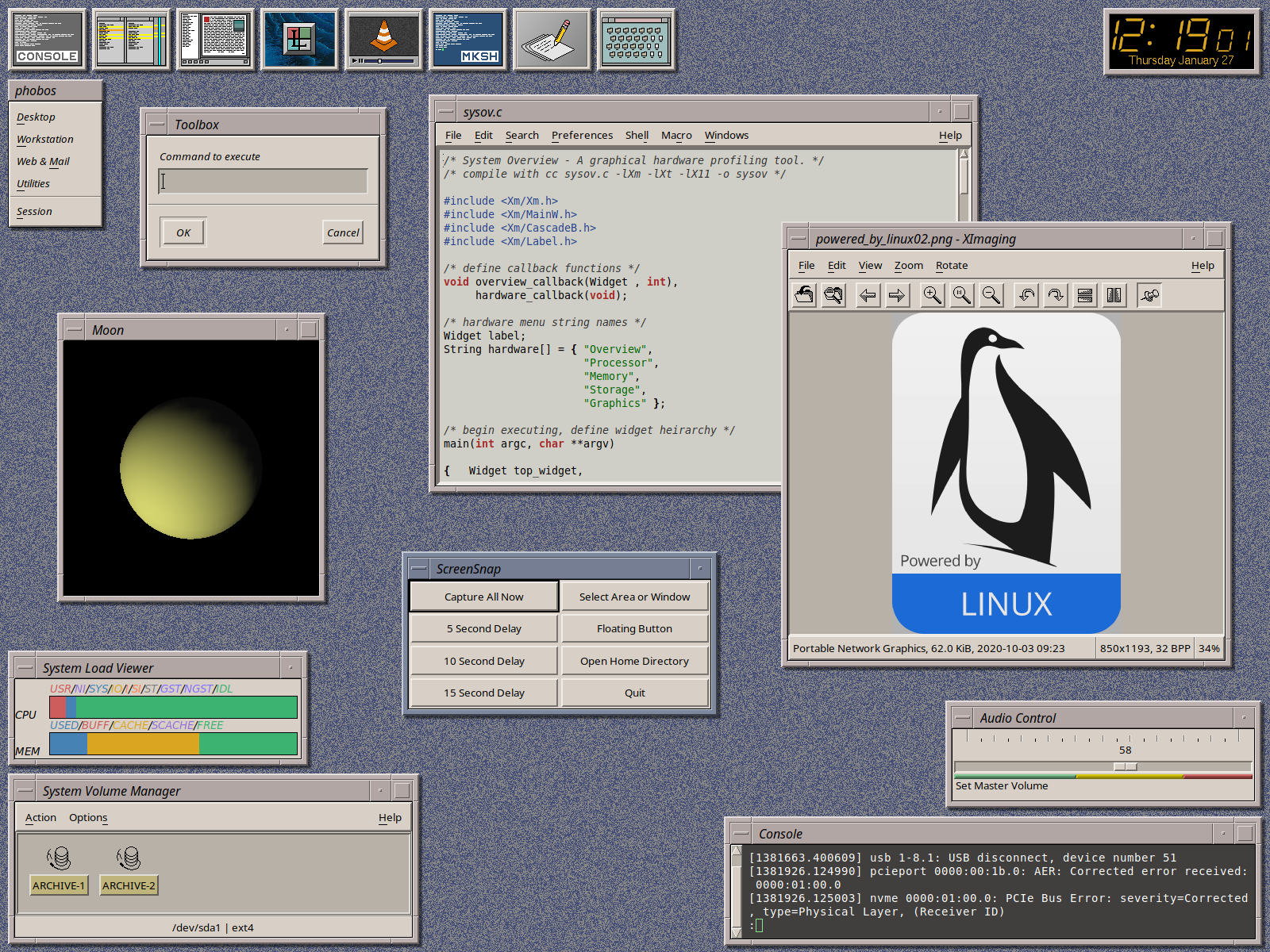

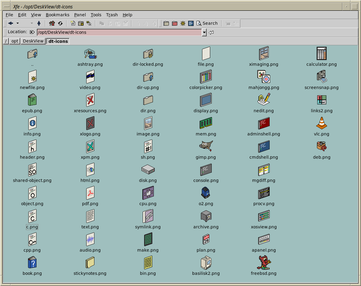

New icons, color schemes and apps are in the works. I'm attaching a couple previews Smile

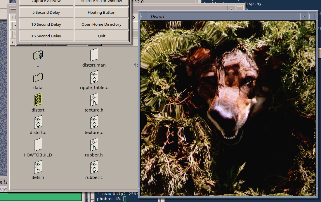

I found an OpenGL port of the distort demo. I cleaned up the source for the UI a tiny bit and made a build script. Builds perfectly under Debian Smile
shrek
Posts: 233
Threads: 19
Location: United States
02-16-2022, 12:29 AM
(02-16-2022, 12:29 AM)shrek Wrote:  I found an OpenGL port of the distort demo. I cleaned up the source for the UI a tiny bit and made a build script. Builds perfectly under Debian Smile
Wasn't the original distort OpenGL?

(02-16-2022, 09:19 AM)Shiunbird Wrote:  Wasn't the original distort OpenGL?
It might have been IRIS GL (ancestor of OpenGL) instead.

This project looks great, I'd love to run this on my Pinebook Pro as a lightweight desktop. Is this specifically aimed at debian development for the foreseeable future or will it be relatively distro independent with the correct dependencies? I ran debian with mate (what I'm used to) on my PBP for a few months after I got it but it crashed and I just switched back to the more supported Manjaro.
DS10L 617Mhz/1.5GB/Radeon 7000/250GB+120GB HDD
DEC 3000/400 133Mhz/64MB/146GBx2 HDD
68008/32KB SBC
bifo
Posts: 2
03-06-2022, 11:03 PM
My understanding of his version of things is that while it's primarily designed for Debian there's nothing that prevents you or me from using it on whatever we please.
Just make sure that you have proper paths set up and are prepared to play with it. As I'm working with midnightbsd slowly on a more polish version which is going to have some differences, that might be more of a system ready version
